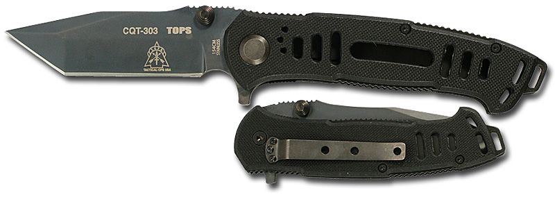

Hey I just saw the Endura you did. You wouldn't happen to have one of those on hand would ya? They're the same pattern I believe.
Believe me I thought about that. If I had known while I had it maybe but I suspect that although the clip may be the same the height from the top of the Endura to the clip is different than it is on your knife so even if I did have it the E4 doesn't really show me what I would need to know to make the fold over in the right spot for a clip on the D4.

I can mount a low rider in that same spot of the clip on it now using two of the three existing holes.
