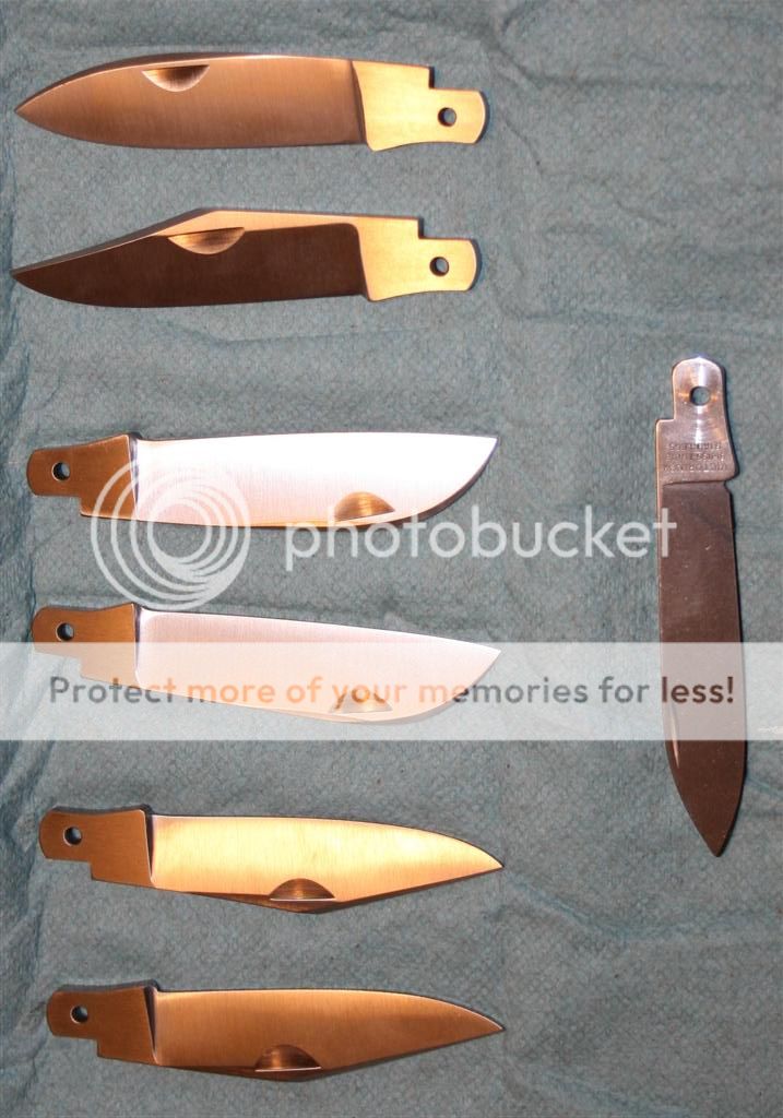

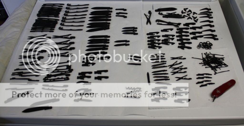

Yep I got a guy who can do the hot caustic BO on stainless. Not something you should DIY at home, so I pay a pro to do this in a lab for me. I still do small runs of BO but it costs more per part than say getting the hard anodize done. I love how black tools look with the orange or white cerakote scales though! :D
Here's parts from the last big batch I did.

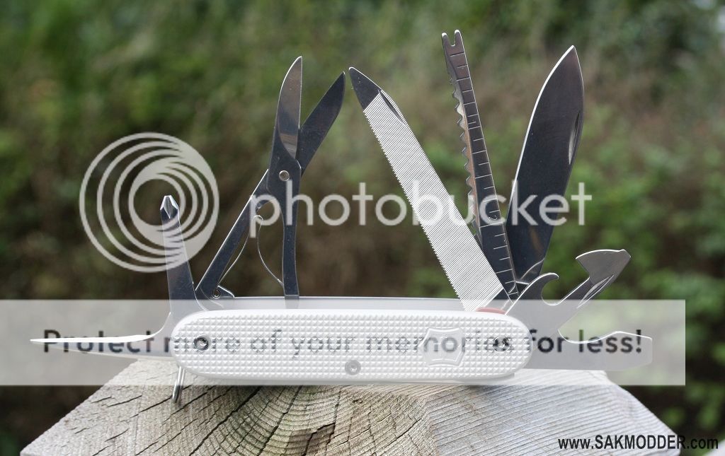

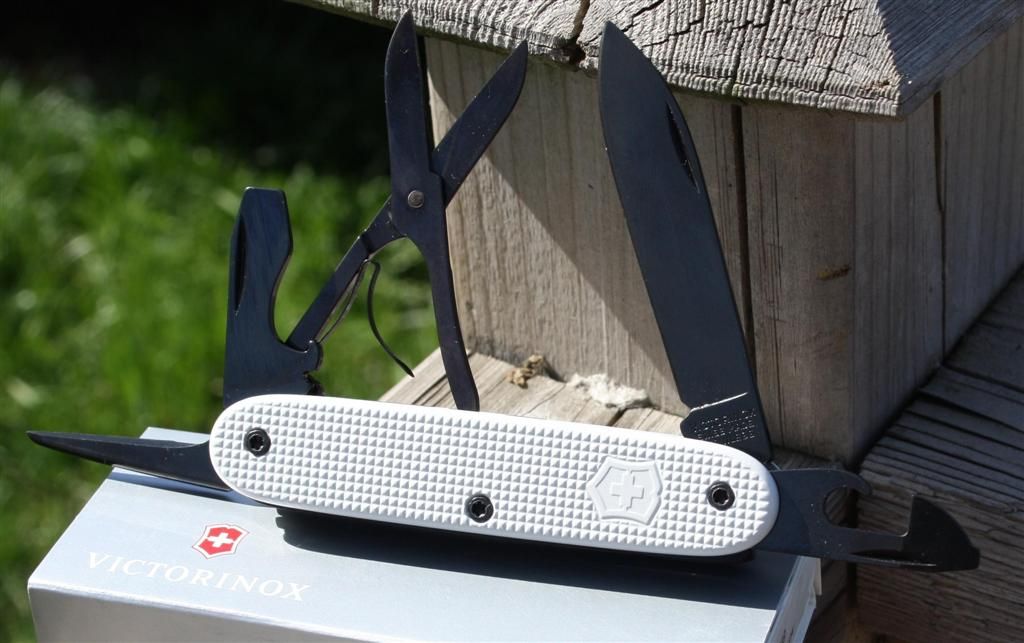

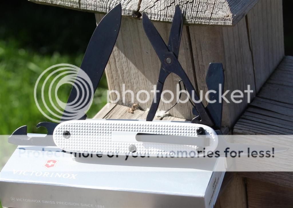

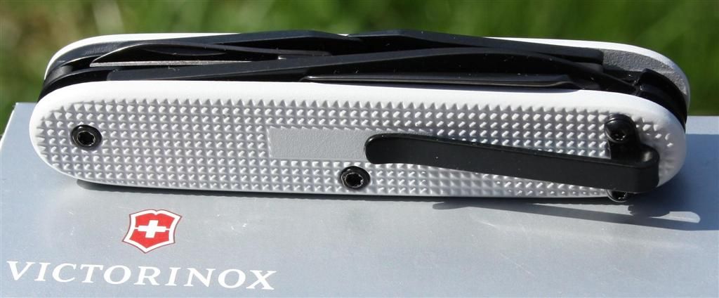

Here is a white scaled with black tools one.

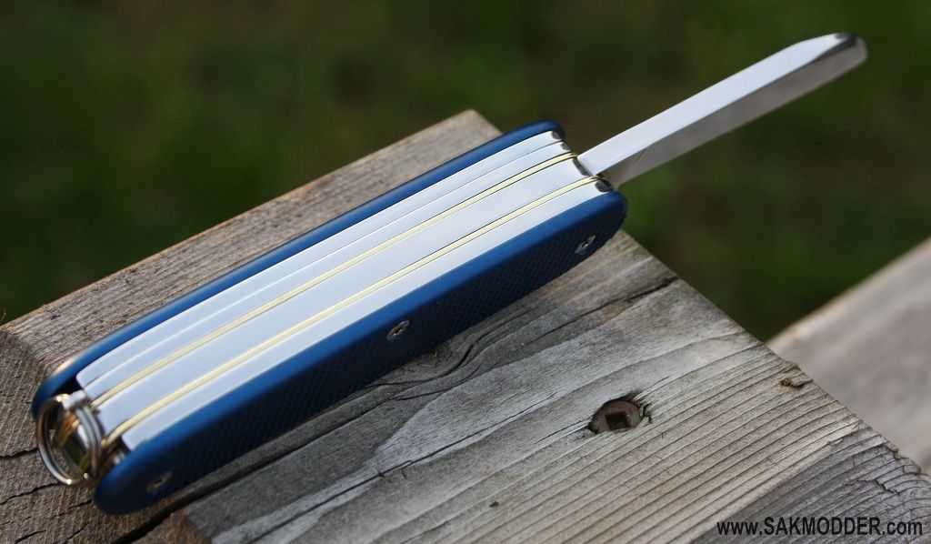

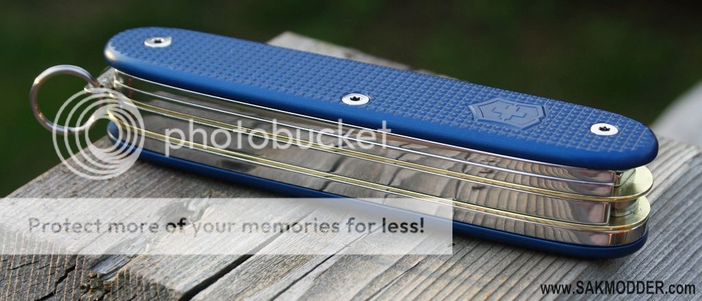

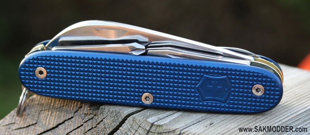

I gotta show off this beefy beauty. Blue hard anodize, brass liners and a 154cm blade you could pry open a door with... :D

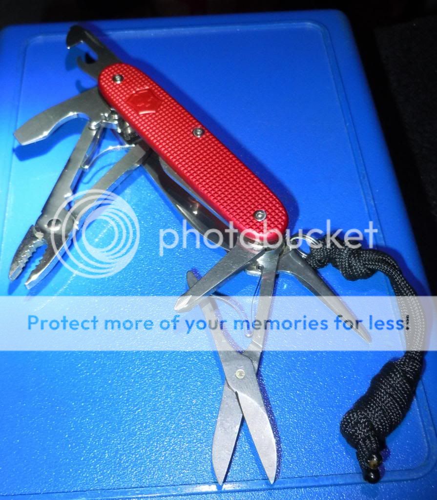

Syph, you rock! I'm still loving my 8-bladed Alox that you made earlier this year. You are the master!

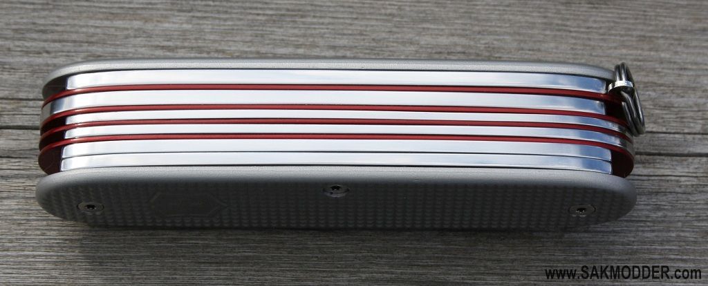

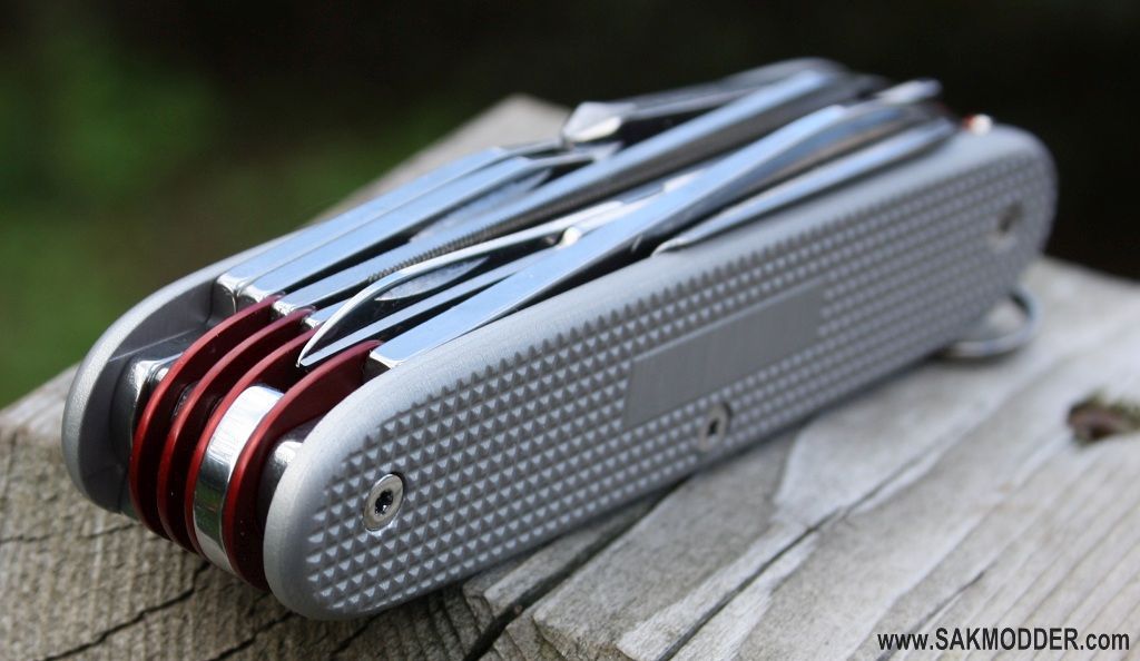

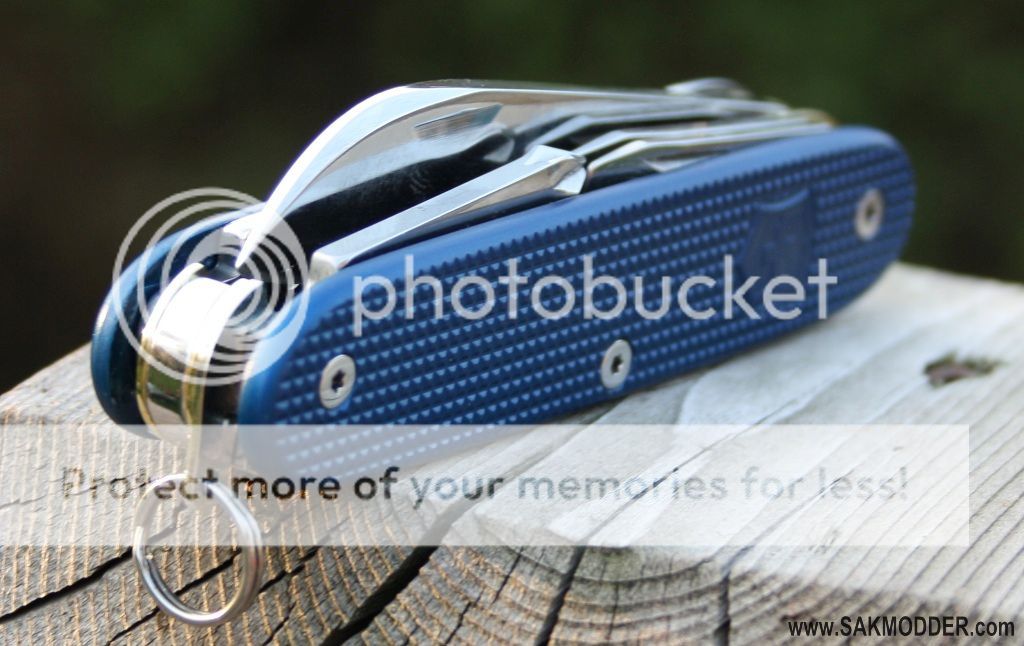

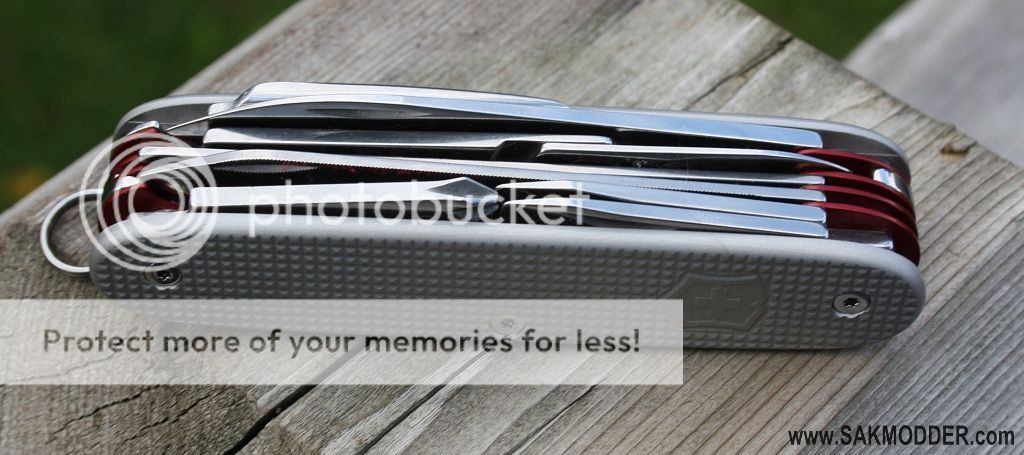

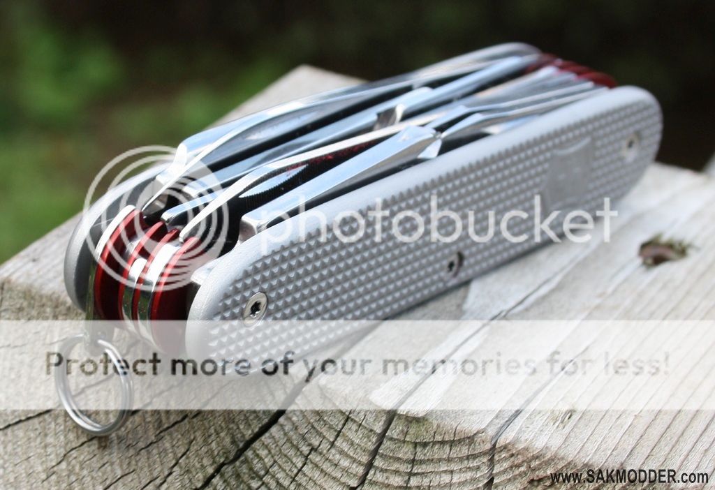

Well here is a first for me... a 93mm with a fish scaler :D I even surface ground down a spring to 0.060" to work perfectly with it. Its a very thin layer. To give you some perspective, the pliers layer in a swiss champ has liners that are 0.050" thick.
This one also has the seldom requested natural hard anodize which is a matte gray color. It works really well with red liners.

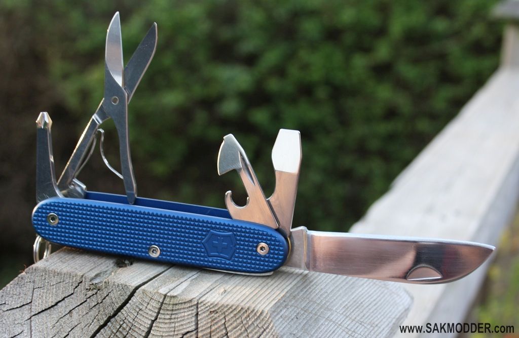

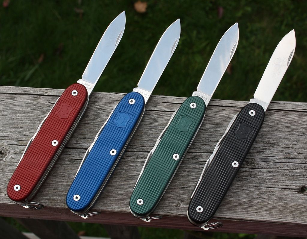

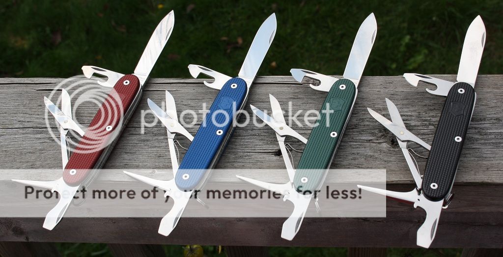

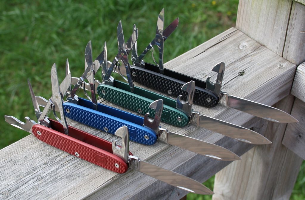

Hey guys I wanted to build some display models, so I put together a pioneer + scissors mod in each of the colors of hard anodize that I run.
Hopefully having the 4 colors pictured together will make it easier to get any idea of how each color looks.
Those 4 colors are all that I run in hard anodize, but I also do white and safety orange in cerakote. I'm making myself some display models with those colors next to have a full group shot.
