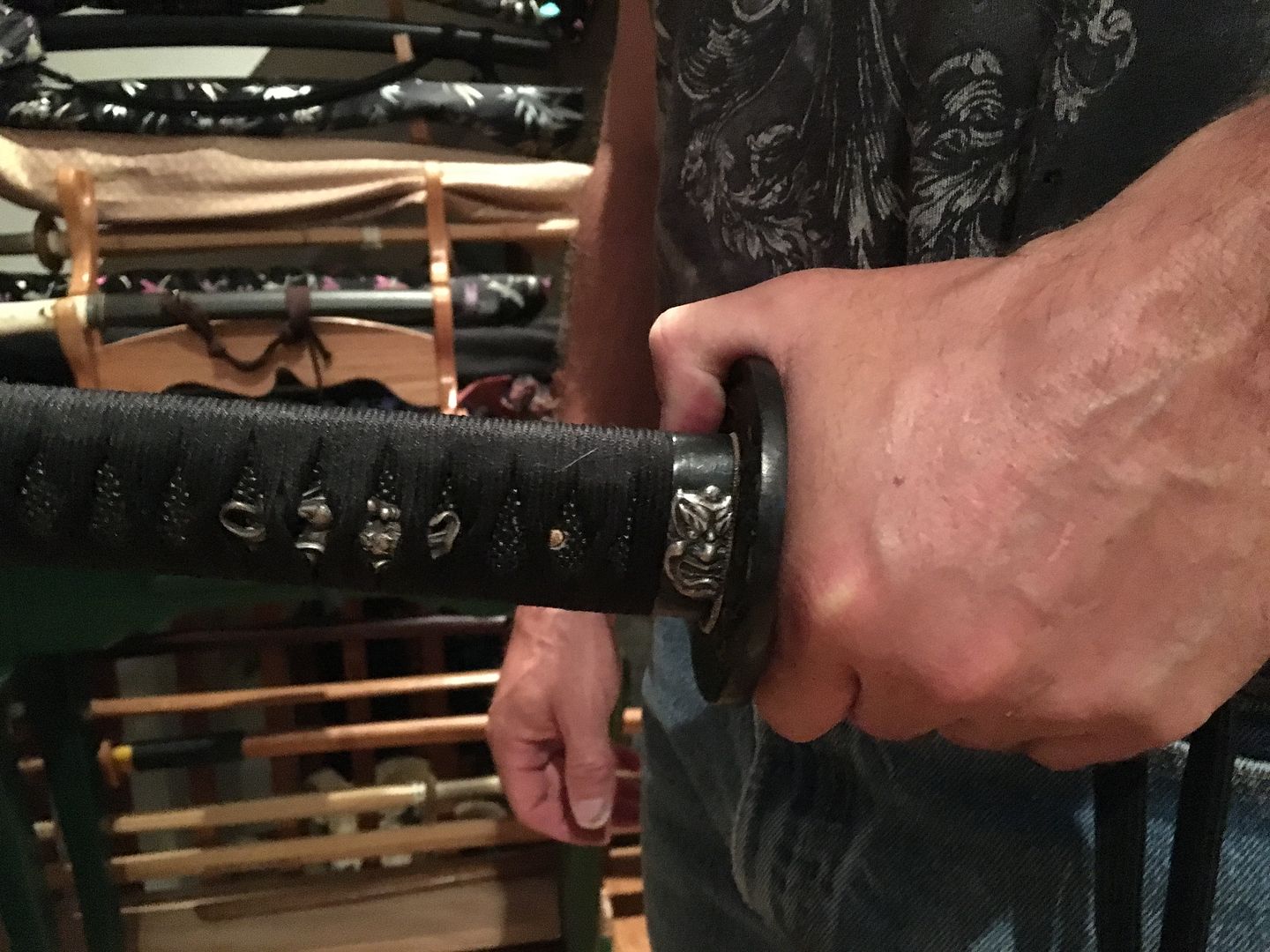

Okay before I go in to David's SAYA I would like to explain what I look for and what I want in the way the sword fits into the SAYA (scabbard)
This is my preferences and others might have different preferences and likes and I do not know what is considered proper ....only as a user what I like

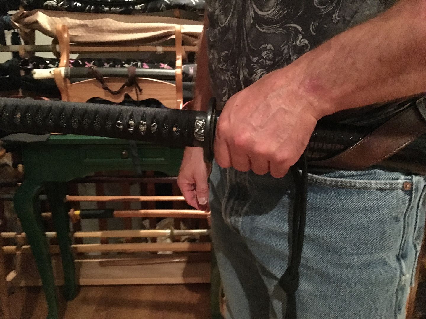

The Habaki for me needs to fit into the mouth of SAYA on the snug side

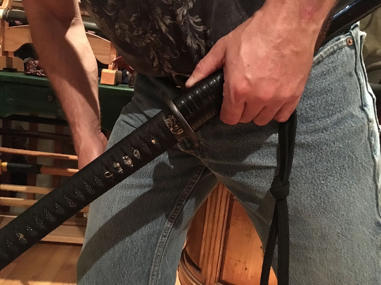

For demonstration purposes I just placed a sword thru my belt ...no Obi (traditional Japanese sash)
Sash carry is all that interests me for this type of blade
Sword resting in sash

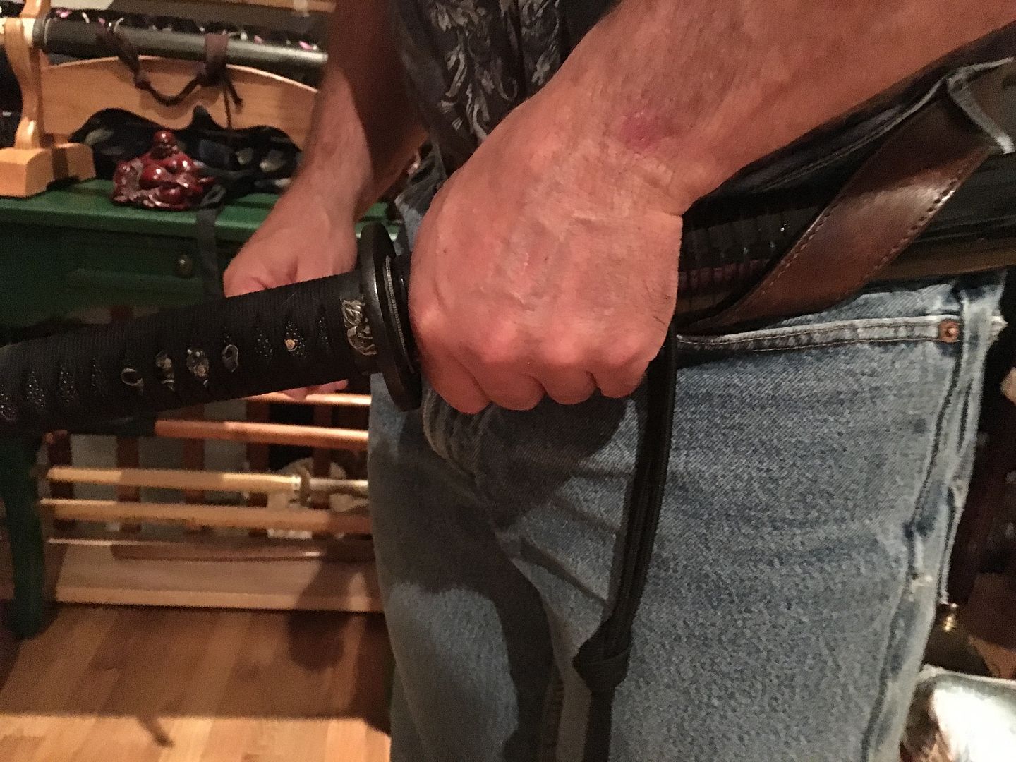

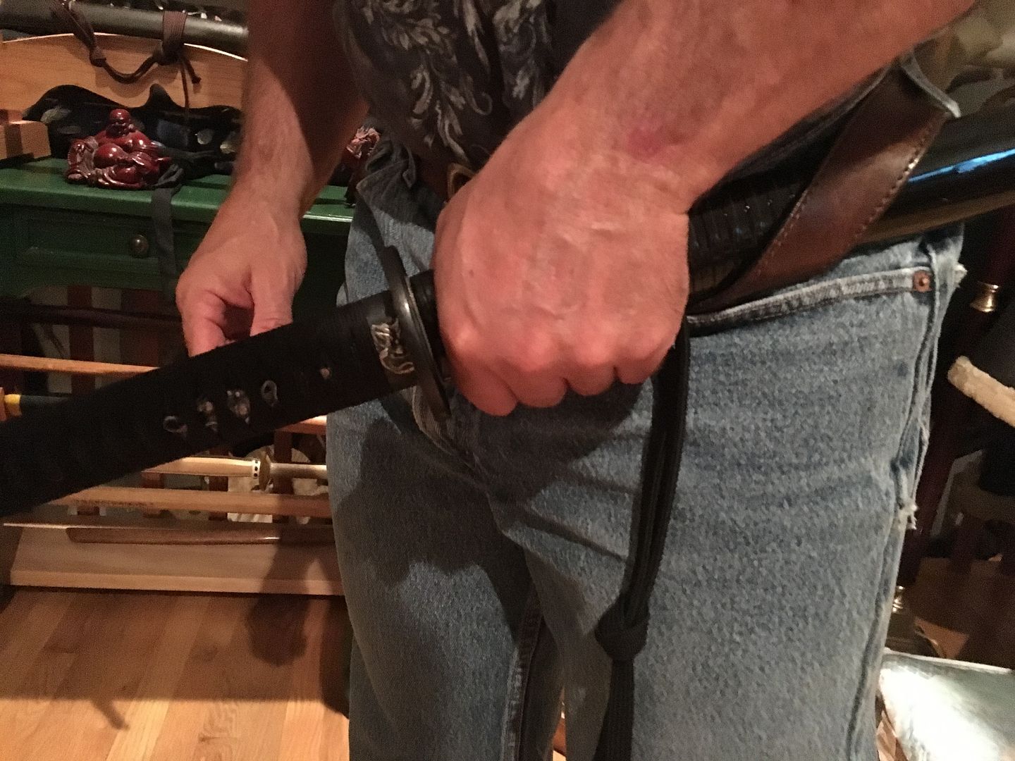

I like the Habaki to be tight enough that it has good retention . Now don't get me wrong I would never tilt a sword Tsuka down like this with out holding the blade into the SAYA like this
But for example here I will not control my blade and tilt it forward with out holding it in (controlling) the sword
I want the fit to be snug enough that I can do this

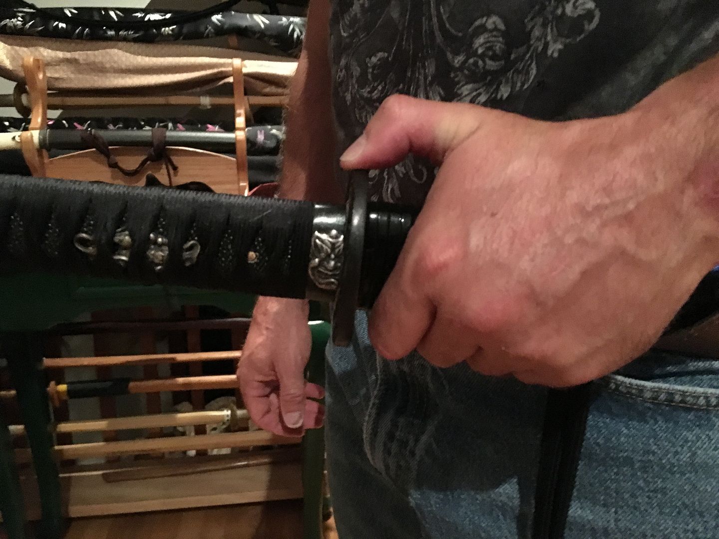

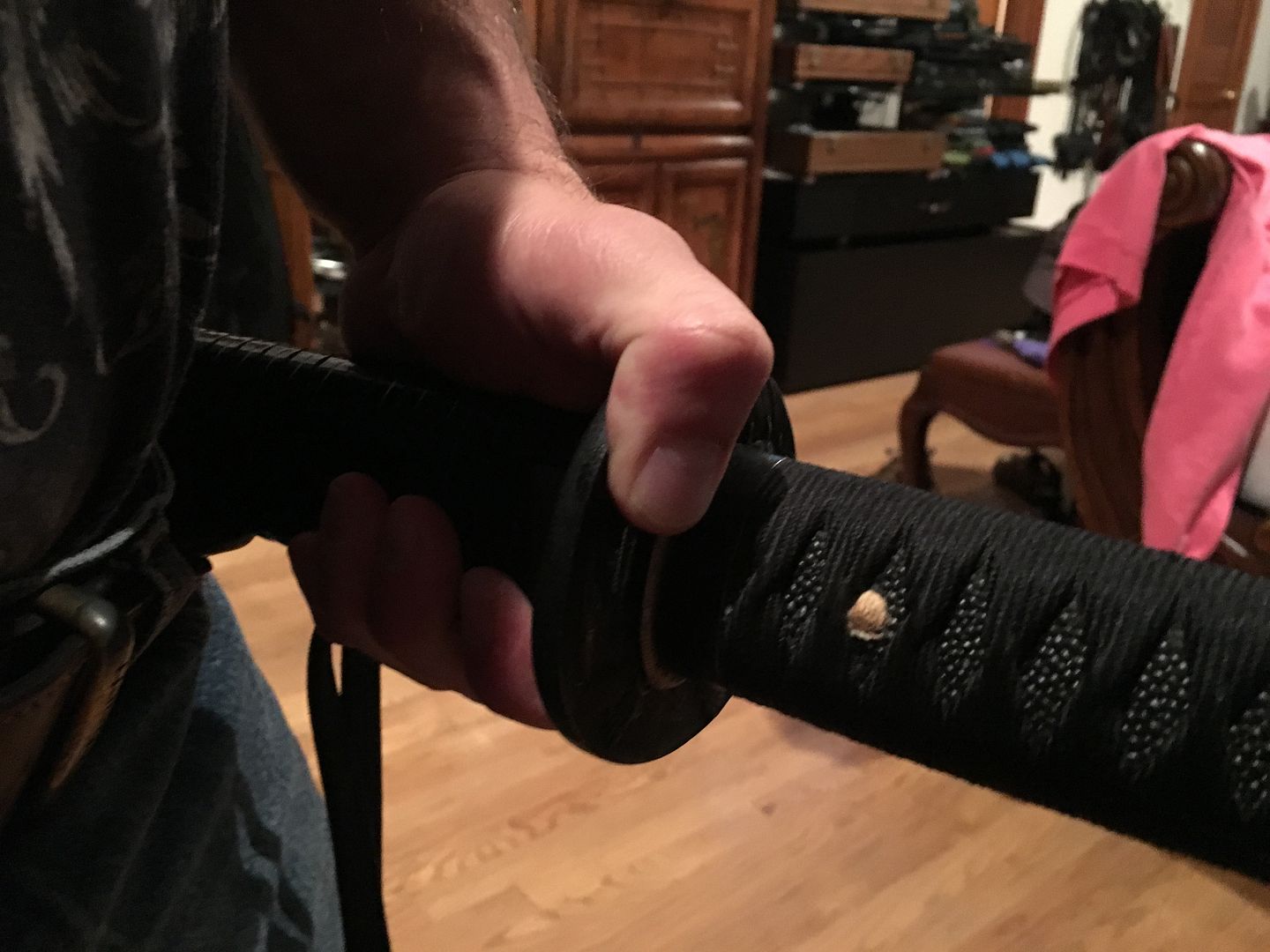

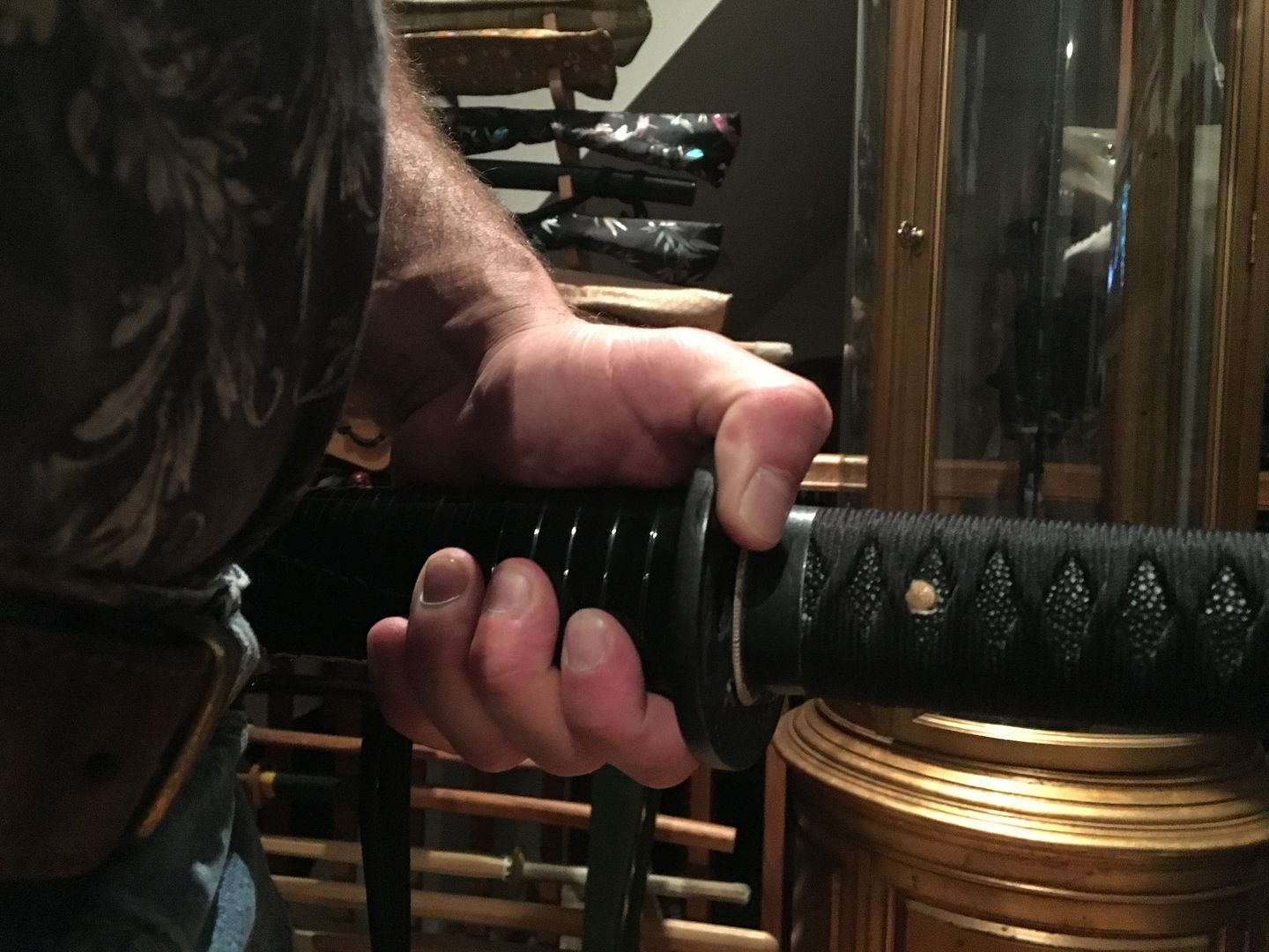

Now for me when ever I'm moving or doing anything quickly I am controlling my sword by wrapping my thumb over the Tsuba (guard)

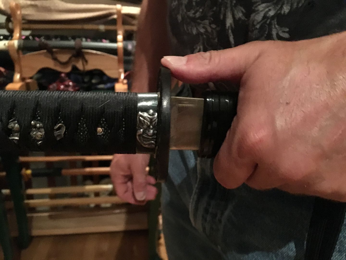

Now remember I like a very tight fit so when it's time to draw the sword my thumb moves to the rim of the Tsuba (guard)
I straighten my thumb out in turn breaking the seal of the Habaki and releasing the sword
So this is what I like and next we will go into what David is doing to facilitate this

After breaking the seal with my thumb I than depending on what angle I want to draw the sword to facilitate the cut roll the sword controlling the SAYA with my weak hand while drawing with my right

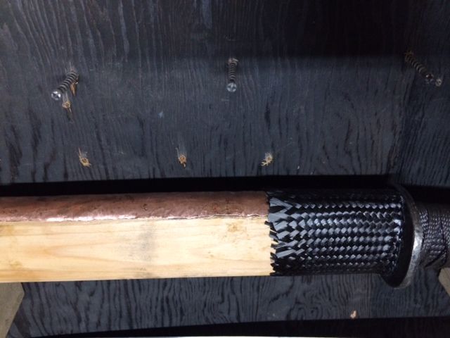

This is how he did it
From David :

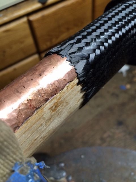

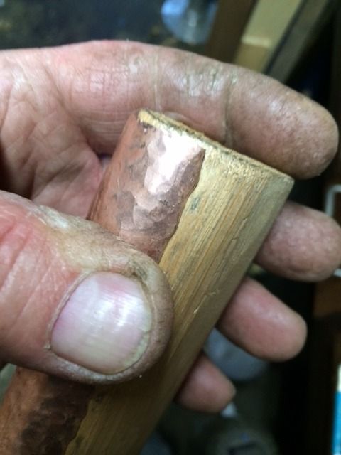

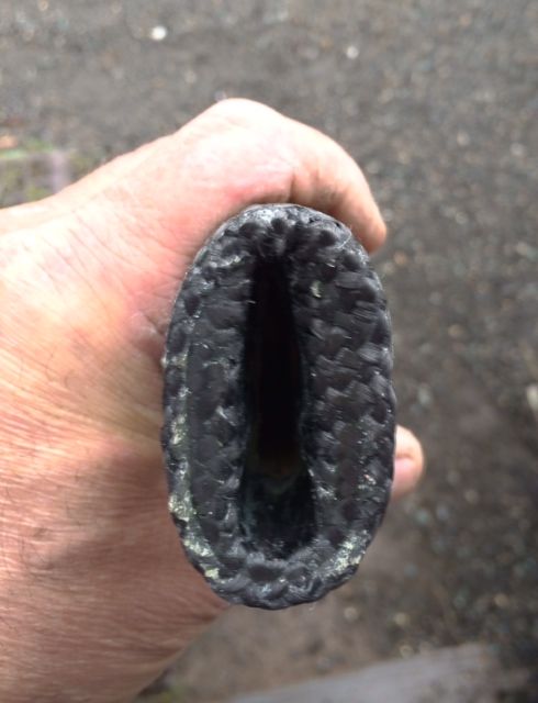

I decided to use a strip of copper on the ha side of the saya for extra safety from the blade cutting through the saya, should you screw up the draw cut. I tried to imagine how this unforeseeable event could happen... With the carbon fiber skin over the saya, I don't think it would happen, but Joe wants this to be battle ready and wants no chance of the unthinkable to happen. I was going to use an iron or ti. band around the mouth of the saya, but that wouldn't prevent what I could see happening should you really try to rip that blade out at some weird angle. So I rolled and forged a strip of copper to fit along the edge of the saya. This will also be covered in carbon fiber.
First I carved away some material from the edge of the saya so as not screw up the flow...
The next step creates the integral koiguchi. Also gives me the habaki to saya fit up.
This is saturated with resin, sword heavily waxed then inserted into saya...
Hopefully I will be able to remove the sword when I get to the shop this morning!
I will lay up the saya today...

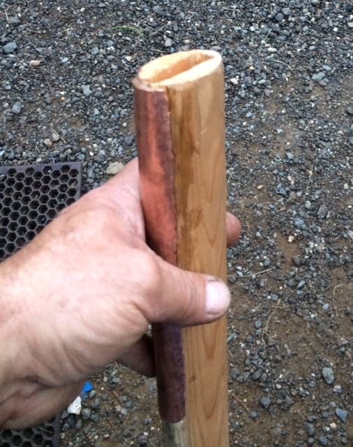

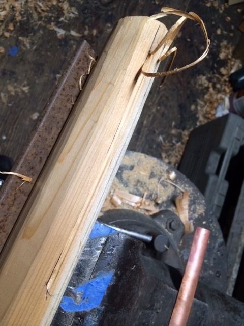

To follow up on Ed's comment on the wood...
Yes, Ho is traditional. But the Japanese are importing Port Orchard Yellow Cedar to their country because of the similarities to their Ho. I have a piece of the P.O. Cedar, it's not bad, but the AK Yellow Cedar seems to me to be a cleaner wood, with almost no visible grain. Carves beautifully. Now this red cedar! Doesn't carve well, but it will carry this blade more than sufficiently.

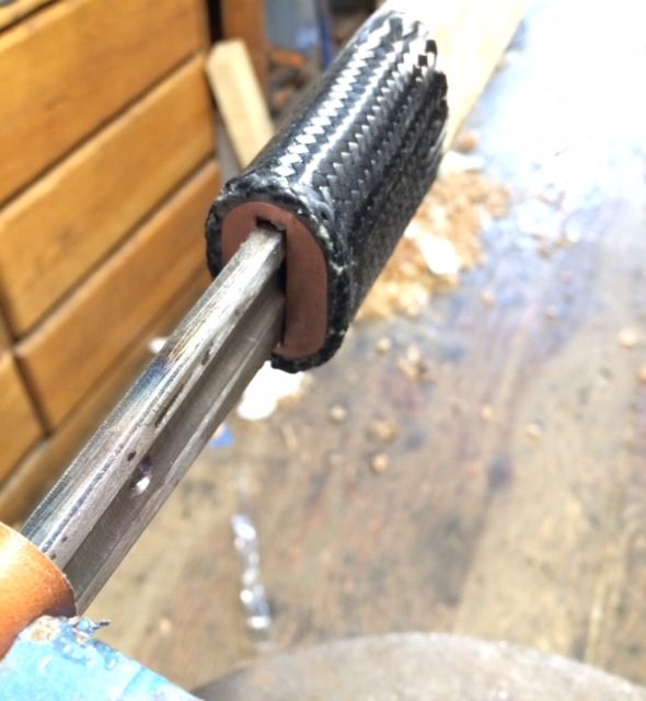

My koiguchi is integral with the saya. I believe that this is where I deviate from tradition...
After breaking the nakago free from the tsuka..... You can see the seppa still embedded on the seat of the koiguchi.
You will see that the inside the saya how the carbon fiber has been formed to the bo hi.
