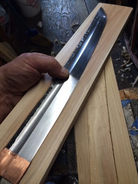

From David :

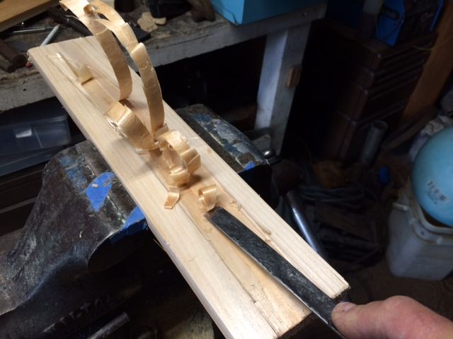

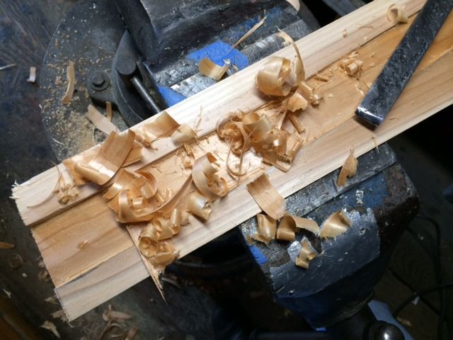

Started the saya today.
I almost always use Alaska yellow cedar for my tsuka and saya. But I am running low and need to reach out to my source. That will take time, so I am using NW Coast red cedar for this saya. It has been used by many of the NW Coastal Indian tribes for hundreds of years. I have some really nice clear red cedar for this project. It is a bit more work to carve the channel for the blade to sit in. But in the end, it will work just as well.

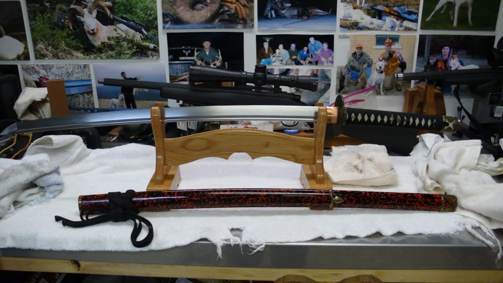

A wild Laquerer job done by Michael Bell on one of the swords he did for me decades ago
I have one that was fluted and than gold dust blown in the flutes and than Laquered over
Blade forged by Louis Mills and Rick Barret and than mounted by Rick

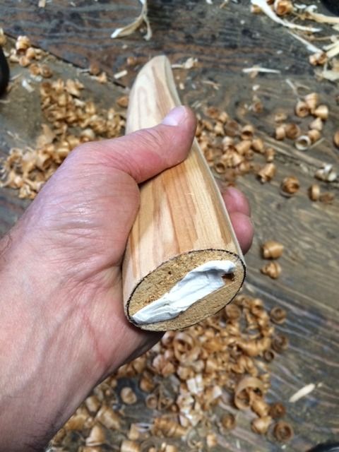

David has a very unique approach to his SAYA
He makes the SAYA out of cedar and than wraps it in Carbon fiber for strength and durability
What you get is the fit and feel of a traditional SAYA with the added strength and durability of carbon fiber

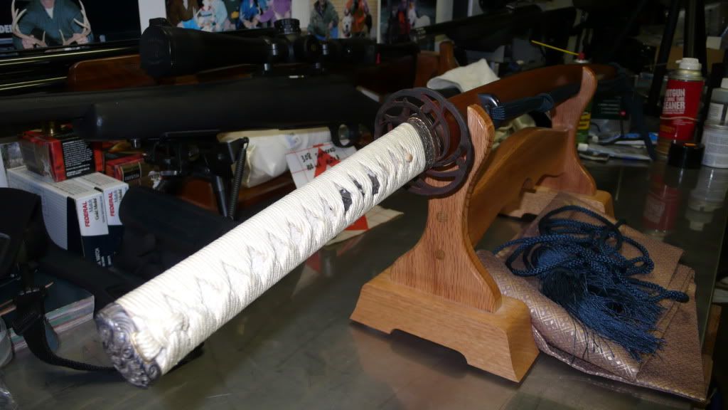

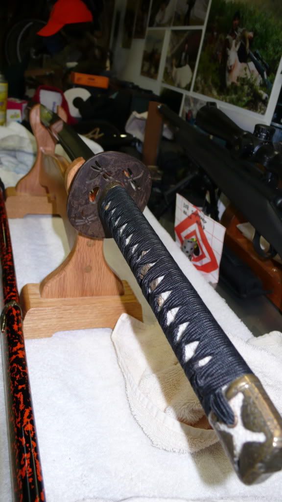

Well over 20 years ago Michael Bell made a hardwood SAYA with a Ho wood lining for an antique Nihonto that I own
It was my first big sword project on a very nice blade I found in New York as a young aspiring sword collector
Here is the mouth of the SAYA
The rest of the sword
I really wish I had access to Coop for a week to take real pics of my sword collection :)

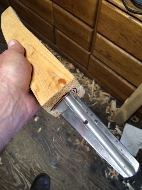

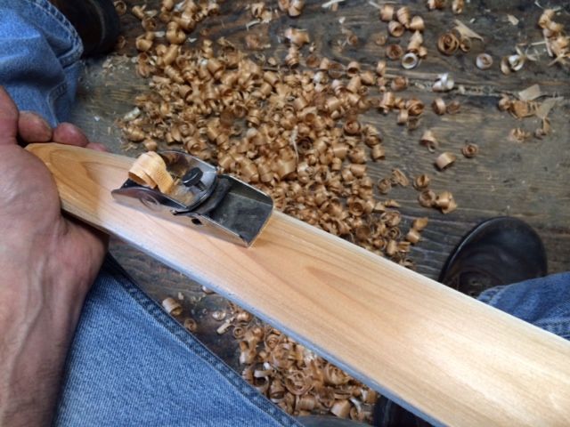

From David:
I'll take a lot of this excess material of of here and refine the shape. I like to use a small plane for this as it's way too easy to remove too much material with the grinder and ruin what you've got started.
