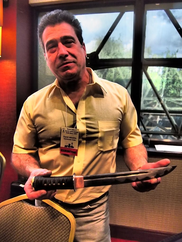

Joe, the steel used in your sword is it W2 ?
Vic
VicS
This blade was forged from an old axle oot of a very old mine in Alaska
I believe the same sight that the antique wrought iron was sourced out of for the Tsuba (guard)
I mentioned in the first post that all future varients will most likely be W2
The subject of mystery steel is pretty well discussed and in No discussion I have ever seen has any positive merits been attributed to using mystery steel in today's day and age ............... But for this piece it fits and being that this blade was never meant to go to anyone but me for blade design and geometry testing I'm fine with it
I do believe a good smith can judge a piece of steel fairly well by how it works and heat treats
David tested this edge on hard wood , horn etc and is satisfied that it will serve its purpose and I kinda dig the raw origins and sources of the steel
Hell I'm just happy ot survived heat treat![]()
[video=youtube;eb9ZCyvf8uQ]https://www.youtube.com/watch?v=eb9ZCyvf8uQ[/video]
Another of my favorite smiths out there the great Bill Bagwell of ABS fame and founding member at times used what we would call mystery steel
He would judge it by how it worked and how it performed
I have an old Bowie from Bill that the steel was sourced out of an old plow found in a field
It is one of my best performing bowies
Now I'm not suggesting any hocus pocus magical nonsense in mystery steel in fact I'm stating far the opposite
Today with great new steels available and the formulas to get great heat treats easily accessible it's a no brainier but for an old forged blade fan like me I'm alright with it in some cases![]()
My thought is if David was not confident in it he would not be sending it to me knowing I'm going to train with it and possibly bet my life on ....... He's my friend
But to answer your question David will work in any steel the client prefers ..... I have a feeling that many might be requesting some old mine axle steel![]()
