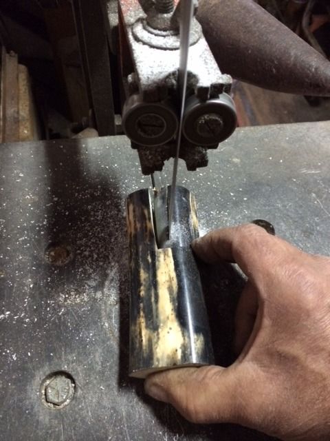

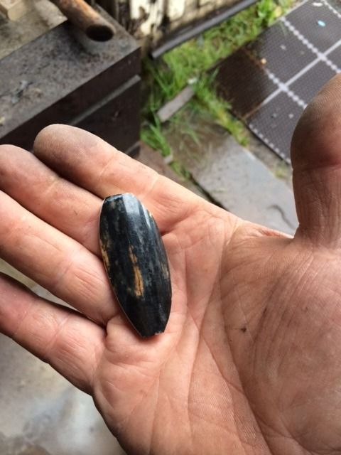

He started with this
Ground it to this

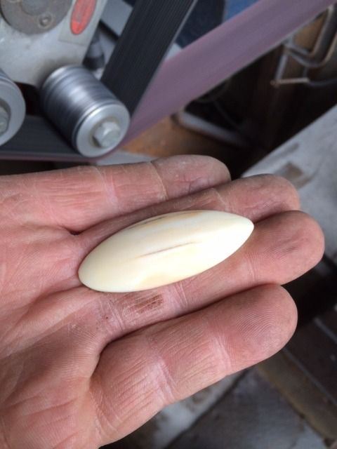

Than because I wanted creamy white Menuki on the dark carbon back ground with the dark wrap he further remove the wonderful dark layer to get to this
Know these will be reduced even more in size to fit the handle but David has a neat trick

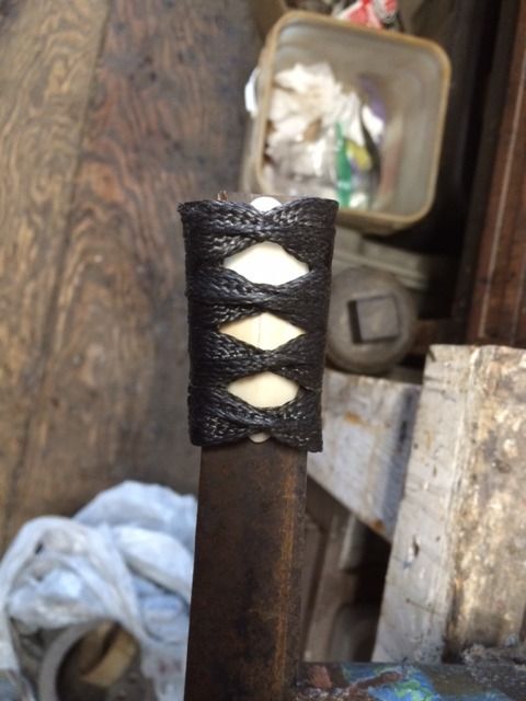

Anyone who has soaked their cord wrapping in resin knows these wraps get hard as a rock and super grippy
He has a section of resin soaked cord he cut off a handle and he uses it to preview how things are going to look
Now remember these will be reduced even more and polished when he fits them to my handle but you get the feeling
How cool is that :)

Here is the finished Menuki sized and polished
The larger will be on the right hand side of Tsuka (handle)
Giving the desired palm swell effect

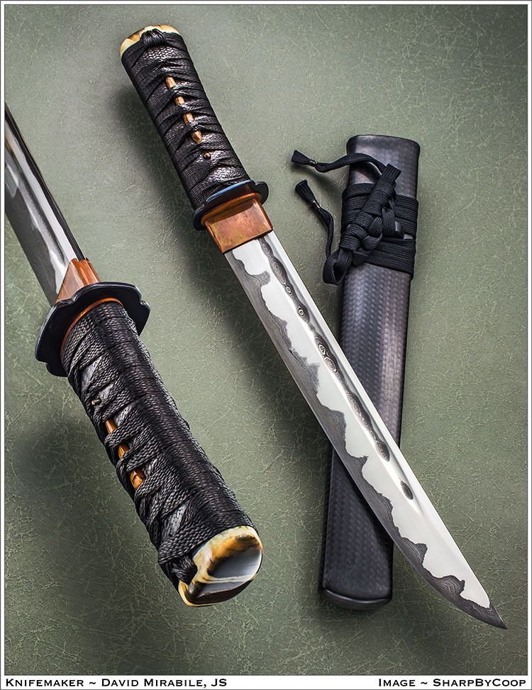

And just in case you hadn't seen the photo or Joe's cutting video before....this is the "fancy" version. I cannot tell you how much David's work speaks to me. (Even when I'm on my meds. :D) I was lucky enough to see the new blade at the Blade Show. It's going to be an incredible piece (in my opinion). Very excited to see each installment of this thread. Thanks again, Joe. Mike
I hated to part with that piece buddy :)
But it could not have gone to a better Patron of the arts
As beautiful as that piece is I was more impressed with how it cut
What was more impressive and what we were curious about was how the blades finish would hold up
It did not mare is]n the least bit and that photo was taken after the cutting
I wiped it off put Tuff Glide on it and shipped it to Coop
I believe it helped that I did not cup a cut :)
