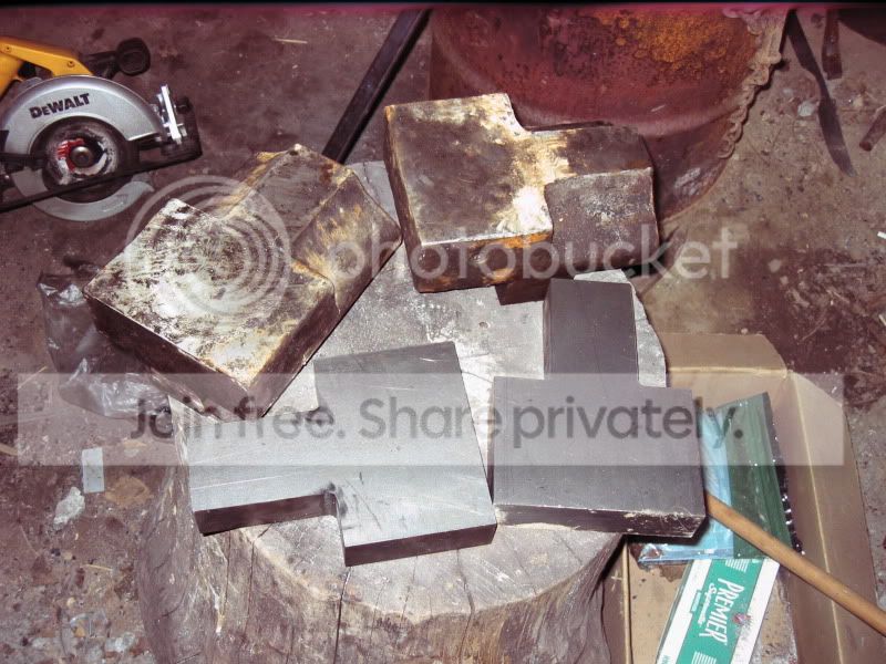

The retort is finished and I'm running it tomorrow. I finally have all the metal to finish the hammer. Also I'm going to try to get the clay for the new forge on tuesday, this took a lot longer than I expected but I'm hoping it will finish quick. :)
The hammer dies and the plates that are being welded on top.
Thanks for your patience guys!
-Dan

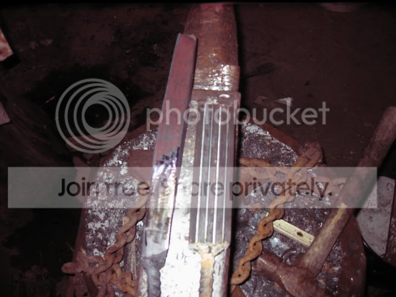

I did the first weld and draw on the first of the two billets today but I need to modify my one hammer die shim and replace or modify two pins on the hammer before I continue. I'll probably finish at least one billet by friday night.

If a billet welds in a shop and there are no pictures posted, does it really make an impression?

Fine fine I'll get a pic :), btw it was a 1-1/2"x1-1/2"x6" billet. The hammer welded it with one hit. :D:D:D Although the vibration in the shop knocked my forge blower off; thus resulting in a sore leg from running outside to turn off the propane... but I'm alive so its all good. Duct taped that sucker on good this time. :D
edit- raw billet on the right and the welded on the left.
Its 5 layers 1-1/2"x1/4 1084 and 4 layers 1-1/2x1/16" 15n20.
