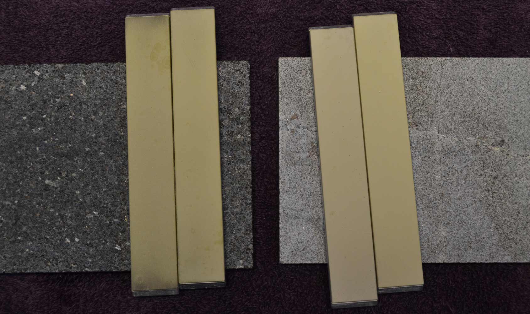

A while ago I ground some different "granite" tile pieces flat to see if they would work as dressing flats for Matrix stones, just haven't tried them yet.

I have played a little more with dressing the Matrix stones on flat stones. What I used were "granite" tiles I machined flat since the only bench stones I have are for deburring flat surfaces in my machine shop and are NOT used for anything else. They worked ok, developed some mud, and cleaned up the Matrix stones ok, just ok. The ends of the Matrix stones are not getting cleaned up very well but otherwise look good. Still, I think stones are much better than sandpaper. I am back to "loose abrasive on a flat plate is by far the best way to dress Matrix stones", nothing else is even close. Here is a photo of the Matrix stones on the stones I used to dress them, please dis-regard the water spots. I spent a lot more time dressing on the stones than I would have if I had used loose abrasive.

I really don't think using a diamond plate to dress the stones is a good idea. It may kind of work because your only really removing resin on the Matrix stones but it will be hell on your diamond plate. Even if it works well at best it will be 20% as good as loose abrasive on a flat plate, which is about where stones and sandpaper lie.

Using diamond to lap diamond stones is a no no. The objective is to wear down the binder to expose fresh abrasive, a diamond stone will wear down your diamond abrasive a long with the binder. AlOx nagura stone is good to go, or loose SiC powder.
I agree with Baron Mind don't use diamonds to flatten diamonds,because the diamonds are the same hardness you will damage them,you just trying where back the binder as mentioned already.
