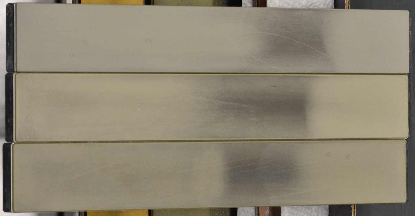

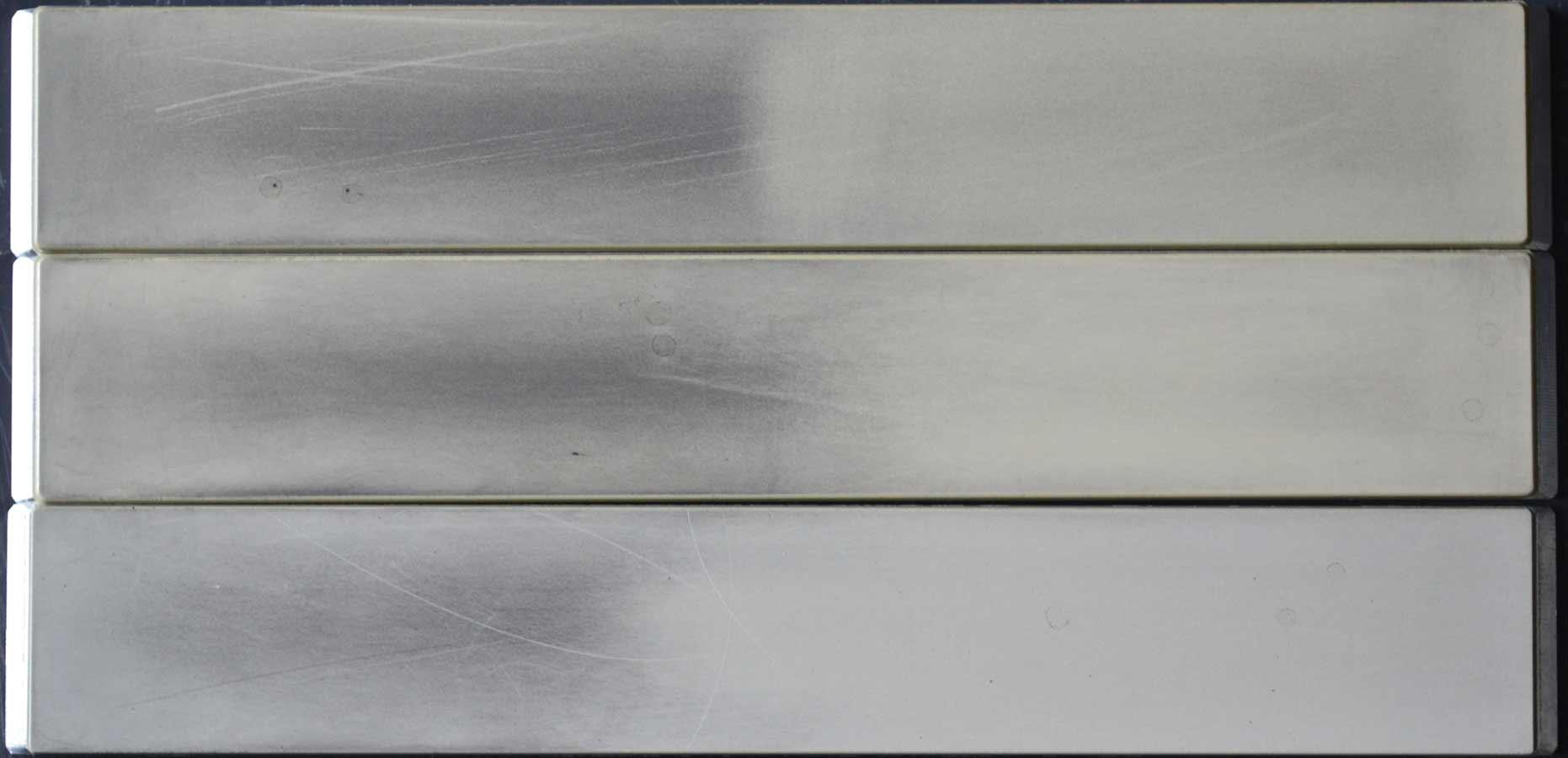

I finally got some dry BKF and Comet to try. The dry BKF was used on the top right and bottom right ends, the Comet was used on the center-right end, wet BKF on the left ends. All were done with about 15-20 seconds of rubbing with my finger or thumb. If anything I think the Comet might work a hint faster but since it has bleach in it that rules it out at my house. I'm on a sceptic so no bleach and no fabric softener!!! I think this is the best way to clean these stones that I have tried so far, definitely better than alcohol. I will keep doing this as a long term test to see if it has any effect on how they work and let EP know. A big thanks to Wade for the question about using BKF. By the way, these stones didn't work any differently after cleaning them. The little bit of metal coloring the resin doesn't affect how they work.
Stones are 1100, 2300, and 4000 at the top.
A bit of an update. Ben already knew about using the cleansers to clean the stones and has been recommending it.
Nice comparison! I noticed that after I cleaned them too, as I ended up doing one more knife. They would have to be dang near black b4 actual NEED to clean.Another plus for the Matrix.
