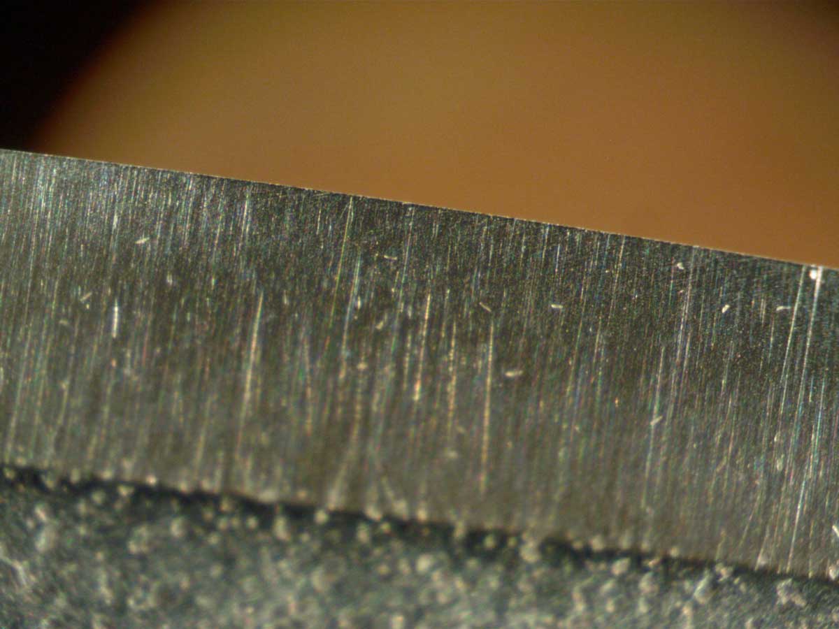

This post is simply to add to a video I made sharpening my Spyderco Maxamet knife with my EP Matrix stones. Here are the photos I took with my microscope to show the edge after sharpening. I didn't notice the damage to the edge until I was watching the video but being my EDC beater I wouldn't try removing them anyway, but I do find them quite interesting.
This is what the edge should look like, this is towards the tip.

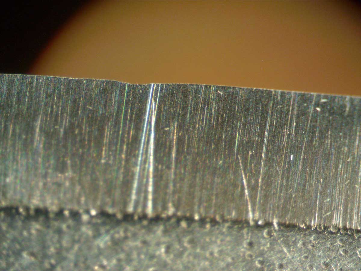

This is an interesting wave of some sort, not sure how it happened.

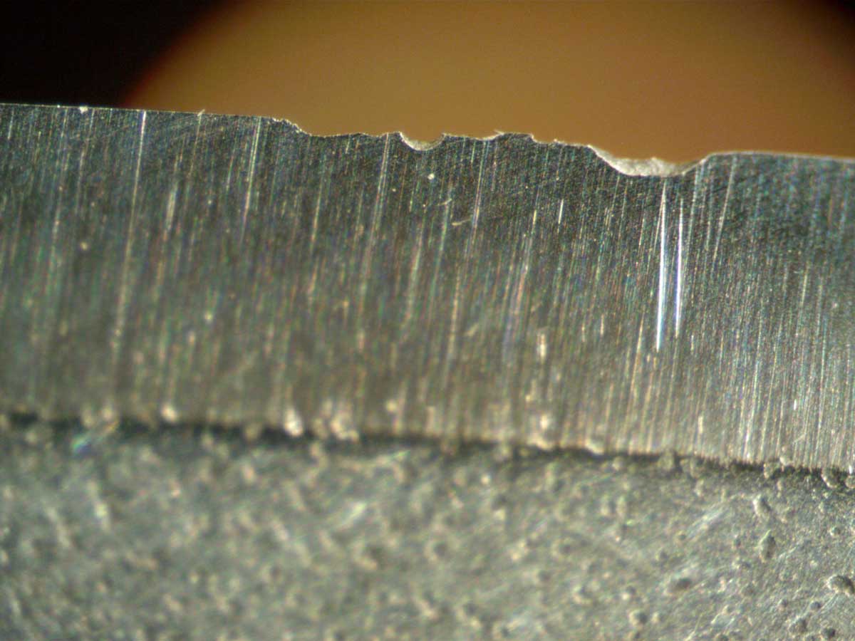

And the ugly! Keep in mind the bevel is about .06" wide so the chips are not that big of a deal, but I haven't done much with this knife. I cut a few pieces of cardboard and cut the tape off of some aluminum bars, which is where I think this happened. I am a bit surprised at the chipping. It is only the 5th sharpening and 30 degrees inclusive, maybe I need a microbevel to increase toughness. Still learning so just part of the fun.
