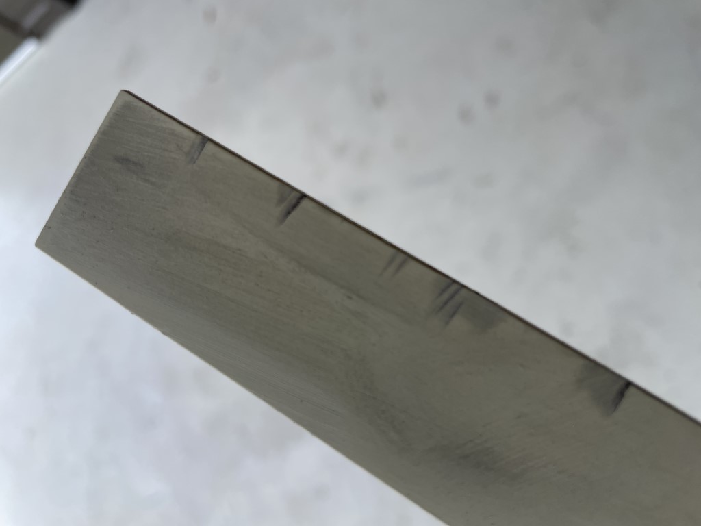

I have to admit, I don't use a Sharpie to check my angles. I only use my naked eye to look for the burr and by feeling for it.
I get tired of the ink coming off into the pores of my stones (the fine ones) .
Sharpy ink, in this application is kind of thickish . Personally I cut back on the ink by just putting "ticks" every half inch or 10mm or so down the edge.
One other option is machinist's dye; this tends to be slightly thinner . I put it in nail polish bottles I buy empty on the big river. I have a few stashed around the shops (work and home) .
