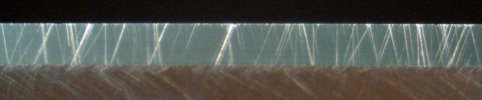

One question, I can get a beautiful, scratch free mirror finish on my edges up to the 2,300 grit but then on the 4k I get lots of scratches - I don't think this is normal with the matrix stones, do you have any ideas?
@Diemaker I recently sharpened a couple of my friends knives with the matrix stones (up to 4k and then up to 0.1 microns with diamond paste) and he remarked they cut better than when he bought them!
I just sharpened my pm2 Maxamet right to the hilt, took it to 650 and it's got a lovely toothy bite, I love these stones.
It sounds like your 4k stone is contaminated and needs to be dressed to clean it up. 10-15 seconds with the 240 grit Alox on a flat plate is all it needs to be working like new.
Have you been using edge leading strokes with the 4k? IME this is the fastest way to "contaminate" the stone so it causes stray scratches. I think it catches burrs along the edge and pulls them between the stone and bevel embedding the bit of metal in the stone and scratching your bevel.
Thanks, yes I have been using edge-leading strokes.
I'll clean up it as you suggested and try using only edge trailing strokes.

Here is the best image I can find of what I am talking about. This is using a Matrix 9000 stone on my Henckels santoku, details matter. Notice that many of those scratches point to damage to the edge. I really think the stone is grabing either burrs or the apex and pulling it between the stone and bevel. An SEM video of what happens when sharpening would be nice, wouldn't it? All of the deep scratches are from the 9000 stone, the nice polished part of the bevel is from the 4000.

That top photo is interesting. Why would a 9K stone grab metal from the edge and scratch the bevel and a 4K does does not? Not doubting you, just trying to understand.
Regarding wood strops, I always sand mine before applying new compound so the are essentially new every time. I just move them across 150 or 220 grit sandpaper like I would if I was dressing a stone. About 30 seconds and done. It takes a while to wear through 1/4" of wood. When it gets too thin I just pry it off and glue down a new piece. I'm interested in trying the tape as well.
I'll give you a call this week about getting some 3x8 stones.
I think they all will catch the burr/fine edge of the apex and pull it between the stone and bevel, this photo is just of the 9k doing it. It is also more noticeable the finer the stone gets, probably because the bevel is getting more polished and the apex is getting thinner. Maybe the softer bond of the Matrix stones makes this more likely vs a harder bond? I haven't done any experiments with edge leading vs trailing with vitrified bond stones, it's on the list of things to do but is pretty far down that list.

I cleaned the 2300 and 4000 on the plate with 240 carbide and then washed them. Did some more polishing (only edge trailing) and got some scratches again... Very odd.
So, I rewashed them (Didn't want to take them back to the plate again) and have learnt that if I want mirror edges, I'll just give the stones a quick wash between knives.
The finer the stones the fussier they are about keeping clean, same with strops. But the reward is a keener edge, not just a polished bevel.
