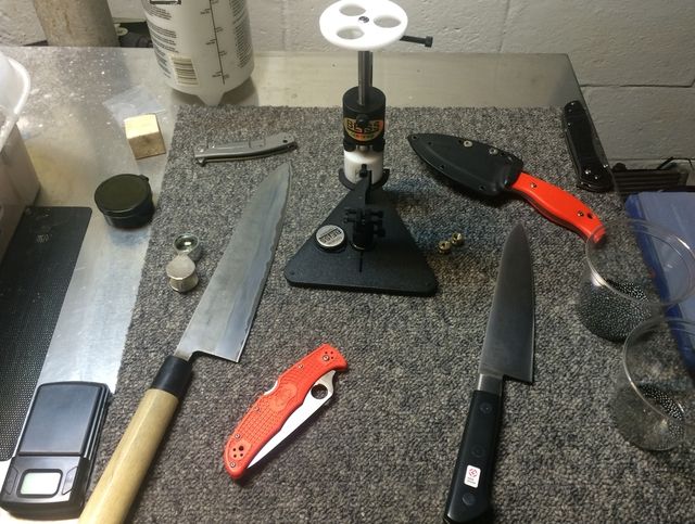

Mine arrived yesterday and this morning I had the chance to give it a few tests.
First, I think this device has major flaws in sharpness testing. First is the test media and it's bias to very high levels of refinement. Next, the test media bows over the edge so you have binding and wedging of the cutting media against the knife edge apex.
I am also seeing a static load issue, if I place (for example) 500 grams on the platform and let it sit for 30 seconds with a polished 2k edge it will cut the media. I have noticed this at several points in the testing where sitting with a static load will eventually cause a cut of the test media.
Next, behind the edge thickness and edge angle seem to be playing a very large part in testing results as would be expected, except these numbers are so far off its unreal. My EDC, spyderco endura FFG, finished on a 2000 grit Shapton Glass stone, BESS score 450. ZT 0450, finished on a 2000 grit Shapton Glass stone, BESS score 1680. Neither could be considered dull.
I ran a full test from 150 grit to 10,000 grit on the Gyuto with wood handle to the left.
The results are as follows,
Nubatama 150- BESS 1580, utility edge-very coarse.
King 1k- BESS 1020, toothy-shaving sharp, most would be happy here.
Naniwa 2k Green Brick- BESS 500 stood static for 20 seconds, push cutting-hair popping, my typical finishing point.
Naniwa 8K Snow White- BESS 934 stood static for 5 seconds, extremely sharp-shaves hair on contact, cuts skin on contact.
Imanishi 10K plus stropping on 1 micron boron carbide- BESS 0/no weight 2-3 second static, with plastic nuts.
Yeah I've noticed it bowing a little when it is set down on the edge. But I don't see how you would have binding and wedging when the test media is only .008" thick and it has opposing forces pulling it apart essentially. Binding seems to happen when something is compressed together and you are trying to cut through it. Of course, the geometry issue you noted may be because you are checking japanese cutlery that has an edge depth of less than .008" thick at which point I see how there could be a notable difference.
I noticed this, on a lesser time schedule, as well (only a second or two). I did not try any 30 second intervals, that was good thinking! I wonder if there needs to be some standard developed time wise?
What edge thicknesses, and edge depths to the shoulders were these folders if you don't mind me asking? Curious...
The binding and wedging issues is very small but present. Testing in any form is very specific and everything matters, regardless of how small.
My endura behind the edge is 0.021 and the ZT is 0.033
