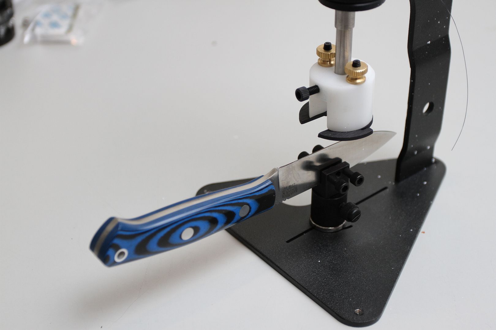

First impression is that it is quite a bit smaller physically than I was expecting from the photos, no reason for it to be any larger, but for some reason my mind had it being about 50% larger in all dimensions than it actually is. The hardware itself is quite well-made, nothing about the unit feels "cheesy". What plastic components the machine has are well-made and fully formed, with all non-hardware parts being machined from solid stock rather than molded. The vertical arm is welded to the base by passing through a slot and welding on the bottom, and the sleeve that holds the test piston is attached to the arm by a pair of set-screws clamp-fashion. The vise is machined from steel, and is attached to the magnetic base with a socket-head cap screw that is easily removed if desired. The screws that clamp the blade in place are black plastic, not steel, so no worries about marring the blade. The vise base is (as mentioned) magnetic and can be moved around the base at will to fit your knife as desired. In my photos, I show the knife oriented "into" the unit, but there is nothing preventing you from rotating both the vise and the test head through 90 degrees either left or right, to test blades as long as you would desire.

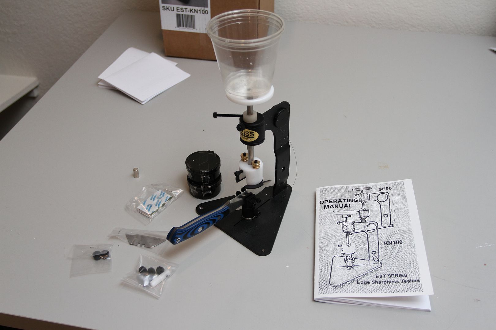

For tonight, have some photos of the unboxing. :) If anyone is interested in additional photos of the machine from any angle, higher resolution shots, or wants to see something in specific, just ask and I'll be more than happy to shoot 'em. I hope to take some video of testing as well, once I get up and rolling with it.

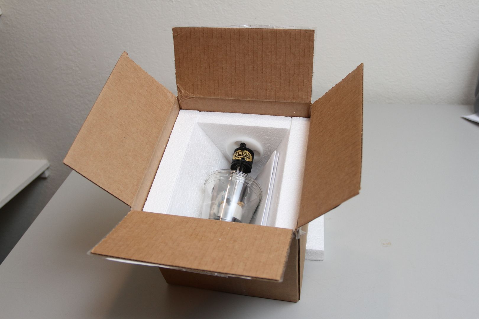

The testing unit is packed neatly inside, along with all of its acessories, in what appears to be custom-formed foam packaging. The fit was precise, not shown is the piece of foam that covered the face, it's being used to support the box the right angle for my photo.
All set up and ready to roll, short of loading with the test media. The knife in the vise here was pulled off my belt for the photo, it's a BRKT Northstar EDC, for scale.
Just another shot of the Northstar EDC in the vise. I note immediately that the bulk of the knives I carry will not really fit into the vise well, due to a greater spine thickness than the vise will accept. I'd call this more an issue of me liking heavy-bladed knives than of any weakness with the tester design. Just might want to bear in mind if you particularly like thick blades. Fortunately, a magnet was also included that should serve very well to hold my thicker blades in place.
