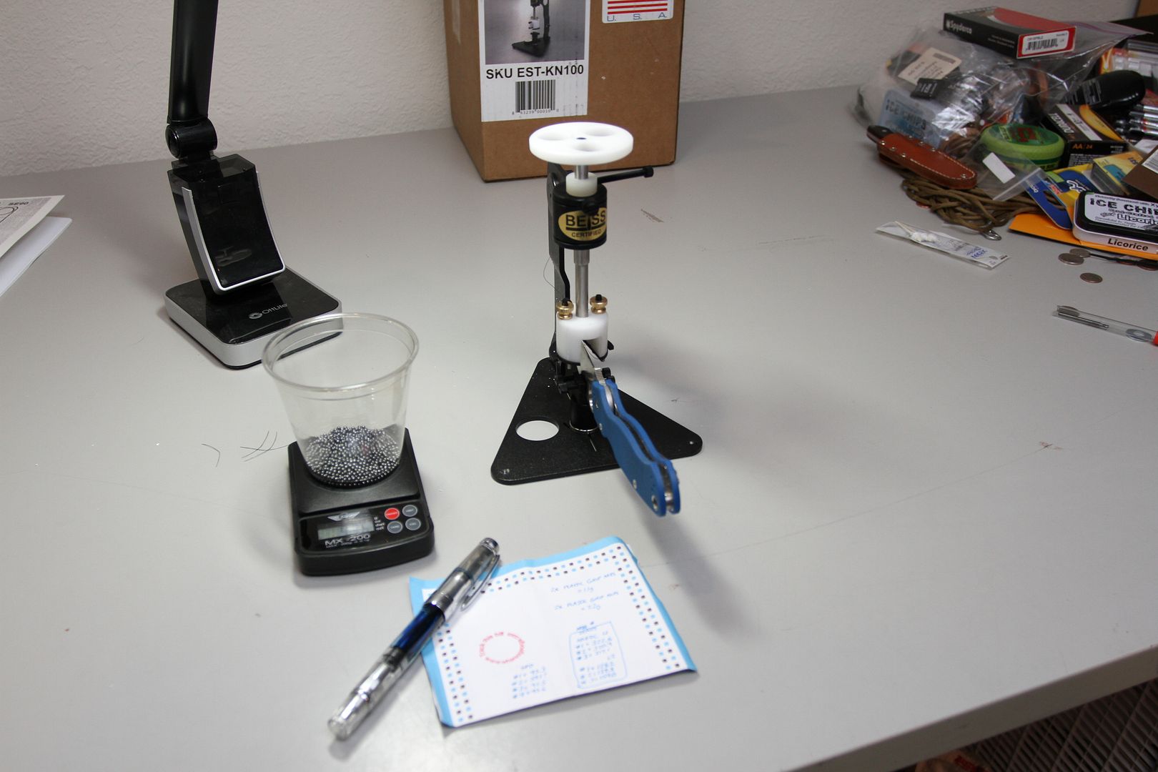

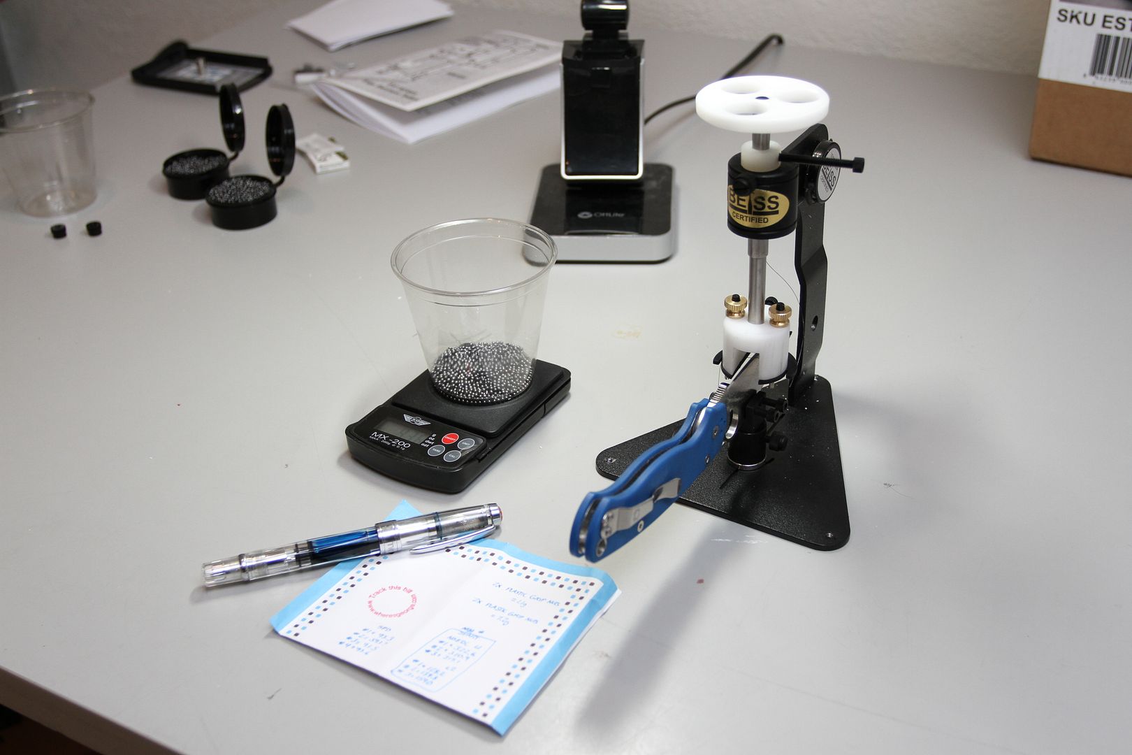

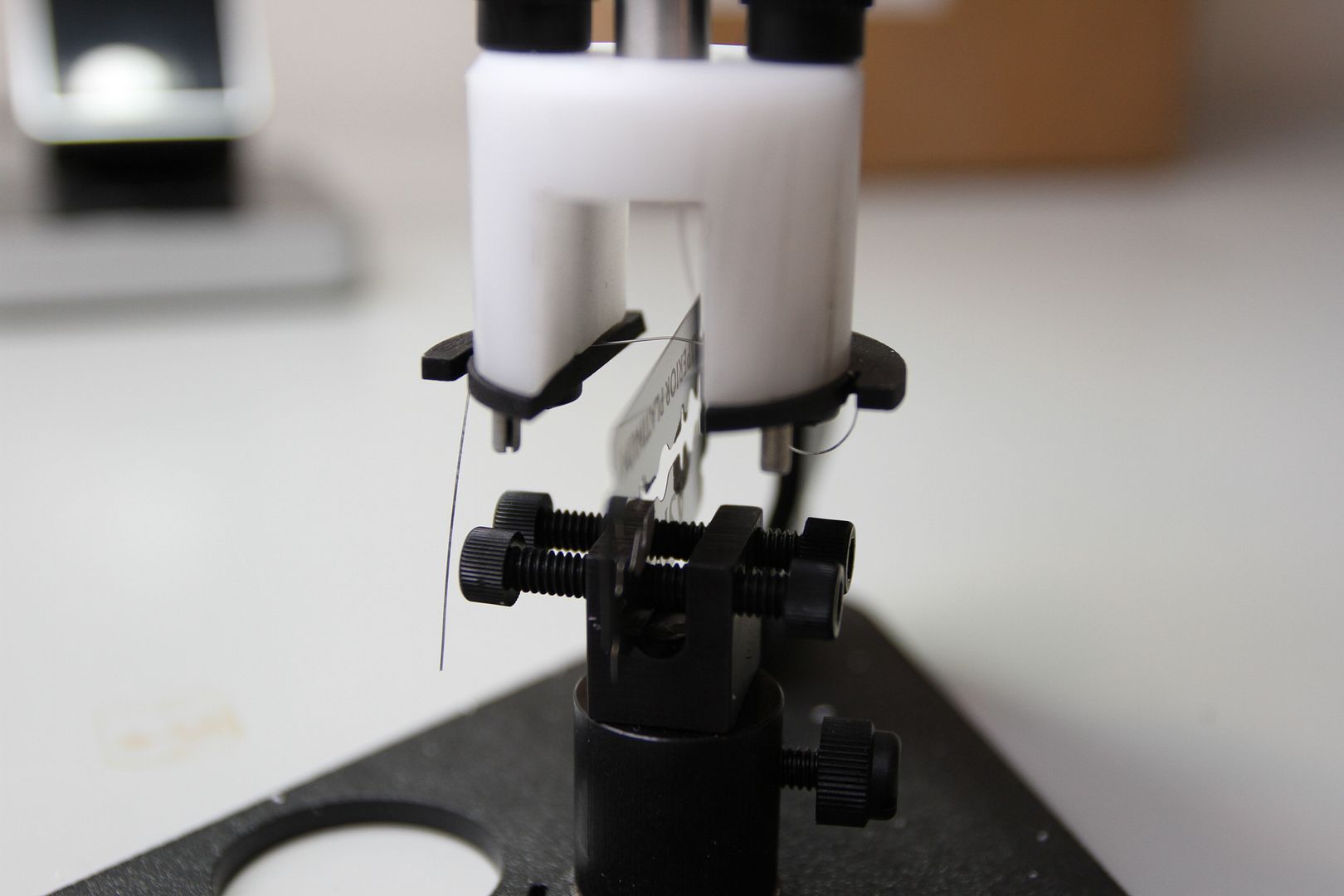

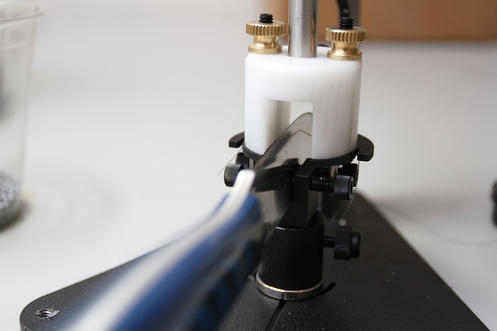

	Ok I can't really figure out what's going on... going to call Mike tomorrow. I would love to see this looked at by someone like ToddS w/ an SEM to make sense of the different readings, maybe I'll send him mine if he has time =)
On all of the progression below I am finishing with edge leading whisper light passes (except for the strops of course, those are edge trailing).
200 grit, edge leading alternate passes - avg. 75 BESS score
Same edge, now stropped on pant leg - avg. 40 BESS score
1k grit edge, edge leading alternate passes - 55-150 BESS score (all over the place - probably wire edge?)
1k grit edge, edge leading alternate passes, stropped on pant leg - 35 BESS score
3um lapping film, edge leading alternate passes for the micro bevel, hair whittling - 90 BESS
3um lapping film, stropped on .25 diamond on balsa, edge trailing alternating passes, passing HHT-4 all points of edge - 110 BESS
Knife tested:
What I don't understand is how I was getting a lower BESS score on a 200 grit diamond edge than the 3um stropped edge... Especially when the 200 grit edge would barely kinda shave arm hair and the 3um edge would sever free hanging hair. pretty confused right now!:concern:
Knife tested:

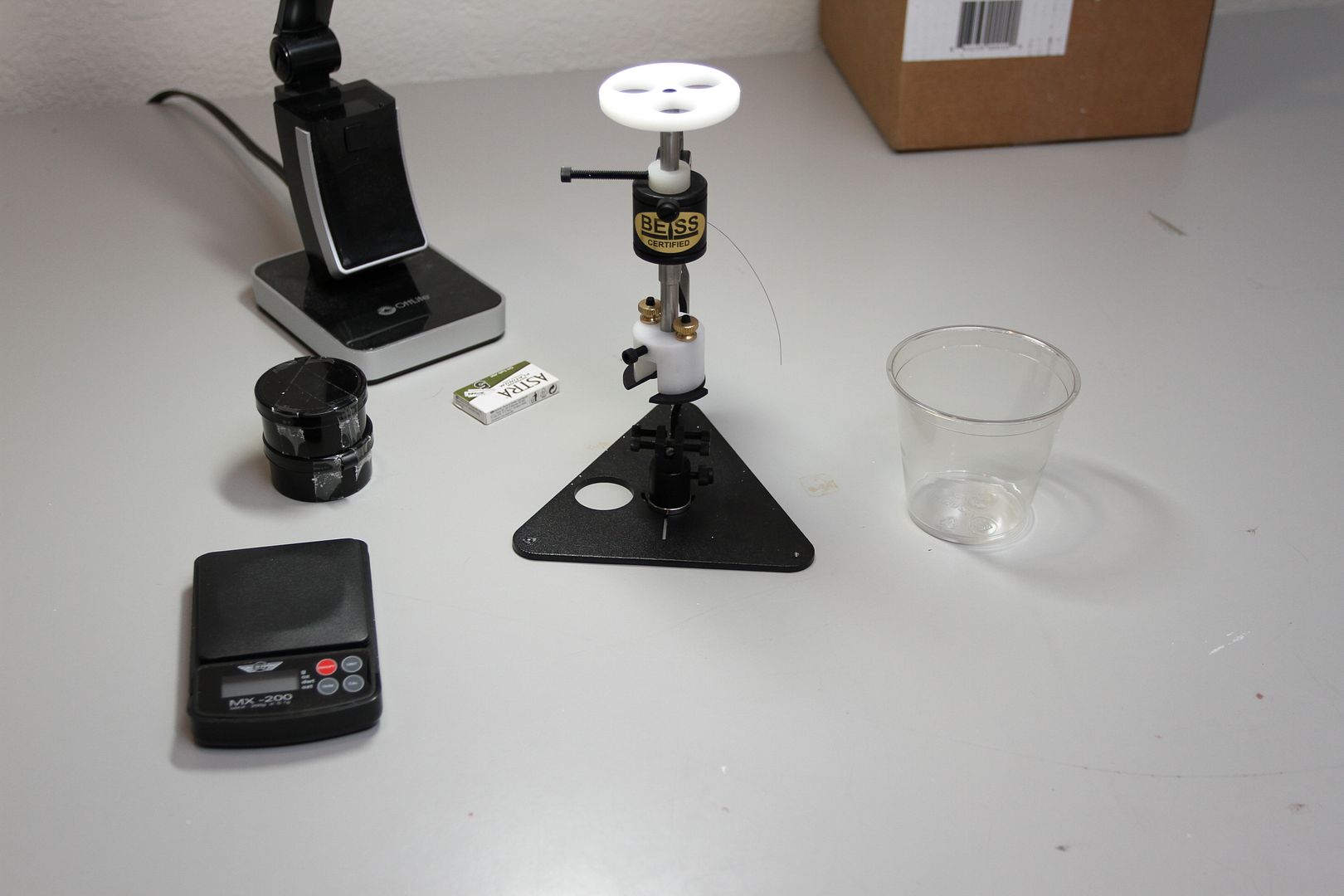

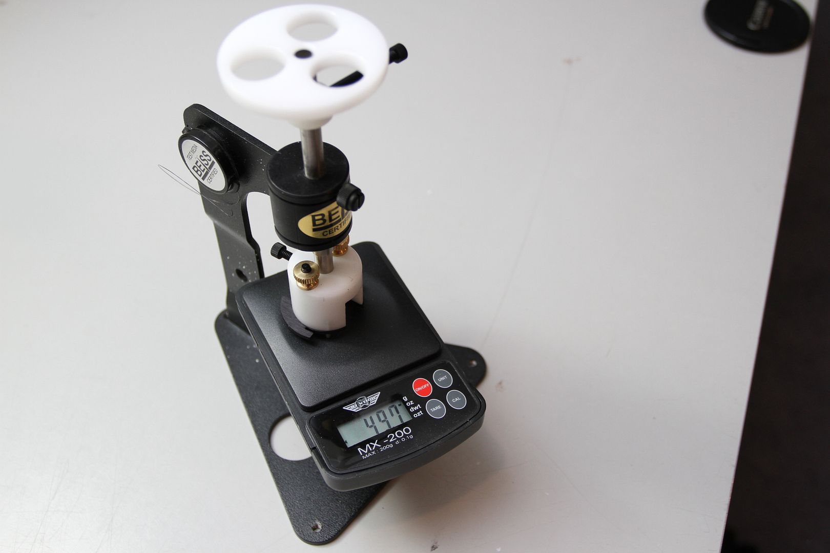

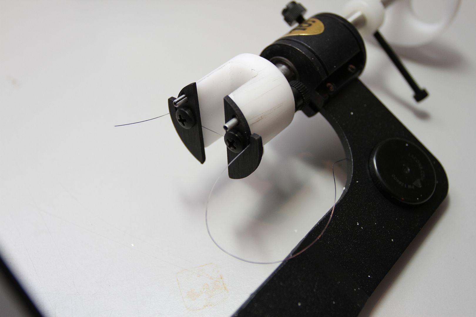

Are you testers able to hold the string tension of the cutting medium constant?
I have not been having significant difficulty with it, I just pull it "more or less snug" with my fingertips as I tighten the second clamping screw. From the repeatability of the results I'm getting and the low standard deviations, I think it's not a problem for me, anyway.![]()
Josh,
I see burr present on the edge and in photo #2 you can see how it has stood straight after being stropped on a pant leg.
You should be able to get the edges a bit cleaner using diamonds, do you do any distressing of the edge? Cork, soft wood, felt block?
Yeah I'm stumped right now... it could be as Dan pointed out above, Clay Allison had pointed out years ago when a similar sharpening jig was built that the peaks of the micro serrations could sever media faster than a highly polished edge.Also looks like D2 or other high carbide size steel. That could be throwing off the results somewhat, but still not clear (aside from wire/burr edge) why that would effect the #s - especially if other test media show a steady increase in pressure cutting. Could be higher refinement but with some micro rounding that shows in the test media and not on hair?
