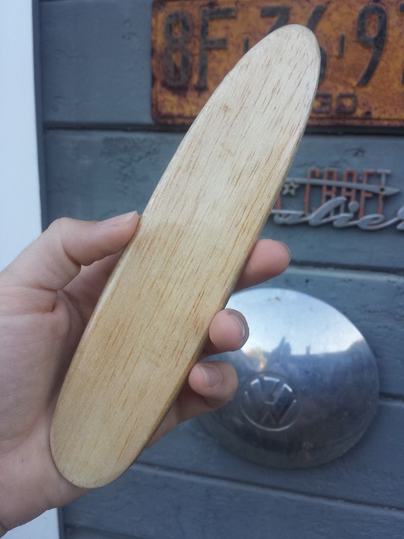

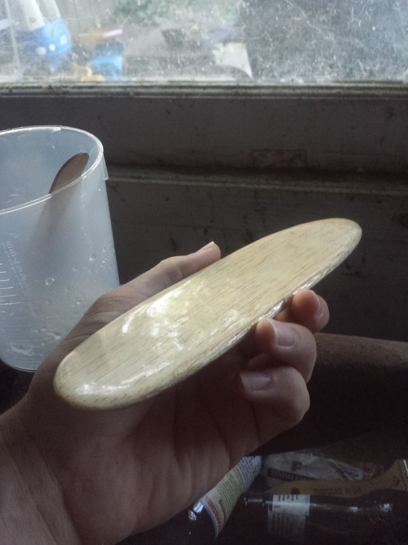

Project, it's done enough to serve it's purpose for my demonstration, a minature long board surf board! I have to give a short presentation on polyester resins that our company sells, one of which is our Surf Board resin. Crystal clear, hard drying, air-inhibited, excellent wet-out of cloth too. So, I sliced up a balsa block, shaped it, did one layer of S-2 glass on one side and a layer of Deck Cloth on the other. Finished with a surface coat of just resin with Suface Curing Agent added to counteract the air-inhibited properties (doesn't fully cure in the presence of air, means no sanding between coats/laminations). Sanded and buffed after just to clean up the finish a bit but it was damn nice as is except for a few runs and drips.
Still needs some touch up around the edges, need to add a fin and some vintage decals to make it look right. But for demonstration purposes, it's done.
Now just to refine my script...

Fast14riot...that long mini surfboard really looks cool. I hope it serves you well during your demonstration.

That's cool Xander! Your job sounds awesome too!
My old roommate back in the USVI had a couple hand shaped boards, they were really cool. We did some nose repair work and stuff like that... got me interested in fiberglass work. I have a scale model of an old school racing boat hull design I came up with somewhere. We'd make cardboard sections of bulkheads just like the drawing then lay the cardboard planks on and glass up! lol It is fun stuff! One of these days I want to make a drift boat, plywood/glass (cold molding) boat building really interests me.
By the way anyone ever go skurfing? It is too much fun, I used to go every day. The boards are an excellent first fiberglass/plywood project.

We call it skim boarding here, lots of fun! Thanks for the props bro, I had a helluva time working with this super fast cure resin in the low humidity and high heat of summer, but I think it came out ok for now.

It looks awesome, X!

Hey duuuuuuudes. That mini surfboard looks pretty cool, X. Now make a full size board! haha
