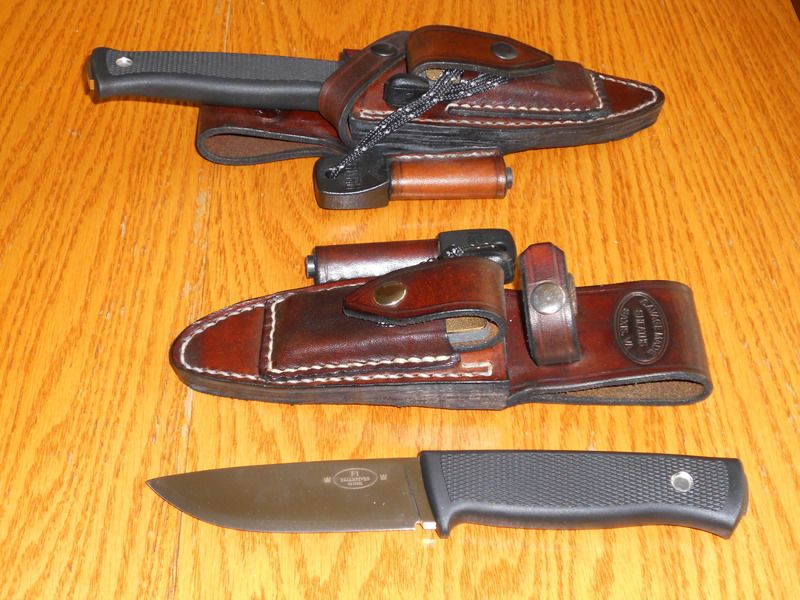

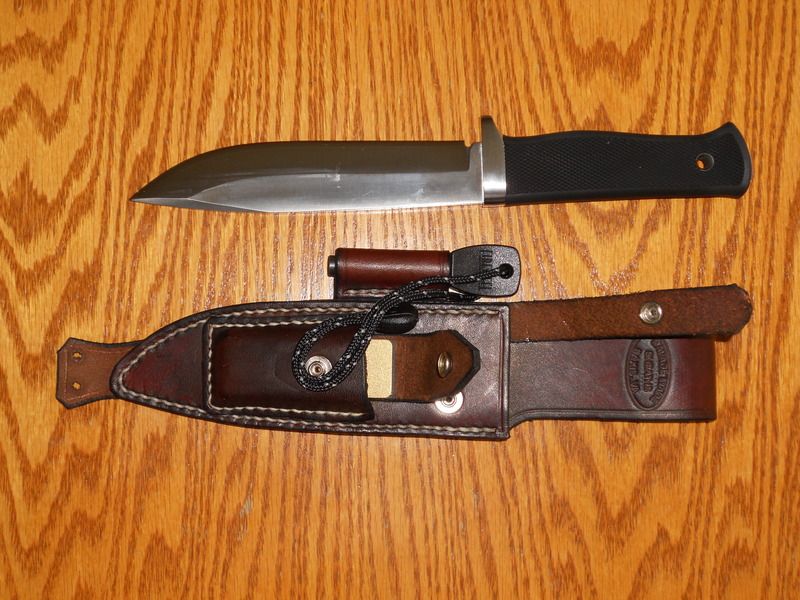

Here's more of Harry's work. S1 and F1.

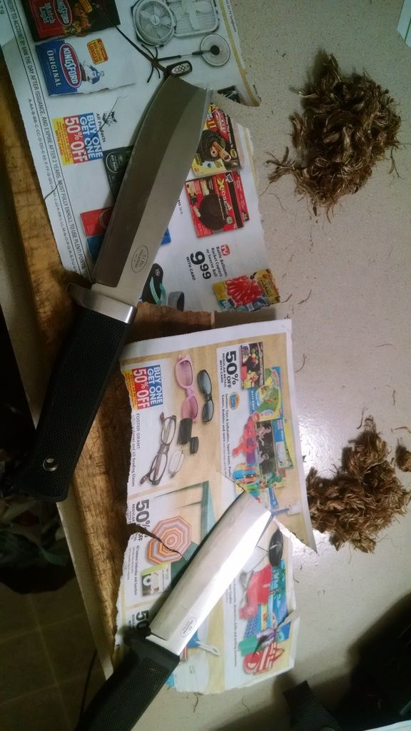

Cobalt Special (CoS) versus V Gold 10 (vg10)wear resistance
Cutting 3/8 manilla rope on a cutting board using the belly/tip area on each blade in a draw cutting saw motion.
Both knives were at equal sharpness after honing on a king 6k stone and Bark River White compound
They were both tested on newspaper
Making clean cuts without snags.
The edges were checked every 5 cuts.
The first 5 cuts removed the ability for either knife to cut without a snag.
At 10 cuts CoS was showing a very slight advantage but was still cutting with snags like the vg10
15 cuts in and vg10 became very difficult to cut the Manila rope and would no longer scrap shave.
CoS continued to shave until 25 cuts and became difficult to cut rope at 33 cuts.
For reference,
The Kabar BK 2 1095 crovan only lasted 5 cuts and would not shave. Then it was very difficult to cut the next 5 for a total of 10
Most
Interesting is that CoS was more response to stroping the Vg10
While neither returned to the sharpeness before the test it took fewer pass for CoS to return to hair shaving sharpness.
This is only my first test. I'll need a few more to confirm.
I'll post a video later

Thanks for the edge retention info DeadboxHero. I try to never to speak in absolutes, that one steel is "better" than another but it seems that Cos is superior to Vg10 in every way, other than cost. I might take my A1pro, new Benchmade Arvensis and Busse Ash 1 in the back yard today and mess around some.

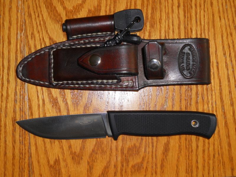

I just received my Savage Made Sheath for the A1 Pro. A perfect fit. If anyone is interested you can send Harry an email found on his web site. Mine was $60 + $7 ship. He charges me an extra $5 to add the firesteel loop so without that you're looking at $55. He makes each one to order and turnaround is very quick. I cannot recommend Harry's work highly enough.

nice test, thank you
Thanks brother :)
Much appreciated. Keep 'em coming.
Will do, when I love something, I love it to death! Haha
http://www.savagesheaths.com/
Wow, at a great price too. I love the stone pouch.
Thanks for sharing bro :)
Ur welcome bro! :)
The photos don't do it justice. They make it look sorta reddish and uneven when it's actually dark brown and very handsome. I consider $55 for a sheath of this caliber a steal. Harry is a true craftsman.
