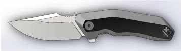

Just for some creative criticism from a designer’s perspective....
Without knowing the overall size, the blade looks very ‘tall and squat’. It’s not a bad thing per se’, but if the blade is 3” - 3.5” or so, it looks like it would feel very wide in the pocket (similar to a Manix 2). If the overall height isn’t that big, looks like the blade would be only around 2.5”. But this could just all be optical illusion, especially with the drastic angle on the tanto.
Either way, the blade ‘looks’ a tad too squat aesthetically for my preferences. But there is definitely a market out there for the overbuilt chisel look, and those that like it would eat this up.
Stretching it out definitely makes it look better, with a more usable blade shape. I know this probably varies quite a bit from your ideal for the knife, but I see this as a much more user friendly design.
The drop point makes a world of difference in this, from a usability standpoint. Has a bit too much belly for my taste, but as tall as the blade is, it kinda forces the belly size. Would probably make a great skinner at 3.25”.
Just to echo what a few others have said, a design - any design for any product - really needs to have some thought process to its purpose. There’s a design principle known as Gestalt (German word for form or shape), in which “an organized whole that is perceived as more than the sum of its parts”, which in Industrial Design boils down to form follows function. So while your knife may have sharp edges, and be physically able to cut things to one degree or another, without any thought to it’s end function, it may not do it well, or comfortably, or easily. If you design it with aesthetics in mind, first and foremost, it becomes more of an object of art than a usable tool.
A chef’s knife is shaped the way it is for a reason. You don’t see many tantos in a kitchen.
Good camp axes all have a similar basic shape that works well. You don’t see many hawks chopping wood.
A Delica, Griptilian, or Buck 110 are all great EDCs because their blade shapes are all versatile for, and lend themselves to, a myriad of uses - a Jack-of-all-trades if you will.
I think this is what people are getting at. They don’t see your blade shape as lending itself to any particular use, and are having a tough time seeing any versatility in it either. They can’t see any function behind the form. It’s ok if it’s just meant to be pocket jewelry, or to sit in a collection, as there is a place for that as well - if that’s its function. But usually, an object with that radical of a shape, has a very specific function it’s designed for.

^This. You have to think about the intended context of use. The how/when/where/what/why of its intended applications, and let those factors dictate the build of the knife for you. Aesthetic elements should come only after that stage. With information regarding the intended context of use not forthcoming and the design itself not showing any clear signs of considering such factors, it gives the impression that the design has been designed mostly to look neat. The question is not whether or not the knife can cut stuff--making a knife that can cut stuff isn't particularly difficult. It's another matter entirely to design a knife that will excel in its intended role. :)

I 3D printed the design, ergonomically, it's good, there are a lot of things like action and related to it opening and closing etc that have been taken care of at design or will be controlled during production. Here's it beside my sheepsfoot a Spydie Tenacious and a Steel Will Cutjack.

So I'd love if I get some constructive criticism instead. What makes this design gas station or non functional or outright useless to some?

It seems like a lot of handle for a little bit of blade. It looks like it would excel as a gasket scraper type of utility blade, but it would be too thick to make a good cardboard cutter. it's kind of in limbo between a utility knife and a (more or less) single purpose knife.

What is its function? And not just "to be sharp." As a slicer, it is too thick and obtuse. Its a folder so it doesn't chop. It looks pointy so it might penetrate.
Is that what it is for? It might function for that. Except that we, and most importantly you, know nothing about how ell the lock will function. And I am not stabbing a folder with a mystery locking mechanism.
How I would change your tanto knife.
1. Lose the tanto blade or offer another option. I prefer straight back, drop point, or wharncliffe/sheepsfoot.
2. Like Danbot said, maybe 3/8s inch more blade. The blade to handle ratio is off to my eye. Blade looks a tad short.
3. I'm in the minority on this forum when it comes to spending $ on a blade, but I tend to stick to $150 and under on a blade. $150 got me a PM2, ZT 350, BM Bugout, etc. Those are fancy enough for me. I understand I will never own a Sebenza, midtech, custom, etc. I'd rather put $ toward a handgun or AR build. Your normal retail is out of MY price range. Which means I would appreciate a D2/VG10 + G10/micarta version.
4. I never got on the Ti or carbon fiber handle bandwagon. I find them slick. I'm a G10, micarta, or even FRN is fine by me.
5. Where it is produced doesn't matter to me as long as QC is being followed. Bad crap can come from anywhere.
6. Put some thought into the pocket clip. I don't recall seeing a pic of it. Not too long, not too short. Keep it simple and preferable adjustable for tip up and tip down to keep both camps happy.
I also like the thumb ramp. I'd keep it.
I also understand you won't be able to manufacture a ton of options at this point. But you did ask ... :D
Good luck on knife!

Thank you. These are great points.
1. A lot of people actually like the tanto so I'm keeping it, I did try another option like one of the images posted with a thinner profile and bigger belly but 20 odd people I asked, preferred the original. I'm doing this drop point version too.
2. It's hard to increase the blade without increasing the handle since it sits inside with 2 mm to spare before hitting the pocket clip. I don't know how others manage this, something I definitely need to learn.
3/ 4. The sheepsfoot I did comes with M390 and a liner lock variant with Micarta or Cf/g10 hybrid scales. Retails at 175, $50 off on pre order. This is a framelock with cf inserts so i'm not doing a liner lock variant unfortunately.
5. Tuya actually does a great job, you can see the Hive or kingsman reviewed by a bunch of youtubers. I hope they do a similar or better job with mine.
6. This is what the pocket clip looks like
Thank you for the feedback. I hope I can improve aspects of it that as I design and learn.
