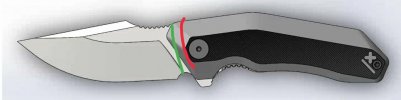

Feedback on my Tanto design
Lemme show you some of my technical drawings of your knife real quick.
If you pulled back your scales to the red line, you could angle the plunge line to be more vertical which would do 2 things:
A) make the blade look longer
2} reduce cutting resistance at the back of the blade
iii) also make it easier to sharpen
I also might reduce the height of the harpoon bit on the top of the blade. It would make it fit better in a pocket and make the blade look sleeker and less chunky
Oh, I do like the drop point version. :thumbsup:
The pocket clip looks fine too.
Unwisefool makes a good point, maybe cut back the handles some. Somewhere between the red and green with a slight shift toward the red line.

I 3D printed the design, ergonomically, it's good, there are a lot of things like action and related to it opening and closing etc that have been taken care of at design or will be controlled during production. Here's it beside my sheepsfoot a Spydie Tenacious and a Steel Will Cutjack.

First and foremost, I don't find the design to be "gas station" at all. When I think of gas station knives, I think of overly garishly designed, and cheaply made. Cheap Mtechs come to mind.
From a basic design standpoint, I really have no issues with the drop-point version. It has a lot of belly to it, which I'm not a fan of, but that's more of a personal preference, and not a design flaw. Like I said in my first post, it would probably make a great skinner.
Also, the hump-shaped handle is a bit of a turn-off for me. It looks fine, but I prefer a smoother, continuous sweeping arc. I've never found a hump-handled knife that sits correctly in my palm without creating a pressure point. But agin, this is really just a personal preference.
Seeing it in prototype form, I will say, I like the thumb ramp on the spine. In your pic, it looks sized appropriately to really get your thumb locked into it.
My main sticking point is still the tanto blade itself.
First, it looks out of proportion visually. I'm estimating your blade to be about 3.25", but visually it appears much stubbier. When open, it doesn't appear to have any visual balance.
Aesthetics aside... assuming that same 3.25" blade length, this puts your primary edge at only around 2.25".... pretty short for a knife this size. It doesn't leave a lot of edge for longer draw cuts, skinning type motions, or slicing cuts. It seems like your would have to saw back and forth with this blade to do even medium length cuts.
This also puts your front edge around 1" and at a 45° angle. This would be great for chiseling, scraping, or possibly scoring material, if that was the knifes primary focus. But it doesn't put enough point on it to be much of a piercing type of tip - something tantos usually do well at.
Like I said in my previous post, as a general purpose, Jack-of-all-trades knife, it seems like it would be awkward to use as an EDC, since it's not doesn't appear very versatile. At the same time, it doesn't appear to be designed with any singular purpose, other than to meet a specific aesthetic. The blade shape just seems kinda lost.
Some changes I would consider to make it more versatile:
1 (red) - adjust the angle of the harpoon a bit, moving the tip down further. This would allow you to keep the front edge at a very chisel like angle, while adding a bit more length to the primary edge
2 (green) - lower the top edge a good bit. This would allow more angle on the front edge, creating more of a piercing point, while still adding some length to the primary edge
3 (blue) - roll the angle between the two cutting edges into a bit more of a 'traditional' tanto shape. This would still give you the front chisel to some degree, but allow material being cut to transition easier from one edge to the other, and extend the length of the primary cutting edge.
Just my thoughts.
Just my thoughts.
