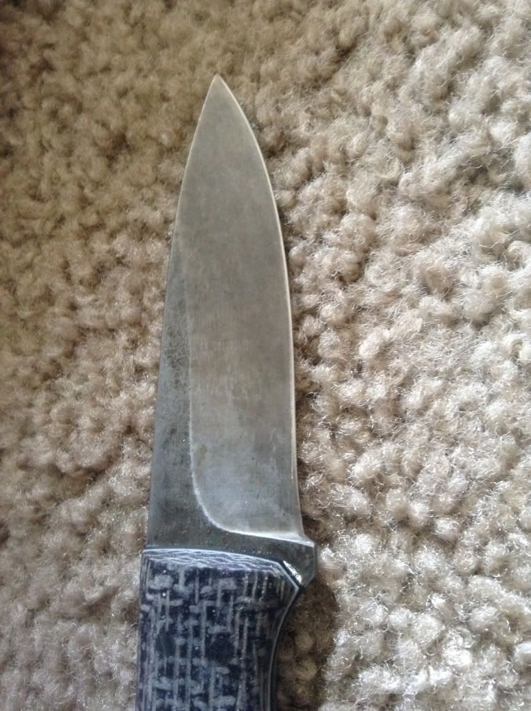

I've had some solid results with mustard on O1 and A2; usually some dijon, a q-tip, and time will yield some really nice results and not to mention a solid protective patina. I did this on my bushfinger and have been happy with both the aesthetics and corrosion resistance afforded by this quick & easy method.
I just use good ol' French's mustard and a q-tip as well. The trick is to apply it and wipe it away leaving the vinegary film/residue. That residue as well as oxygen is the magic stuff. If you leave the mustard glopped on the blade, oxygen can't mix with all the other elements and cause the chemical reaction that is patina. The only chemical reaction I get (by leaving a thick coat of mustard) is rust IME.

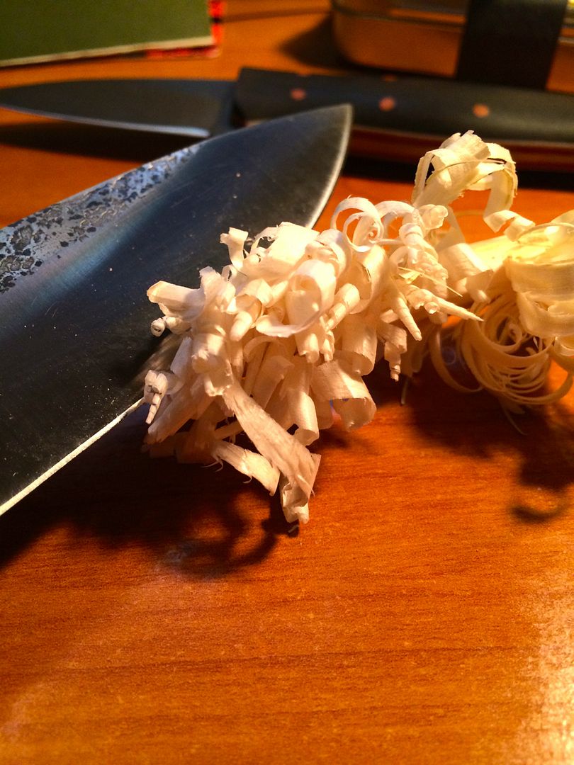

Food is probably the best way to get the patina going. But being a father, when I prep food, I'm in production mode. It's a little difficult slicing (rapidly) a bunch of veggies and such with an 8" long 5/32" thick recluse. Now a Woodsman might be better in the kitchen.
