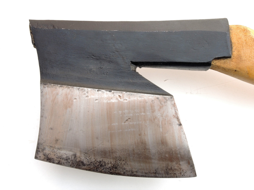

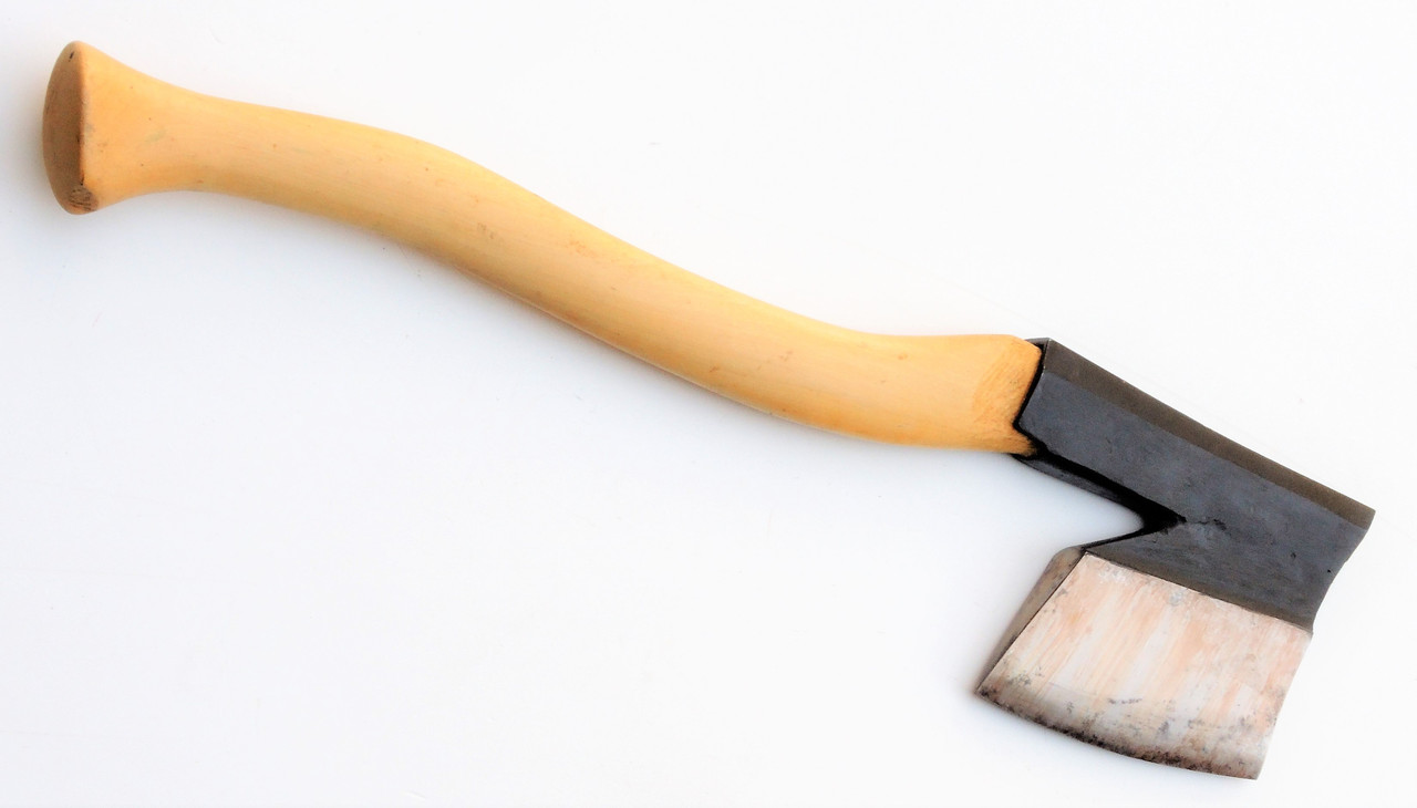

Nice job, but just in case you are not aware, this type of thick blade Piilu-axe is not actually meant for squaring logs even though it can be done with it like you show. Better suited Piilu is long thin blade and often with asymmetric sharpening. For example Billnäs 30.1-30.3

Thanks for your conformation tiikeri.
Wonderful axe,Veeteetee,thanks for those pictures.
