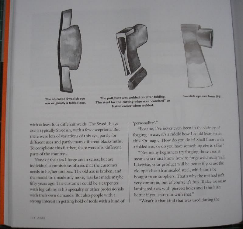

How did they forge such a long eye at billnas? Did the billet start as a large "L" shape followed by punching the eye with a drift and drawing out the bit? Also, did the just weld on the poll?
Its a "butterfly" type forging process. If you look eariler on in this thread, you will see a couple drawings, basics of the forging this style axe.
In the more modern process,yes,pretty much so(i've seen a step-by-step from the Billnas factory,it actually may've been posted above too).
But originally,since the pre-industrial times,just like Lieblad says(T-shape drawn from thick strap,then folded along the long vertical median of that T).
Again,above,should be a video "Wira factory,1926",just like that....

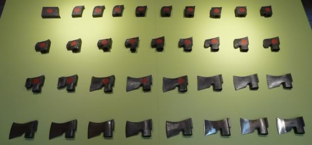

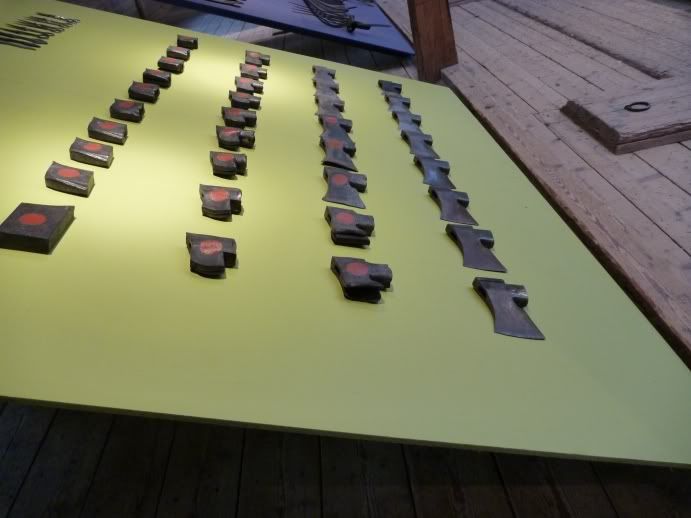

Another insert bit montage of Finnish axes:
These are from the Kellokoski forge I believe.
I know the first one pictured is Swedish but it made me think of your question. Someone with firsthand knowledge already explained what is in the pictures but the beginning shape looks square/rectangular then to the “T” or “L” shape.
