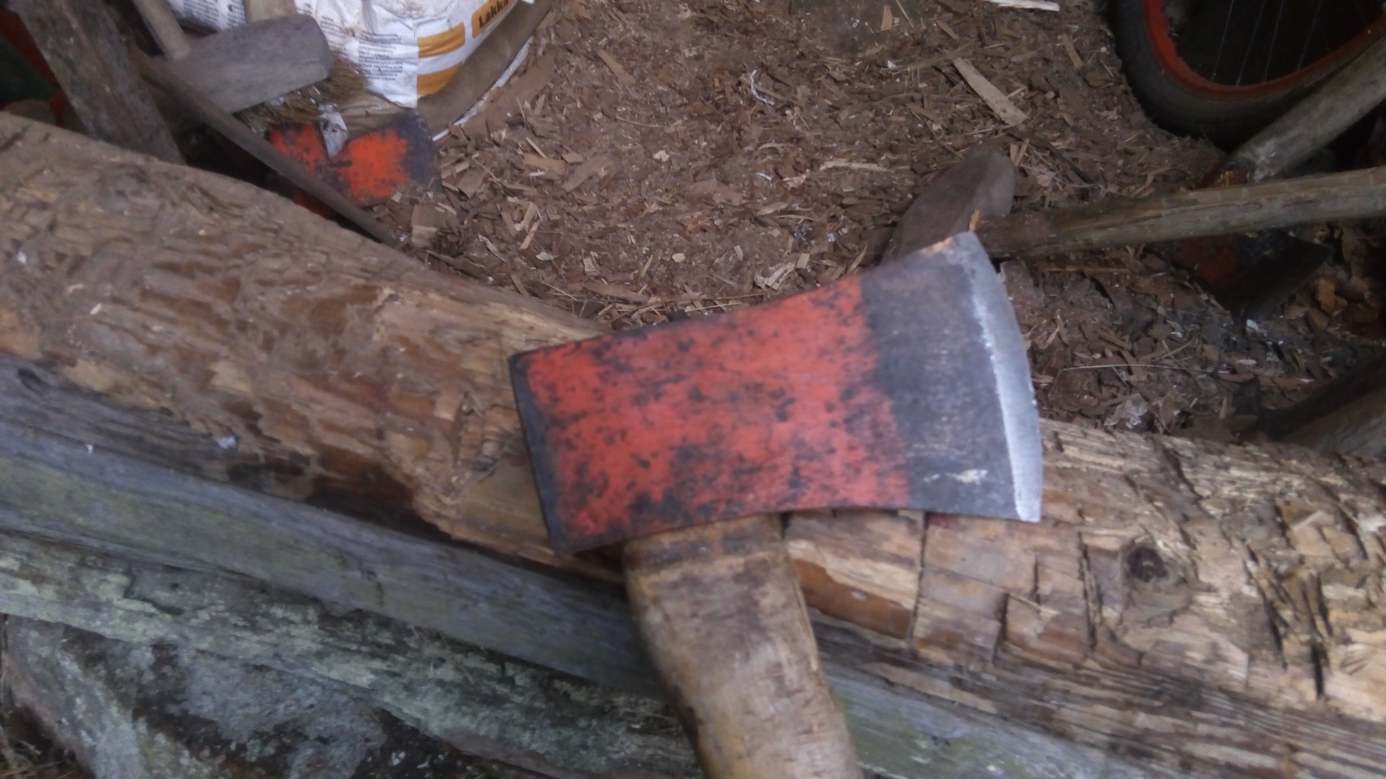

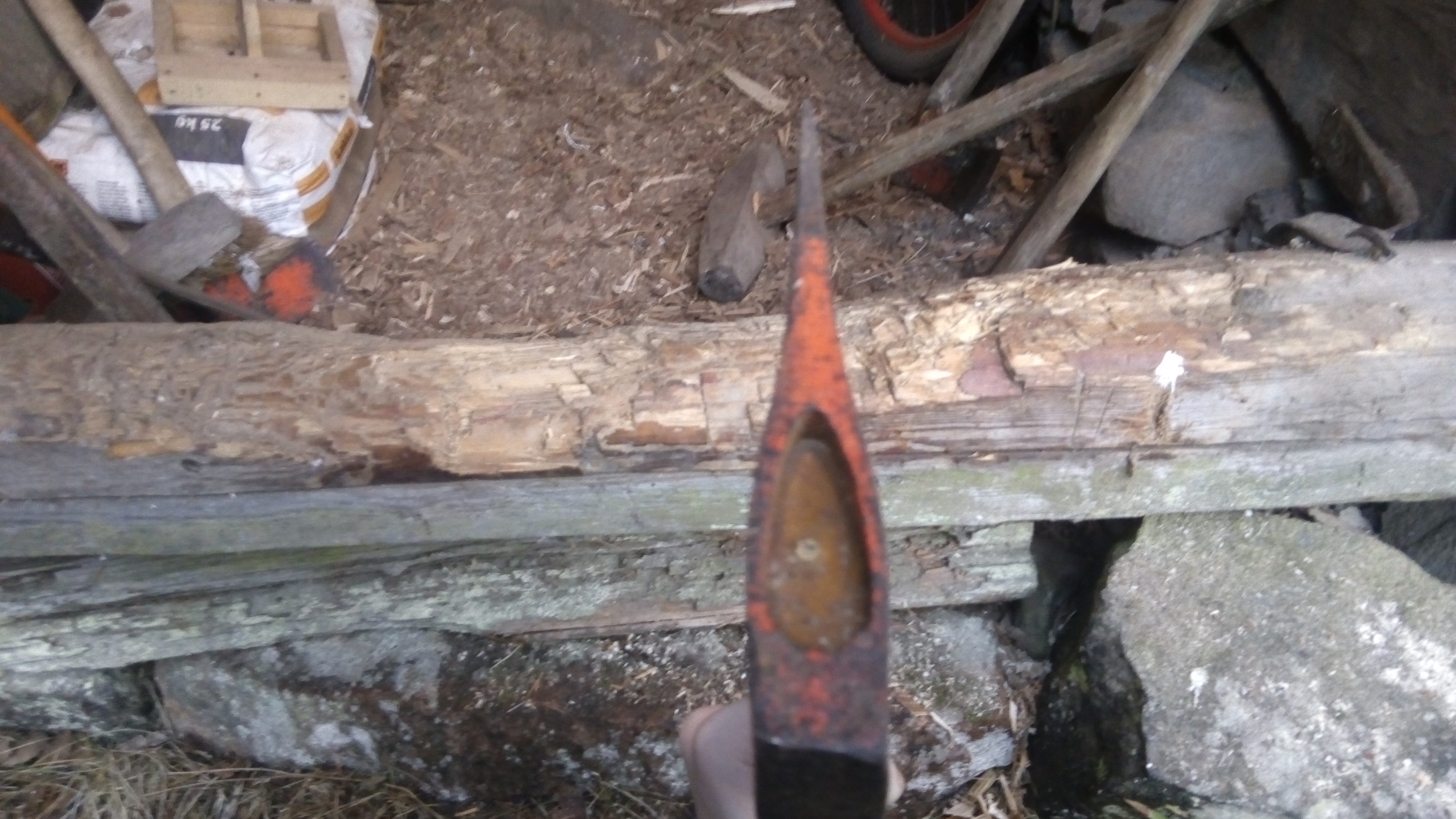

That head he is hanging in your screenshots really does has a pretty good-sized conventional eye that can handle two of those snakehead wedges. Wouldn’t that be a lot of hickory to fill that if that was the intended handle material? Can’t picture two of those going into the eye of the traditional socket style axes – one yes but two seems like it would end up a mess.
The pattern being more Americanized reminds me some of the axe at Olli's cabin:
So i went to our familys summer cottage today and took pictures of the Billnäs made American felling axe. Its called the Ohio pattern by Billnäs but since im not quite familiar with American style axes i dont know if this was something invented by Billnäs or if there really is such thing as Ohio pattern axe.
I would think his was an American axe if I wasn’t told different – at least compared to that one being hung in the video.
Also, I’m curious about whether the epoxy can help date the axe more or less?
