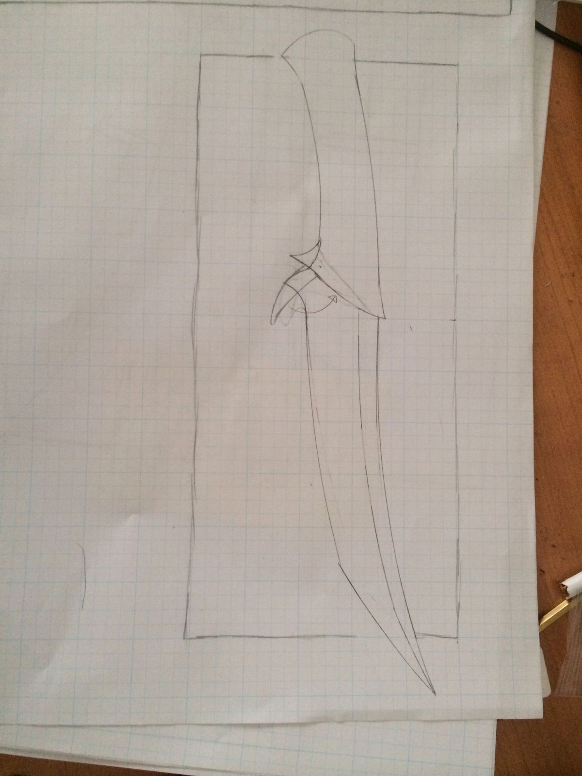

Ok got it on paper still working out a few handle ideas but liking the blade shape and size.

Quick question. Ever since you mentioned having a knife that could do all you wanted in the woods I had the idea rolling in the back of my mind and came up with a couple ideas. Have you thought about making a mechanical gut hook by means of a curved piece of metal that dropped down by the ricasso and bringing the ricasso down to almost a second point with a bit of a curve?

I put a guthook on my bush/hunting knife I did a couple of years ago. Just on the back of the blade... It works, but not as well as my stand alone Gerber zipper. I have thought about making a matching pair of knives. Hunter/camp knife with a small utility/guthook blade with a more T shaped hande. Are you talking about grinding it into the ricasso or actually having a fold out blade near the handle?
I'll sketch it up in the morning... Or rather after noon now. Gotta love working nights lol. But I'm basically looking at the guy hook design as two parts. The usually straight inner unsharpened side and the somewhat curved cutting edge. But for ease of use making the unsharpened part fold away into the front of the handle or slide along it.
Without some practice and skills, that handle you drew will be hard to fit on the nakago ( tang).

If that is just a ricasso in the drawing, it will be no problem to do. Some people call a solid ricasso made to look like a habaki a "faux habaki".
If it is a habaki ( blade collar) then you will need the skills and tools to make one. It isn't hard with the right tools, but it isn't a beginner project.
If you decide to make a hidden tang handle ( best idea), or even a full tang, here is a trick for getting it perfectly shaped and sanded:
Fitting the handle up against the tsuba ( guard) on any knife can be difficult. It is hard not to scratch up the guard, and the handle almost always is poorly shaped where the two meet. The trick is to make and fit the guard, and then set it aside. Make a second guard out of masonite. Micarta, or wood. It does not need to be shaped like the guard, just fitted to the tang right now. It does need to be the same thickness as the guard, or a tad less ( but no more). Place the "work guard" on the knife and fit the handle block to the tang. Once it is fitted, and any holes are drilled, start shaping it. You can wedge a few strips of paper in the guard slot to hold the handle in place, but what I do is make a temporary wooden pin ( mekugi) for the handle and put it in where the pin(s)/rivet(s) will be. This keeps the handle and guard snug and allows shaping of the handle. Just shape the work guard piece to match the handle...don't have it stick out any. This allows the handle to be fully shaped and sanded until it is done. If applying a finish, you can do that now, too. Once the handle is done as much as you want. Carefully knock out the wooden pins. If they won't come out because of the finish making them stuck, carefully drill them out with a drill bit or Dremel tool burr. Remove the handle and place the real guard on the knife. Put on the handle and check the fit and alignment of the pin hole(s). If all is well, you can glue up the handle, install the pins, rivets and finish the knife. If the handle is a tad too snug, carefully file the end to make the pins align with the holes. If it is too loose, make a thin copper (or other material) spacer to go between the handle and the guard. This spacer is called a seppa.
Thank you bladsmth I was thinking something like a metal guard like you mentioned or the para cord wrap. My only question with the para rod is I've seen some where it looks like it's built up to almost a ball before the blade and was wondering if that is all wrap or if there's something underneath I'm not seeing. Thank you again I'll probably go with your idea of a pinned handle and guard. On a side note what would you recommend for a sheath. Not a big fan of leather and kydex seems like a royal pain.
Here's the rough idea Eric. My thought on it is having the gut hook on the bottom like that and relying on the last 1/2" or so of blade keeps it both unused except for gutting and allows the knife to go back to full function after your done . The end in this I was thinking if it's possible and doesn't cause issues in ht could be used like a fillet knife. Once again just an idea.
