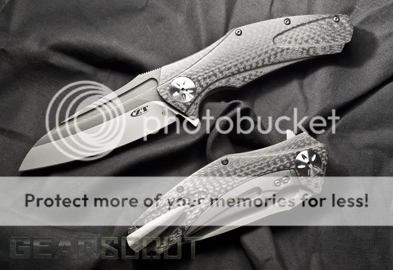

I will definitely be picking up a 0777. I have one preordered, and if that falls through id probably still pick one up second hand at an inflated price. It looks like a ridiculously sexy knife.

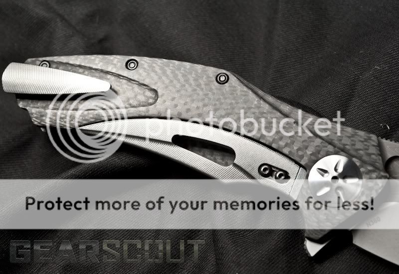

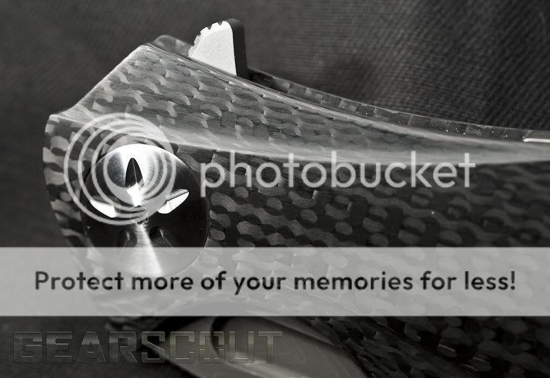

At first it seemed like a production grail knife to me. I love so many aspects of design, the handle, the new pivot system kershaw is using, and the size while still remaining light. I wasn't sure what N360 was but I was sure it was something sexy.
After keeping up with everything, I will admit I am a little uneasy about the steel choice. I do think it will still be a phenomenal blade, but it wasn't what I was expecting.
I don't abuse my folders, and I've never had issues with toughness on a folder's blade. So there was no need for me to desire more toughness in a folder's blade. I do abuse the hell out of fixed blades, but that's best for another thread.
The biggest performance desire I have in a folders blade is wear resistance or edge retention. I use a folder on light-medium task everyday, and probably the majority id classify as light cutting task. It is merely my personal experience for this to be true, and it would be a hasty generalization for me to assume that everyone uses folders in the same way.
I own a few ZT knives, and so It makes complete sense that the blade steel would be geared towards toughness given a simple glance at the rest of their knives. Zt is known for their beefy indestructible knives that can take a bullet, get ran over by a tank, and then get ready for the hard stuff. (exaggeration, but not much)

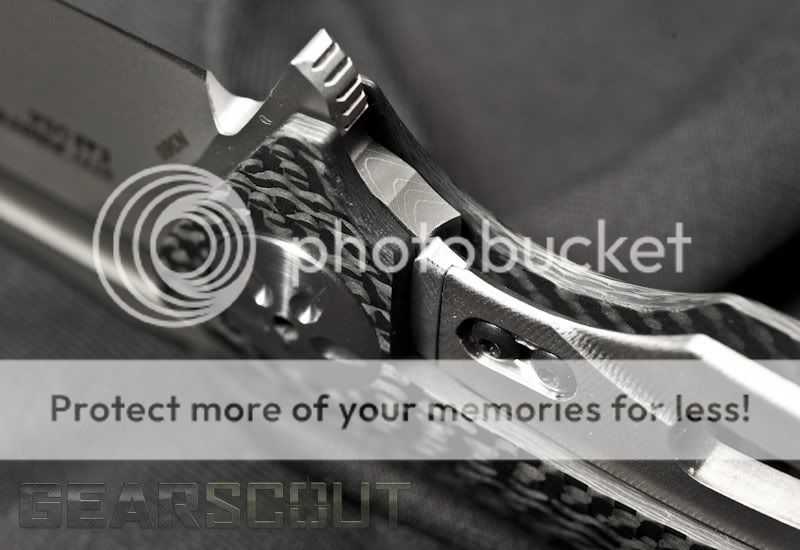

What confuses me though, is the incorporation of damascus. Don't get me wrong, I love the dama and was immediately drawn to it. I see dama as more a luxury on knives. Not a ton of performance, but it looks dama sexy. However, if this is supposed to be a blade for toughness, why dama? Also, since the spine is the thickest portion of the blade, that seems like the place to put your tough steel in order to endure any lateral forces, and the more delicate steel on the edge. I guess the two materials just seem out of place with one another based on their purpose.
The thing you have to remember is that knives like the 0777 are made to make a big impression.
You are supposed to be completely blown away when you see it. Materials choices are not always based on practicality.

N360 seems impressive enough in its own right, but I'm not sure this is the right knife for it. If anything, my concern is that the damascus spine negates the added toughness and corrosion resistance. Also, I suspect heat treating for a higher hardness range would be impossible due to the damascus spine, which may react differently in a detrimental manner if a higher hardness is attempted. That said, if N360 is truly tougher on a level approaching CPM-3V, I would definitely like to see it in a much larger knife like the 0100. A true stainless chopper is a survivalist's wet dream that would make Jerry Busse jealous.

Wow I was just lurking around here and saw the 0777 for the first time. Amazing.
I can't see how the choice of n360 would negatively affect my reaction to this knife. It looks to be an exceptionally tough steel that would hold up far better to unforeseen abuse than some other super steels. It's a hot new steel, shouldn't it go on the hottest new knife?

Again, the damascus spine might affect whether or not that can be done. In fact, it might very well be the choice of damascus for the spine that led to the choice of N360 steel, as both the spine and edge steels need to have compatible heat treatment temperatures.
