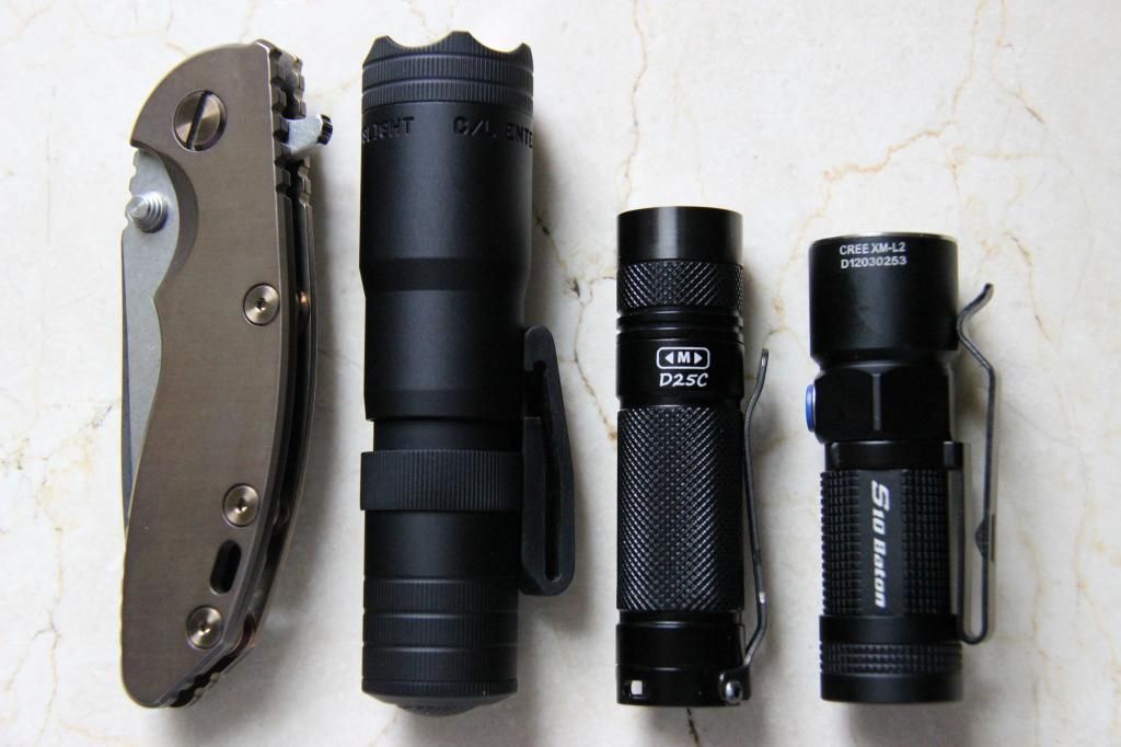

N2K.......I prefer small powerful lights with a single CR123 battery.....but I definitely seem to be the odd man out with these.....
1. Eagletac D25C Clicky - 453 Lumens......fully featured (tiny in the pocket)
2. Olight S-10 Baton - 400 Lumens......fully featured
3. Lenslight Mini - 330 Lumens
None of these are high-end lights......but I have had no issues with any of them and the batteries last quite a while.
Beside a 3" XM for size comparison.....
