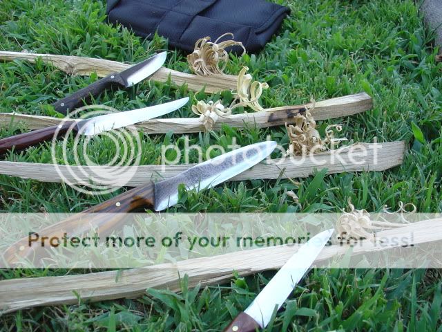

hahaha, ok ok here is a teaser pic. I will get the rest up with a review as soon as I have more than 5 minutes to sit down and do it.

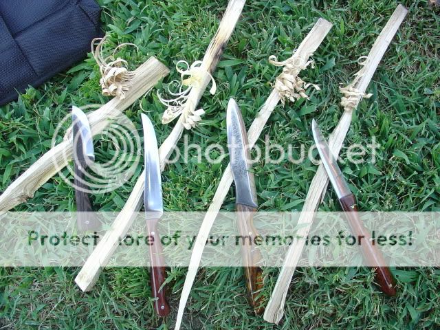

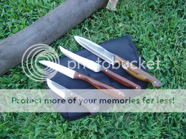

Here are the four knives I played with (minus the folder).
I started them off in the kitchen with some potatos. The all did an acceptable job. The edges on the file knives I think are a bit too thick to do any fine slicing work , but the other two especially the wharnie were great at slicing. The Wharnie made really thin uniform slices. The upswept knife did nice thin slices as well, but it was a bit more difficult to keep them as uniformly thin as the wharnie. The file knives pretty much chopped their way through the potato. The larger of the two sliced ok, but having such a thick edge made it difficult to keep the slices thin.

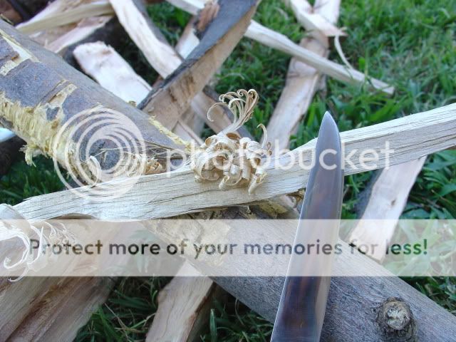

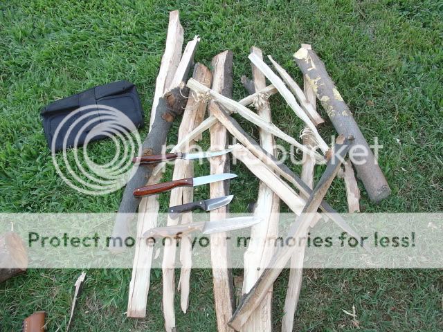

Next I took them to the yard and got out some split wood leftover from another passaround test. I went to work making some fuzz sticks. All of the knives did good job at the fuzz sticks. To my surprise the thicker file knives did just as good of a job as the two thinner blades. Again the Wharnie impressed me the most with fuzz stick making.

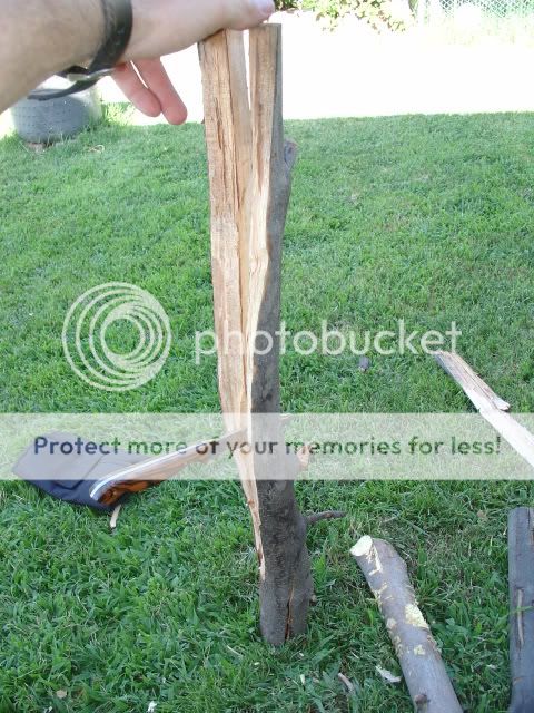

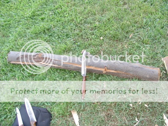

Time for some heavier work. I got out nice sized branch from the firewood pile and went to work on it with the large file knife. This knife is a tank and went through the wood without the slightest problem.
The edge on this knife is way too thick for my personal preference and I believe that had a lot to do with its cutting ability. I tried some cross grain battoning with it and it did ok. The thick edge did not really bite too deep in the wood. With a thinned out edge I think it would have breezed through cross grain battoning just as it did with the grain.

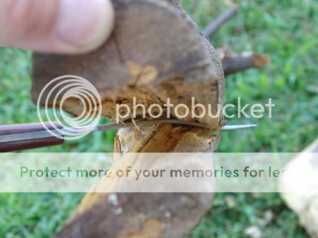

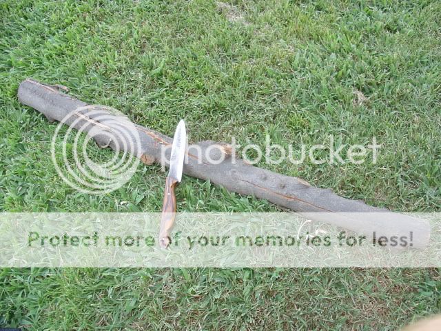

Now for the upswept knife. I chose to batton this one because it seemed to be the sturdier of the two thin knives for this kind of job.

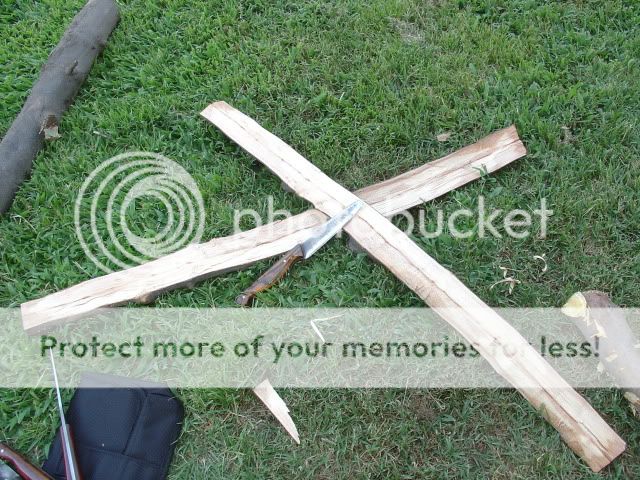

It was cruising through the wood just fine until it hit a pretty hard section with a twist in the grain…….and well you can see what happened :)
Although the blade did bend , IT DID NOT BREAK! Which mean the heat treat is pretty decent. Good thing too because at that moment I realized I had not put on my safety glasses….that could have really sucked had it broken and I had no glasses on. Like I said, the knife was doing a fine job of battoning until it hit this hard twisted spot.

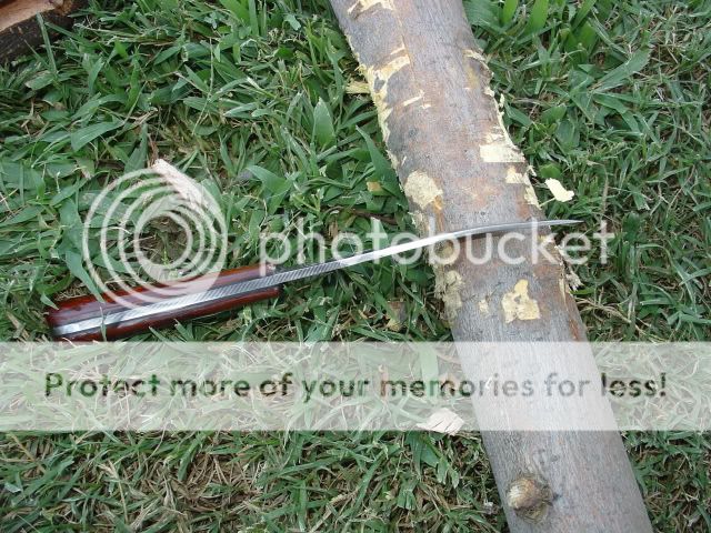

A few more pics of the carnage.

I enjoyed the time I had with the knives. I thought the thinner blades much better suited for kitchen work, though they can hold their own for heavier work. I found all of the knives quite comfortable to handle. Not hot spots when using them or blisters. The small file knife is a great little blade. I like the handle a lot, though I think it is a hair too thick at the base, and maybe could stand to be rounded out a tiny bit more. They were not super sharp when I received them so I did my best (which is not that great) to sharpen them up before and after I played with them. The Wharnie and the small file were pretty dang sharp when I got them and seemed to hold their edges quite well, though they did not see any hard work. The other two blade sharpened up ok, again I’m still getting the hang of sandpaper sharpening so I don’t blame the knife. They too seemed to hold their edges ok. As far as the folder I did not handle it much as it is just a prototype really. I did not care for it too much, it seemed fragile to me and I would have second thoughts using such a blade for much more than desk work. I will say that the looks of the fold did not appeal to me, the handle is SUPER comfortable, which I did not expect at all.
My biggest complaints are really just that some of the edges are a bit too thick and I think the file teeth could be taken down or removed completely. I say that just because when battoning the file teeth made me work a bit harder to get the blade through.

Just to clarify ALL the knives were made from Nicholson files.When i saw the pic of the blade that bent(C emailed me the one where it,s out of the wood) i was thinking well it didn,t break that,s good but even better would have been for it to spring back into shape.Now that i,ve seen the 2nd pic of it in the wood and bent in an S shape it DID spring back quite a lot just not totally.
Hopefully some folks will chime in with there idea,s on the bent blade as in HOW could the steel have been tempered better or is this as good as i can expect from ONLY having oven temper the blade.It was NOT annealed and REHARDENED.
