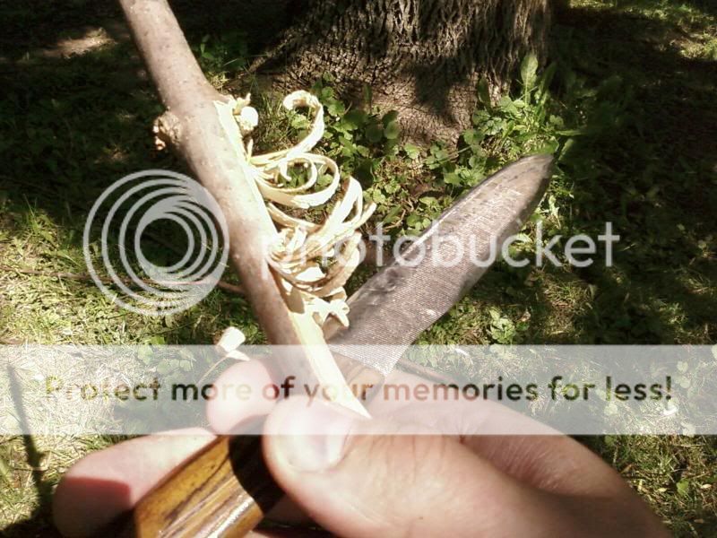

I took them out and did my favorite test: making fire. It's the skill I practice most, so these babies got a crash course in making tiny curls on a stick, scraping/shaving on a mag block, and sparking a firesteel.

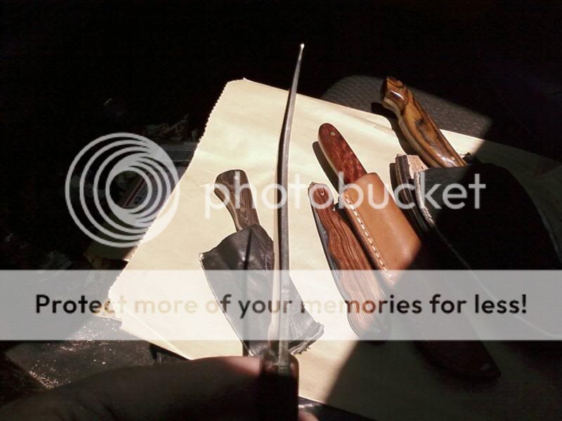

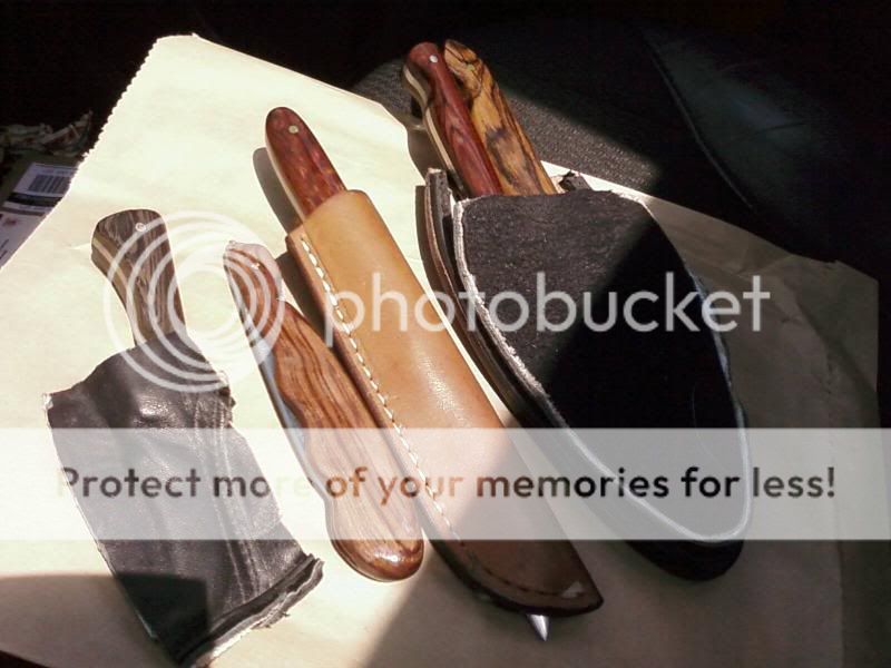

Here's some pictures I took in my car.
The big bushcraft knife has some material in the file grooves. I can't tell if it's wood from previous use, or leather from the sheath. If the files are removing sheath material, that's something to keep in mind.
The "crooked blade"
My initial impression is that these are solid knives with comfortable handles. With the possible exception of the folder, which I'm a bit wary of safety-wise. I'll touch up the edges on all knives, put them to work, and post a review ASAP. :)

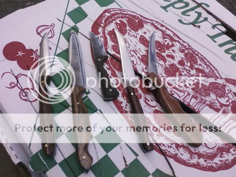

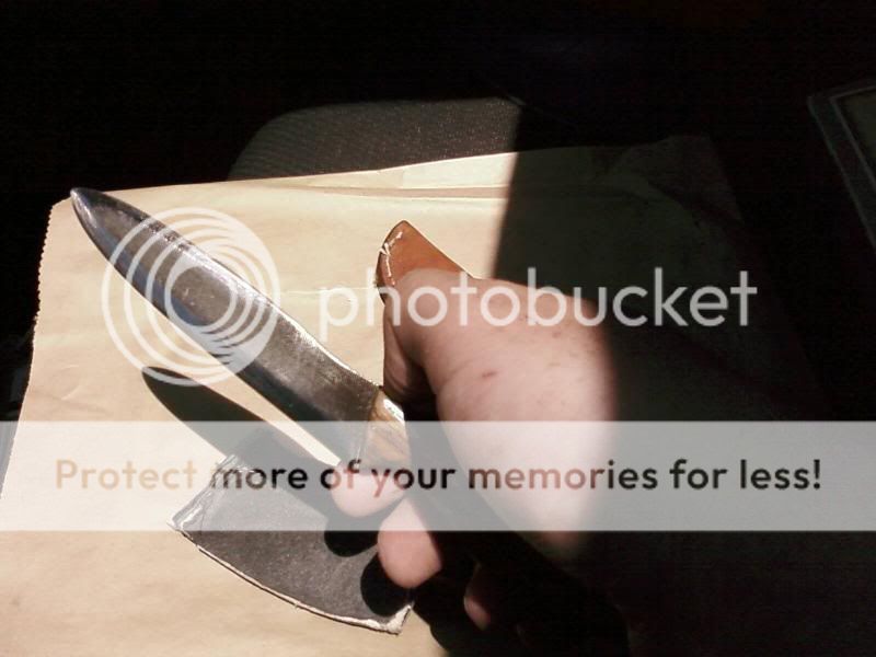

Okay, here we go! It was a fun few days with a varied group of knives. After testing grips, I gave the blades a pass on my strop set. First test: Pizza box cardboard.
The Wharnie cut cardboard like hot butter. Super smooth and easy. Also, the small blade did well. The crooked knife was fine, but I didn't feel comfortable using the folder. Maybe it's just my inexperience with this type of knife, but without the security of a spring or a lock, I felt like I had no control.
The Bushcrafter knife dragged a little, mostly due to the thickness of the blade. Though the file teeth made a cool noise going through cardboard. :D

Here's the Bushcrafter cutting some curls. Not bad, but the blade is noticeably thick and the curls came out rough.

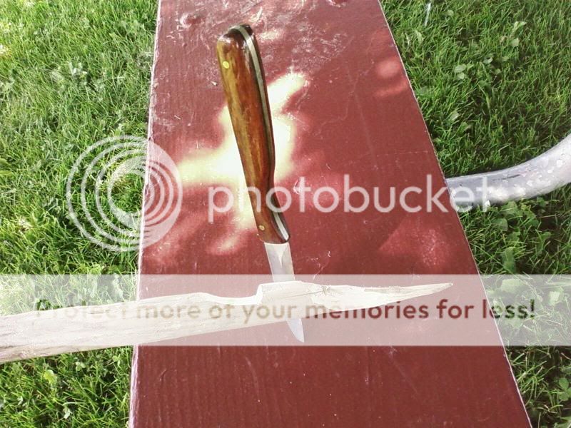

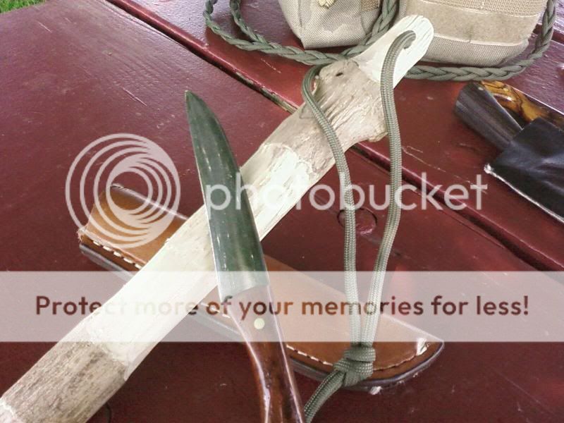

The Wharnie is the blade I gave the hardest workout. A thinner blade than the others, it sliced with ease. Here it is after making some curls.

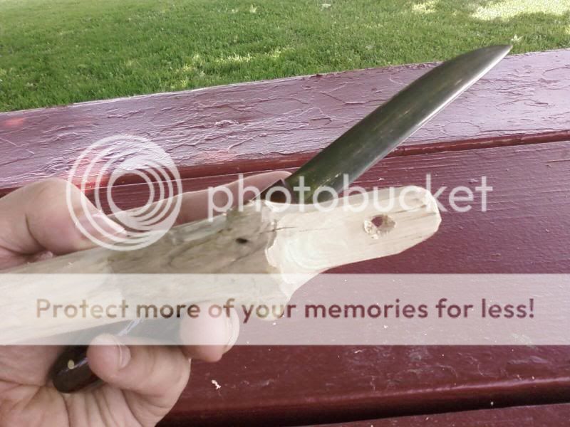

Notches are super easy, as this walking stick/spear can attest.
And just to give that edge retention a test, I did some needless carving, cutting, and drilling.
Of course, I then wasted time by throwing the walking stick/spear and seeing if it would stick in the ground. :p
All three knives throw respectable sparks, especially the file-sided ones, but none so well as the actual striker provided with the ferro rod. Edge retention after all this work was decent. None were shaving sharp by the end, but the wharnie was sharp enough to go for a while more, I'd say! Overall, I liked the wharnie best, but that little guy is a very close runner-up. Thanks again Fog2, for the opportunity. It was fun!. :)

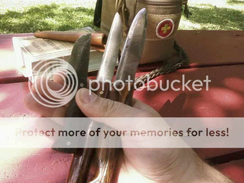

Got to play with the knives some today.
My son and I had a blast.
Photos and comments coming soon.
Smitty0331 PT my your addy and contact information.

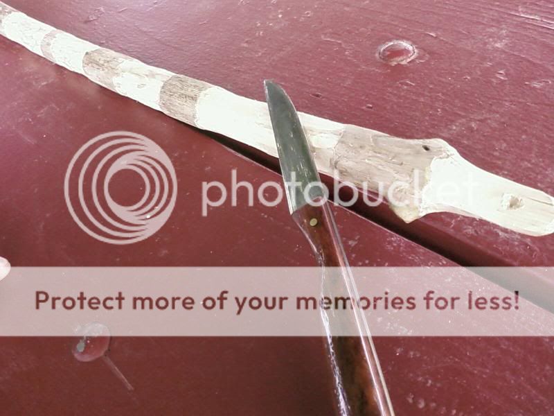

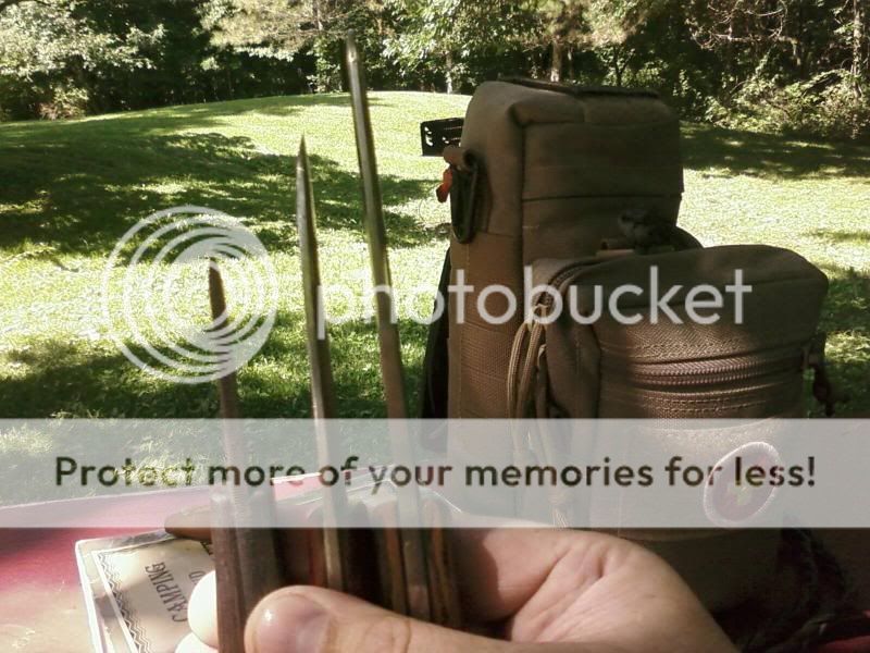

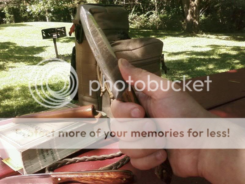

As I said, my son and I got out one afternoon last week and tried out these knives. We had a blast.

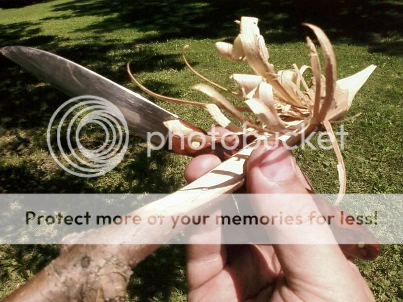

We were working on some fire making skills so we set out to make a bunch of fuzz sticks.

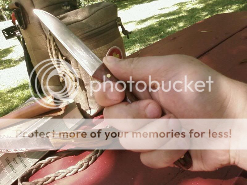

This one has a great handle but the edge is a bit thick for my taste.
My son found that with careful use and going from tip to base the friction folder made nice curls
My two favs were the wharncliffe and the small one.
Here is the wharnie
The compact knife was the overall winner in my hands. This would be an awesome edc or a great bushcraft backup.
