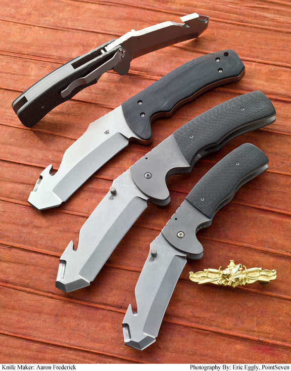

Aaron Frederick makes the VBSS Breach which is designed for it. Some SEAL teams use them for breaching doors.

I haven't seen you really discuss any features that are specifically related to lateral force. You keep mentioning locks as if that's the common point of failure while prying. It isn't. The blade breaks or the handle breaks.
Fixing that means you either make the steel "tougher" which always comes at the cost of edge retention or it means simply adding steel, making the blade thicker and harder to push/pull through a material.
