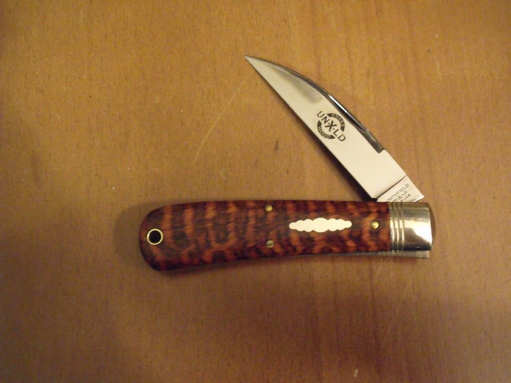

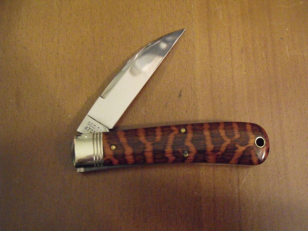

I though my Viper needed a little extra detail, so I grabbed a chainsaw file and went at it :eek:. Fluted bolsters! Cleaned it up with some sandpaper and left everything a 600 grit satin finish. Really happy with the result.
Wow! Those look great!
I always like satin bolsters. Now I may need to try rat tailing myself. Looks great!
I want to do that to mine now but I dont think I'd be brave enough to do it. That completes the knife in my opinion. Great mod.
That rat tail job looks very good.

Thanks guys! I did feel like the large, plain bolster was missing something. I would say don't be afraid to try it if you've got a steady hand. I filed a small line with a triangle file first, and that gave the round file a straight notch to ride in, then just opened it up little by little.
