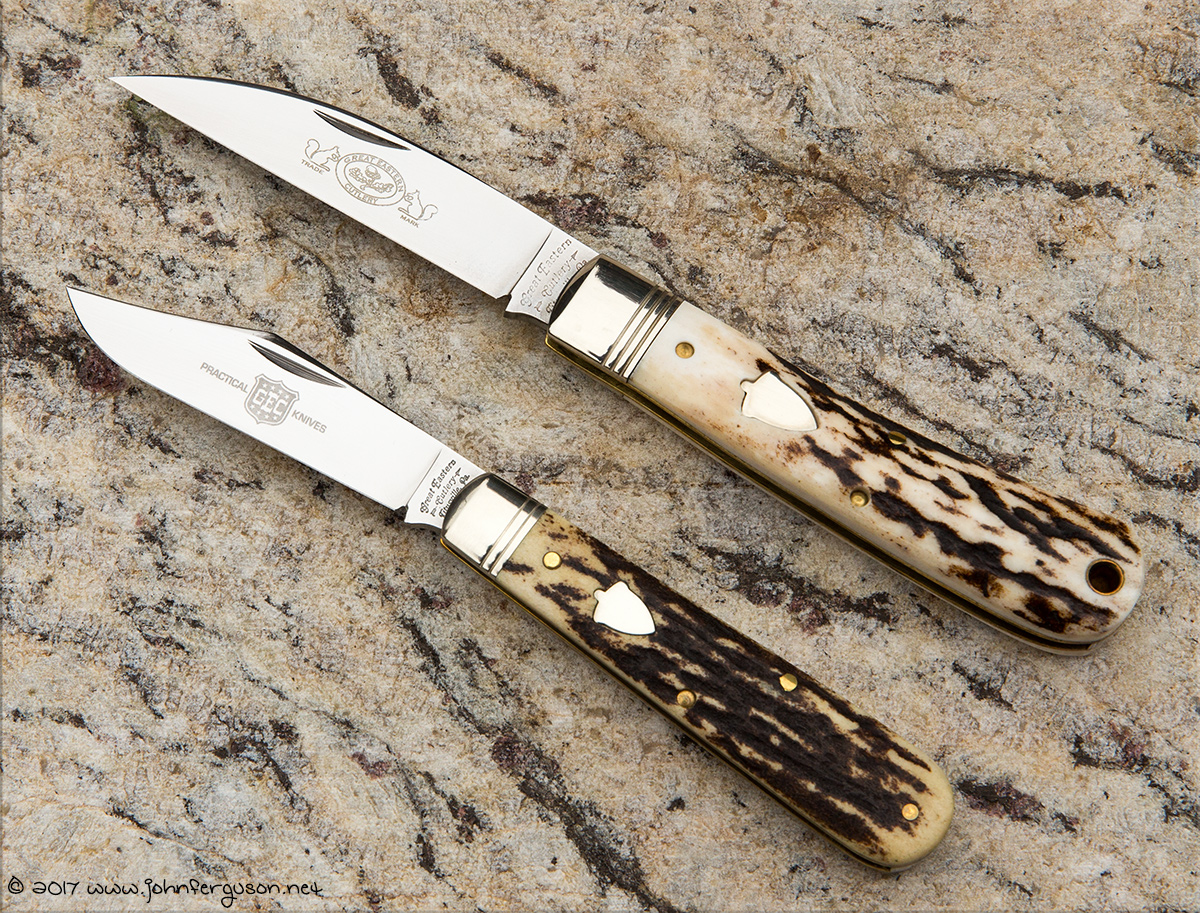

Nice pair there Chief! Yeah, but they have only used 440C and 420... So this thread was about the 440C . Now I've found out that the Farm & Field soddies no longer have the 01 steel!? That really sucks! GEC just seems to want to be a rust peddler :thumbsdown:
