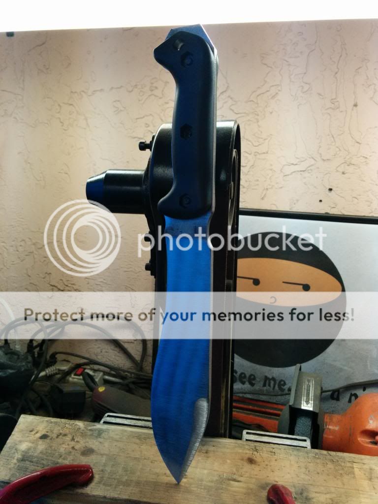

ok, question: I have finished 4 knives to be sent to Peter's for HT. 3 will be sold, the fourth is my version of a brute for me. Now, if I send it with the others I don't think it will get back to me on time to take to the gathering. Would it be possible to take it and do the ht and tempering over there? I really wanna show it to the peeps and Uncle E! It is 1084 and a hair under 14" overall.
That's entirely up to the cats doing the HT stuff... mainly 1066vik and tackett13; so I'll let them answer. It sure wouldn't hurt to bring 'em along and find out... everybody loves looking at blades in-progress :)
well, it is done, just missing the ht and some sanding afterwards. It will have becker scales until I finish making some dyed canvas micarta scales and pin them on.
