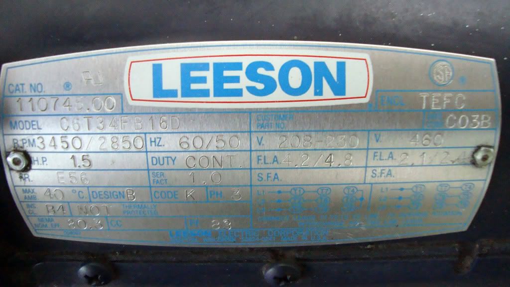

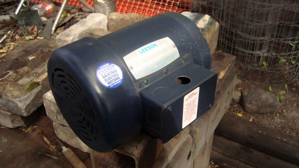

So I picked up a barely used Leeson 1.5hp 3 phase on the weekend for $50, score. Now like Tippet, I am wondering about the shaft length. The shaft on my motor is 1.9" long, with a .5" plate to pass through and leaving a .25" gap between the drive wheel and the plate there is only 1.15" of shaft to engage the drive wheel. Are the set screws on the drive wheels offset and is that enough engagement between the shaft and the wheel?
You should be fine. It all depends on the drive wheel you choose.
Worst case, if the set screw is dead center, you'd have .15 of the set screw contacting the shaft. Slide it in a bit (about .1) and you'd have a full quarter inch (assuming the set screw is a quarter). Everything will still play nicely this way.
If the set screw is off center, then it's even better. The shaft doesn't need to go all the way through the drive wheel.
