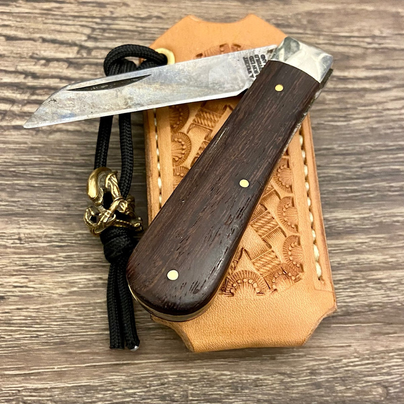

It's always good to see your loyal Lamb John :) I'm enjoying carrying my Rosewood Big 'Un today, along with my Hartshead Barlow :) Hope you have a good day :thumbsup:
