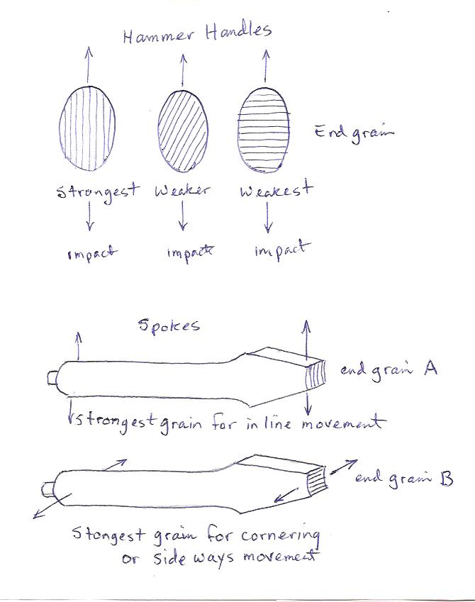

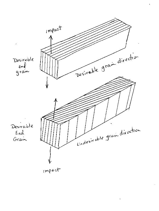

Here’s an interesting discussion on wooden wheel spokes used on old cars. Hickory was the choice of wood because of its strength and flexibility.
Vertical grain orientation still seems to be the key to avoiding breakage, but with spokes you have multiple force vectors, whether from bumps, braking, acceleration or cornering.
With axe hafts, vertical grain orientation is best, but it isn’t enough. We have to also consider grain slope, which will cause grain runout on hafts, whether the grain is vertically or horizontally oriented.
