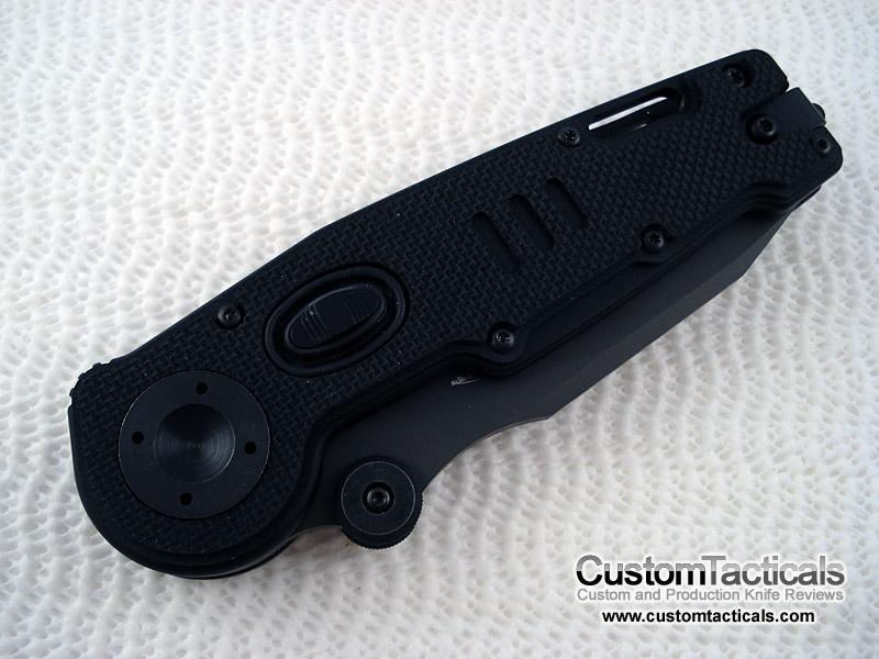

Your video is an excellent demonstration of how the tang has 0 contact with the locking mechanism once it's in the open (but unlocked) position even if you don't have the lock pulled down. The little cylinders that stick out of the side of the tang (the tang is basically a camshaft in hawk-locks) are the only things that touch it, and they only touch it two times--when it's nearly fully open and when it's nearly fully closed. You can get the same effect with an axis lock by holding down the lock the entire duration of a flick, but the reason the flipper in the RAM is so superior to say, the flipper in a linerlock (or an axis lock, were one to exist) is because in a flick motion using the thumbstud or a flipper, you can't disengage the lock the whole time, meaning the axis is putting pressure on the tang and creating resistance and a less smooth, slower deployment. By no means is it a BAD action--it's the 2nd best in the world. But the hawk-lock is the first.
As per the surface area debate, it's partially made irrelevant by the fact that the cam engages the lock so little when opening and closing. We'd have to do a lot of empirical testing to see which one wore out faster.
I'm sort of curious how you could have over 100 axis lock knives (something most brick and mortar shops don't accomplish for several years) and yet use them all enough to count them as examples for omega-spring reliability. I mean, maybe you have a few axis locks you've used constantly for years (as have I, with great success), but did you really use 100+ axis locks to the point where their reliability was tested?
I've definitely owned many an axis and used a plenty ... How much time do you have with the HAWK?
"the little cylinders that stick out of the side of the tang (the tang is basically a camshaft in hawk-locks) are the only things that touch it, "
The little "things" are pins with a tiny diameter. The tang really isn't a camshaft because a camshaft is a lobed bearing surface. And being that those "things" are so small they have very little surface area and ramp up super steep ... creates wear.

I agree that the fact that the axis-lock is currently much more time-tested is a plus. Empirically speaking, it's a known quantity, and the hawk-lock is nearly theoretical at this point (at least, relative to the axis).
The "pins" have double the contact in the sense that there are two of them, and only one is engaged at a time. Furthermore, like I said earlier, unlike the axis bar, they have no contact at all during the vast majority of their movement, whereas the axis bar will under most conditions (excepting pulling the lock bar all the way down for the entire opening/closing).
I'm not going to take a stand on which one will wear faster in regard to the pins versus the barbell. That one's going to come down to empiricism.

I Furthermore, like I said earlier, unlike the axis bar, they have no contact at all during the vast majority of their movement, whereas the axis bar will under most conditions (excepting pulling the lock bar all the way down for the entire opening/closing).

Also the placement on the Hawk means it could be disengaged if being used hard. And if you watch the video where it is opened up, you see that during the course of opening the stud on the tang has to defeat the spring twice as opposed to the Axis' once (Axis should be easier to flip).

In my use, the Hawk-Lock is easier to use with one-finger. The Axis certainly works fine when only using the thumb, but the Hawk is a little easier IMO.
I would like the Hawk-Lock much better if the button was a double stair case design like the prototype had. It would make actuating the lock much easier. I still love it though.
Also, since the Hawk-Lock is contained inside one single scale, it is superior for flippers since you get crap out of the way so you can get a good swing on the flipper.

Well, I think there's a variety of non-technical reasons why axis locks are so much more prevalent. First, it's been out much longer, and second, it's IP owned by Benchmade so they can use it as often as they want. I doubt Kershaw has unrestricted access to use G&GH technology, so it's limited to a single designer's models.
I agree that the placement on the hawk is less than ideal, but that's not something integral to the lock. They could have moved it upwards--I'm not sure why they didn't. As per accidental disengagement, I doubt it's any more likely than the axis--there seems to be a lot more resistance to the lock.
Also, for combat knife use or self-defense knife use, the lock is hidden in your hand during a struggle, where the axis lock is exposed and theoretically could be disengaged if it goes to the ground or in the clinch.
As per engaging the spring twice, this is actually much less often than the Benchmade's arguable infinite touching--unless you hold the lock down during an entire opening or closing, the tang and lockbar are in contact the whole time. This is probably why the RAM is so much more flickable and smooth than axis locks.
I'd definitely encourage people who are interested in this discussion to play with a RAM so they can feel what I'm talking about--people have assumed, with good reason, that the axis lock is the smoothest mechanism out there, but this I consider undeniable, the hawk-lock is both smoother and lower resistance (to the blade in motion). Just playing with it will give you an idea of what I'm talking about. I completely don't mean that to be condescending, I think it's just something that people would go "ohhhhhhhh that's what he meant" if they played with it.
As per debris in the lock and cleaning, I certainly agree that the axis is much easier to clean, but I'd also argue that the hawk-lock is much less likely to need cleaning. And I don't just mean the MUDD, which theoretically shouldn't need cleaning in the usable lifespan of the knife. Even the humble RAM is nearly sealed--I'm sure dust can get in still, but I rather think that wouldn't be a problem.
As per the number of models with the hawk-lock, this is more a product of it just being from one design team--sort of like how the stud lock is extremely rare, but that's merely because the designer wanted it to be rare.

Like all locks, as far as I know, the hawk-lock is fully ambidextrous although it's not symmetrical. I have no more or less trouble opening/closing with my left than with my right. I find the same to be true for liner/framelocks.
As Cutter suggests, there is a lot more to the MUDD than just a hawklock. The materials and gaskets supposedly greatly increased the complexity of manufacturing and lowered their returns. It is certainly not because the knife was unpopular.
I agree. The flat plastic lock on the RAM too course and small. That's not a problem with hawk-locks in general, but the RAM could have implemented it better. The good news is that it uses a stepped design on the MUDD's lock.
