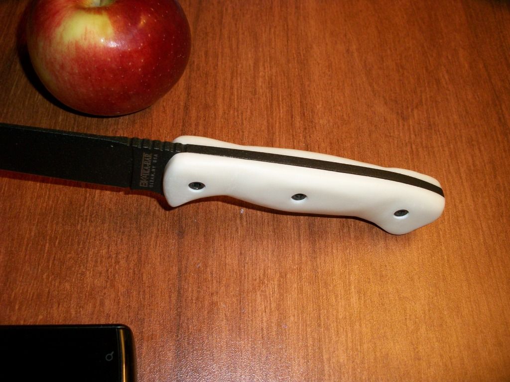

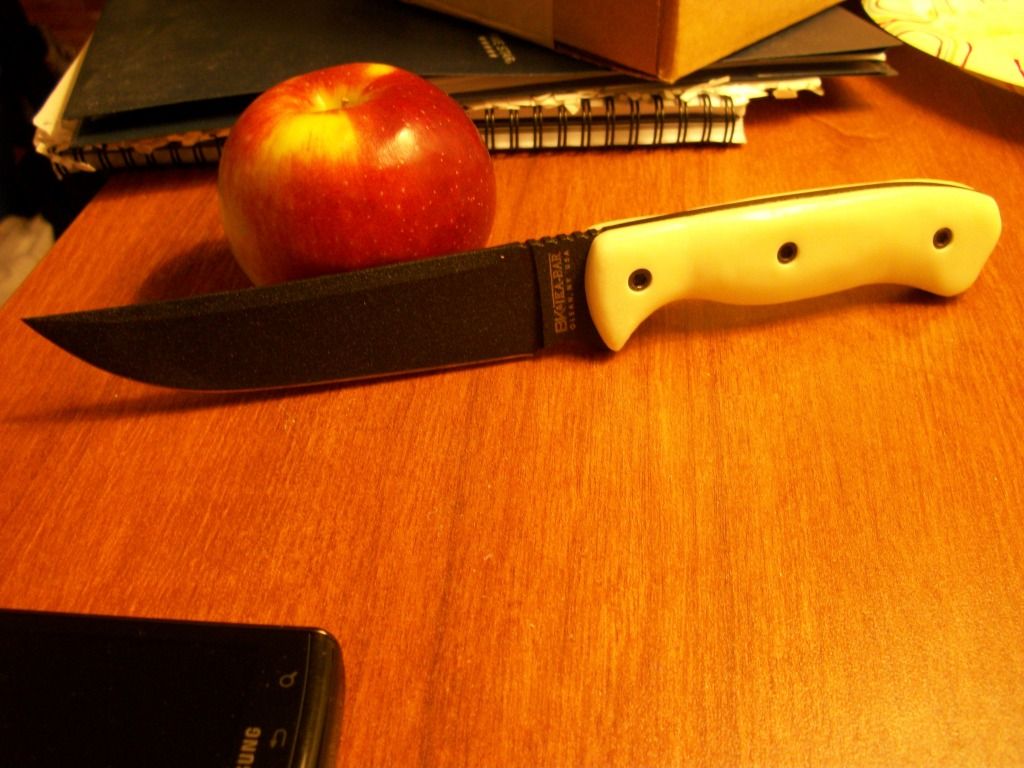

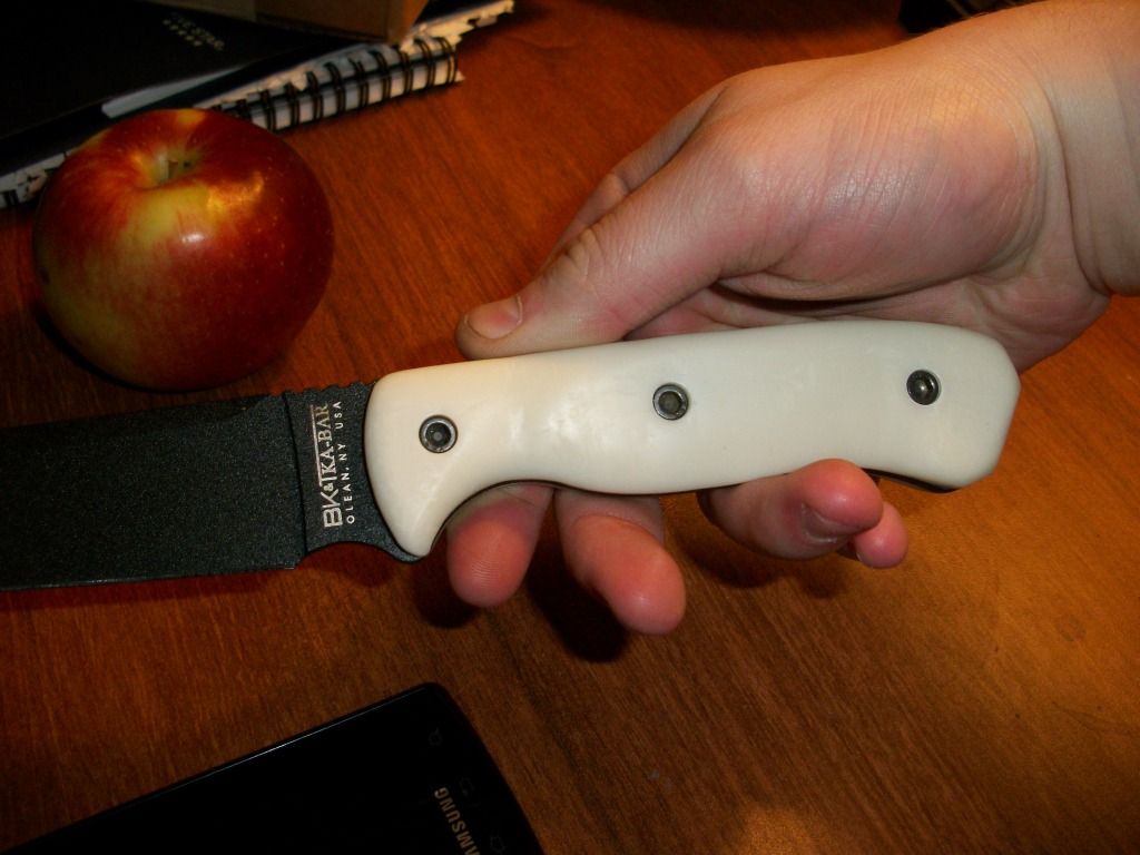

I did get a chance to work on some scales for my 15 some more. These are the scales I was trying to give away about a week back. since no one spoke up I figured I would play around and try to shape them. I like them a bit more now. They still need to be sanded down a little more and have some of the marks from my dremmel soothes out but I'm happy with the progress. I like the look of the white on the black.
Thanks, I might try dying some extra scraps to see if I can get any cool colors, I originally wanted white for my 16 but after I put them on it......not so much. A nice green might be a different story though. The material is really easy to work with also so making a new set for the 16 wouldn't be bad.

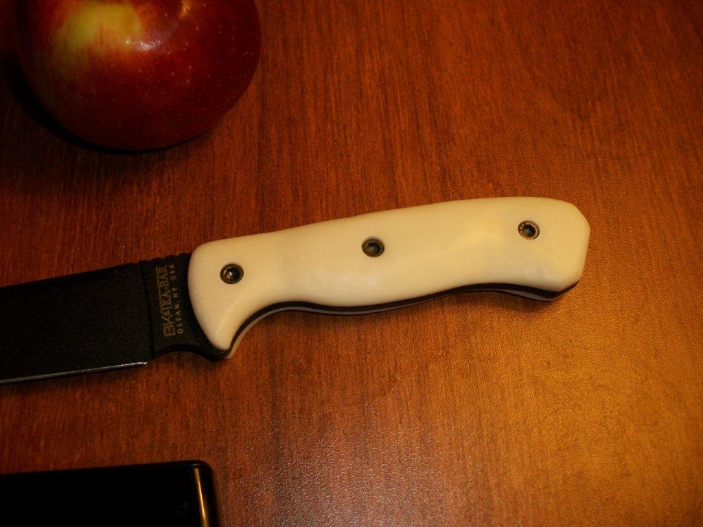

Almost finnished the micarta for my 16...Dont expect something fancy since its just regular micarta and will turn out looking like the ones Ka-bar sell. Also, you dont have to make those dumb ass hex holes for the screws, I reused the original hardware and with the right sized drill bit you can just wack the nuts in and they will stay in place.
