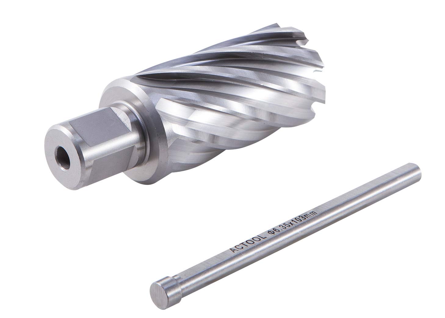

I'd never thought about an Annular Cutter - like this? https://www.amazon.com/dp/B07526Q53V
That does look like it would cut a smoother, more to size hole than a holesaw would. $40 is a tad more expensive. AND, an arbor to hold the cutter is still needed, and most of those are M2 taper. I only found one that was R8 and it was over $100 with coolant system.
I think for his 1-1/4" pin the hole saw was a good idea.
Yes that's it.
The better fit and less slop on the pin fit, the less it will wear.
Maybe that's not an issue on a forging press vs a shop press that will be used at max more.
$40 is quite cheap actually
Hougen would be the pro brand name
I just mentioned it for others info.
The 3/4" weldon shank is just a close round fit with setscrews
A 3/4" Endmill holder would fit an R8, but it would take up head room in a mill.
A simple R8 3/4" collet would do it too.

1 12345678910 - Good point on the annular cutter! That may have gotten the job done as well. I was thinking if there is any slop in there I have some 0.010'' shim stock that I could line the hole wall with. We'll see when I get the pins.
