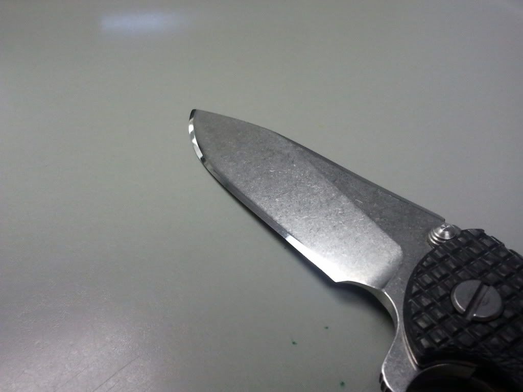

Yeah, only did this two nights ago, haven't had too many cutting opportunities come up, but it passes through paper like it isn't there, and my calzone got delivered to work today unsliced, so I used it on that, and it cut like a scalpel!

What did you do it to - inclusive? It looks like a slicer from the angle of the picture?

Calzone!:eek: You sliced a Calzone! Side to side or front to back? OMG

Well, I did it. I decided 100% I was going to keep it, and depreciation be damned, I wanted my xm-18 slicer to be the best slicer it could be!
I went 30 inclusive all the way to a 3.5um strop, then backed off to 40 inclusive for 100 passes at 5um and 200 passes at 3.5um. Not sure if it was course enough to provide a true microbevel, but this knife is SHARP!Next investment is a set of water stones.

300 passes at 40° would put a heck of a healthy microbevel on it and was certainly the right move after taking the edge that thin. Nice work! :thumbup:
