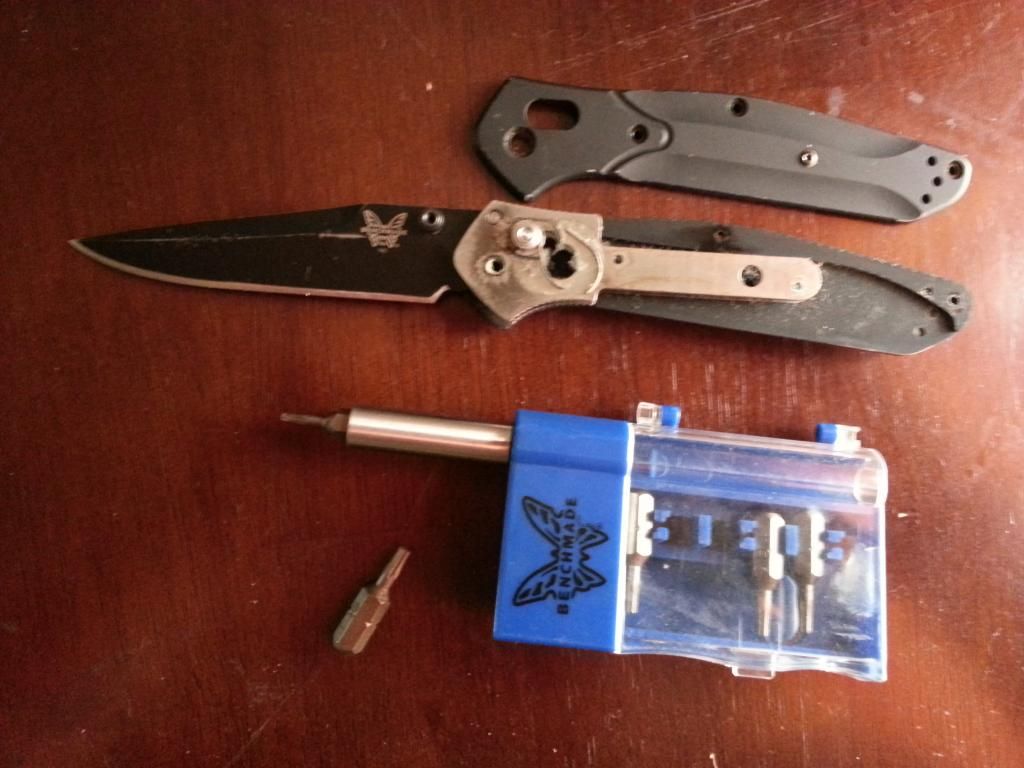

Just got mine all taken apart, and thought I would share some pictures... I've got some music wire that I think might work to replace the spring...
Disassembly
After taking off the handle, the break is revealed...

One of those handle screws was really tight. I ended up breaking the tip off of one of the torx bits and twisting another (you can see that in the pictures). Luckily the bit-kit comes with two of each size.:D
I recommend to go to local hardware store to buy more reliable torx. I have stripped 2 of BKC knives (I haven't send them back yet).. :(

They loc-tite their screws, so a poor-fit or inadequate pressure on your driver can result in either a stripped screw-head or torx-bit. However with some care, or the help of penetrating solvent or a heat-gun, it isn't too difficult.

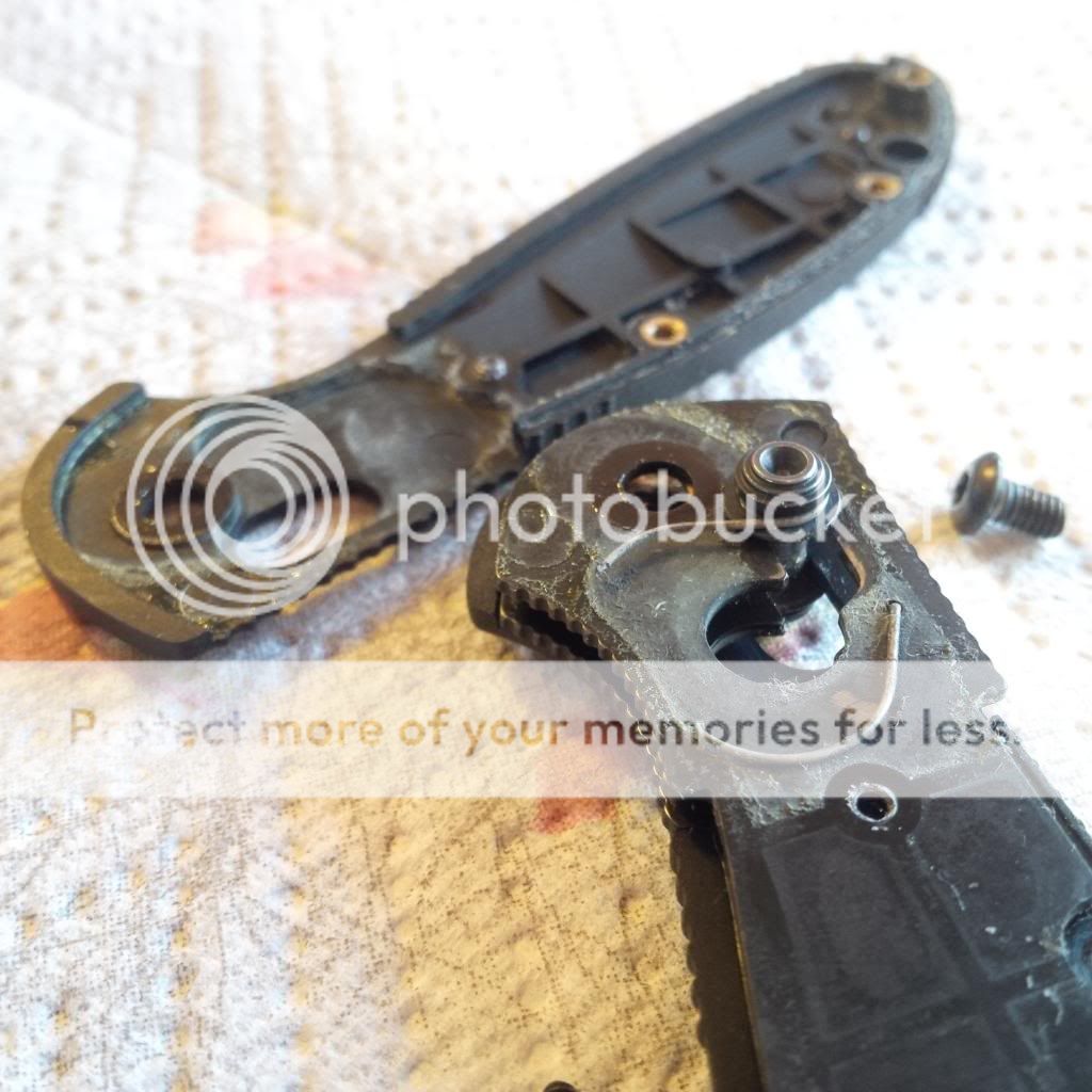

Disassembly

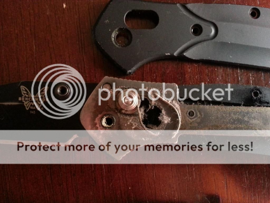

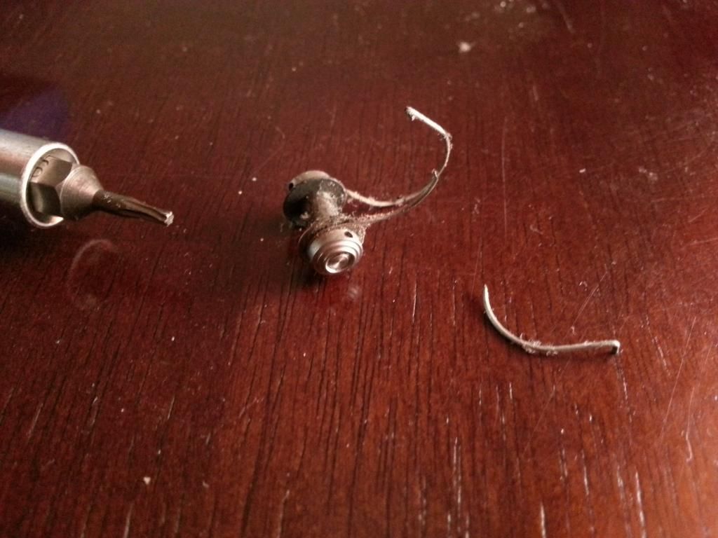

Close up...
Entire spring mechanism taken out...

PS- One of those handle screws was really tight. I ended up breaking the tip off of one of the torx bits and twisting another (you can see that in the pictures). Luckily the bit-kit comes with two of each size.:D
That knife is filthy and there are all kinds of signs of corrosion all over the knife's metal liner/axis and blade housing. Mystery solved.

I don't think there was much mystery in that pic to begin with, though. :p

With an Axis lock, a catastrophic failure could be defined as the frame / liners breaking; the lock doesn't ever disengage even during major failure during use. HOWEVER, when deploying or retracting the blade, the omega springs are flexed and stressed; if conditions are right, you could end up with a broken spring due to corrosion or wear caused by lack of maintenance.

We can call the knife filthy, but understand that the lint you see is located in the hidden compartment that houses the springs. There is no way to clean that without taking the knife apart and voiding the watranty. Furthermore, after wiping everything down and cleaning it, I did not find any rust. Just clean metal. Springs break due to fatigue. It is just a fact of life. Not all mass produced springs are perfect, but to the human eye they all look the same. It is a hard thing to QC.

No, there are no rust on that 943. Just some lint and dirt. The dirt may be slightly abrasive, but The Government did kept up with some oil. (I saw some residual oil on partial liner.)

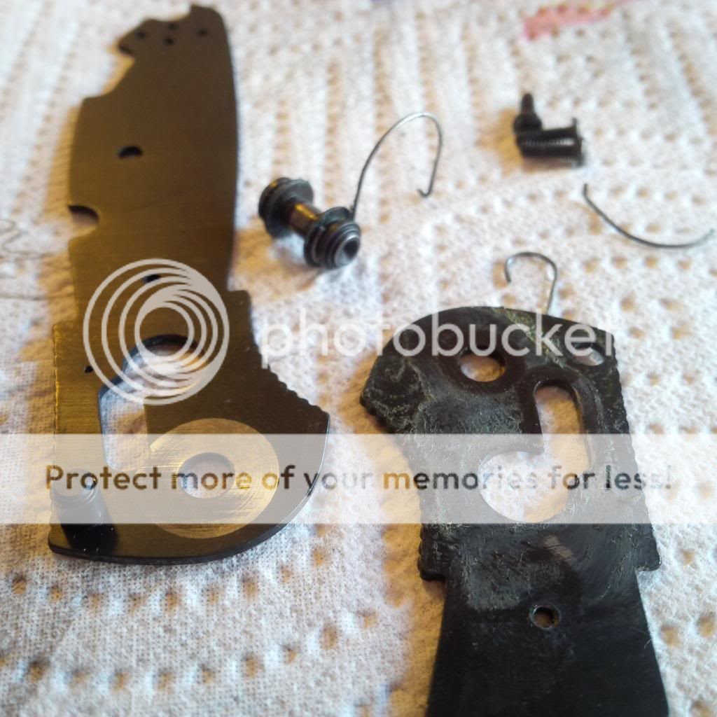

Here is a photo of the knife after it was cleaned up. All I did was wipe it down with a paper towel and some rubbing alcohol. As you can see, there was no rust to speak of. All of that discoloration was dried up oil combined with lint and grit. I have never been picky about what kind of oil I use for knives, so whatever is handy is what I use, and some oils have a yellowish brown hue, especially when dried. I think that explains the "discoloration." The reason I didn't clean the knife up for the pictures was because I wanted to treat it more like a crime scene.:D
Overall, this fix just makes me like the Axis lock even more. Knowing that I have the ability to fix one of the only problems with this design kind of takes away the problem all together. And now, life goes on...:D

Here is how mine looked...
One left alone, one wiped off with paper towel...
