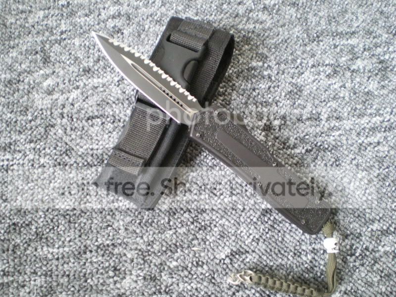

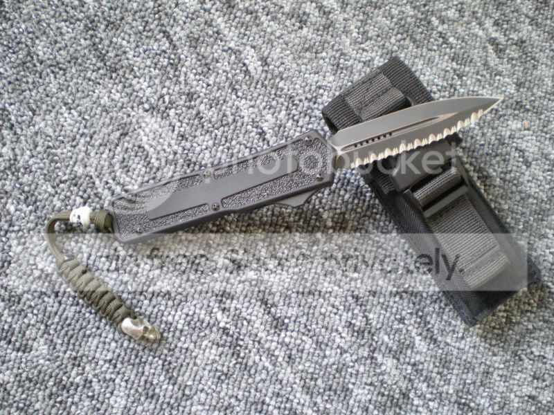

The knife is a normal knife, but everytime I see the knife I will remember the helps I got from here, thanks to everyone!
I put the knife together and took pictures. The button is shaky, I don't know if it should be that way.

What do you mean, "the button is shaky"? It should not be too loose, it should fit in pretty snuggly.

Mingyu, there should be a small spring seated inside of the button. This spring presses against the knife handle and creates tension preventing the button from rattling. It looks like it's present in the picture you got from PVK, but it could be easy to miss while reassembling the knife. If it is there and the button is still shaky you can stretch it out a bit to increase the tension. Ideally the button shouldn't make any noise when you shake the knife, but I've seen a few that did even with the spring. As long as it works I'd consider this a victory.

Thank you Cam, I put the small spring under the button but the button is still very loose, shake the knife can hear noise from it, I will pull the spring longer to see if it will be better.

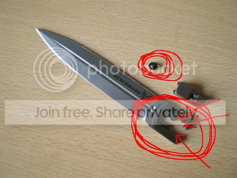

The benchmade infidel is a good knife, I have one, nice looking and easy to fire.
My experience: 1. the blade play is easy to be big because its design, you can see from my picture, the blade and lock unit are put together by only one small screw, and the gap between two parts caused the blade play up and down when it's locked. The solution is to put something in the gap so there will be little blade play.

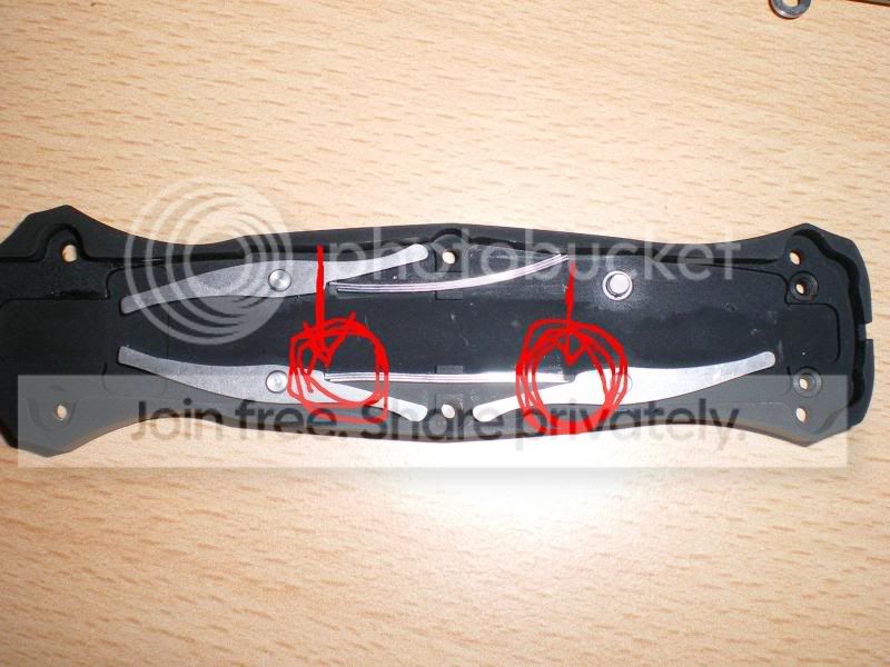

2. sometimes it fails to lock when I fire it out or in. To solve this problem is to put the lock spings near one side or the other, depends on the situation.
