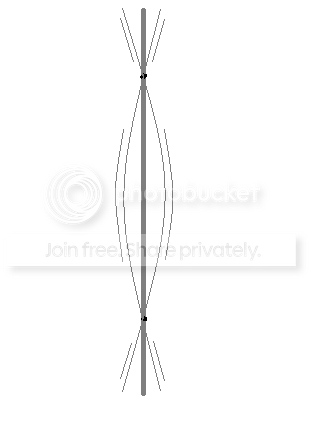

I know from stick/staff fighting that when a long straight implement is struck (in the case of a sword, lateral impact) it vibrates and there are two(2) pivot nodes(for lack of the proper term) that have less transmission of energy to the holder. Here is a crappy drawing to illustrate...
I would strongly suspect these come into play with regard to sword design... atleast it would if I were designing one... having experienced these vibrations, first hand (no pun intended)

I know Kevin is off to the show soon... I may have missed my window but perhaps one of the swordsmart folks could comment.
Rick
Rick,
You are absolutely correct. ;)
In sword circles I believe these are often called the primary and secondary nodes. Years back, when I was more excited about swords, nodes were one of the hot topics. We used to go over to Gus Trim's shop and cut up all kinds of stuff... and I remember doing a lot of "pommel bumping" to see these vibrational nodes.
