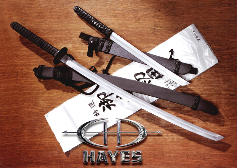

What type of "work" do you want it to do? If you are a traditional martial artist and would like a high-end traditional working sword... the Katana Tac might not be for you. He uses all the traditional geometry of the Katana... his "allowances" are in the handle. Rather than having it mount into a Tsuka, he goes full tang with a wrap(adding lightening holes). The ricasso is filed to "suggest" a habaki. It is definately lacking most of the fittings of a traditional katana. It is what it is... there is no marketing hype... Wally is a straight shooter.

Rick, the Hayes swords seem to be what I have in mind. I'm all for improving the handle, doing a full tang length, all the while keeping the blade traditonal. Hundreds of years of war has led to a design that works, I don't think I could improve on that myself.
I'd like to own a fully functional katana, without all the parts to the handle. Why, I like them, I'm not a swordsman, nor would I go chopping trees with it. I would like to cut tami, soft targets, pumpkins, and "safe" taragets. Maybe Zombies, if the need arises.
