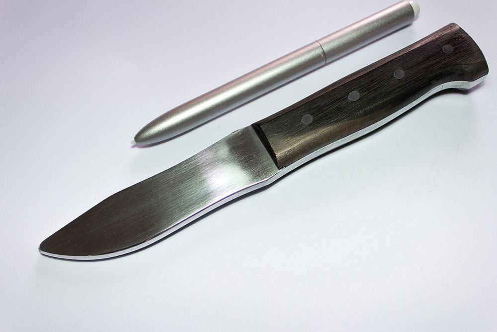

I firmly believe that knives are not "just for cutting". A knife's ability to puncture is extremely important to me, to the point that I will hardly even consider a knife with an obtuse tip. The majority of my knife work is done on my kayak while fishing or at the cleaning table processing fish. A knife without the ability to puncture through scales and skin is near useless for my purposes. I even have a couple of folding knives that I love because of certain characteristics which come with a "stronger" tip. I immediately regrind these upon purchase to give them a finer more acute tip. My favorite knife for "puncturing" is a custom Phil Wilson fillet knife with an extremely acute tip. I have made thousands of punctures with this knife...through skin and scale and often even hitting small soft bones. It has never suffered the slightest damage.
It seems from reading the original post that you want a knife that is good at puncturing but are then talking about a tip that is strong. The two characteristics are quite different and to some degree are mutually exclusive. I think the question which was asked very early in the thread "what do you need to puncture" (which you took for sarcasm) was an extremely important and relevant inquiry.
FWIW, type of steel has almost zero bearing on this discussion. The piercing ability and strength (or lack thereof) of a knife tip is defined almost exclusively by geometry.
Some shots of some of my "stabbier" knives.
