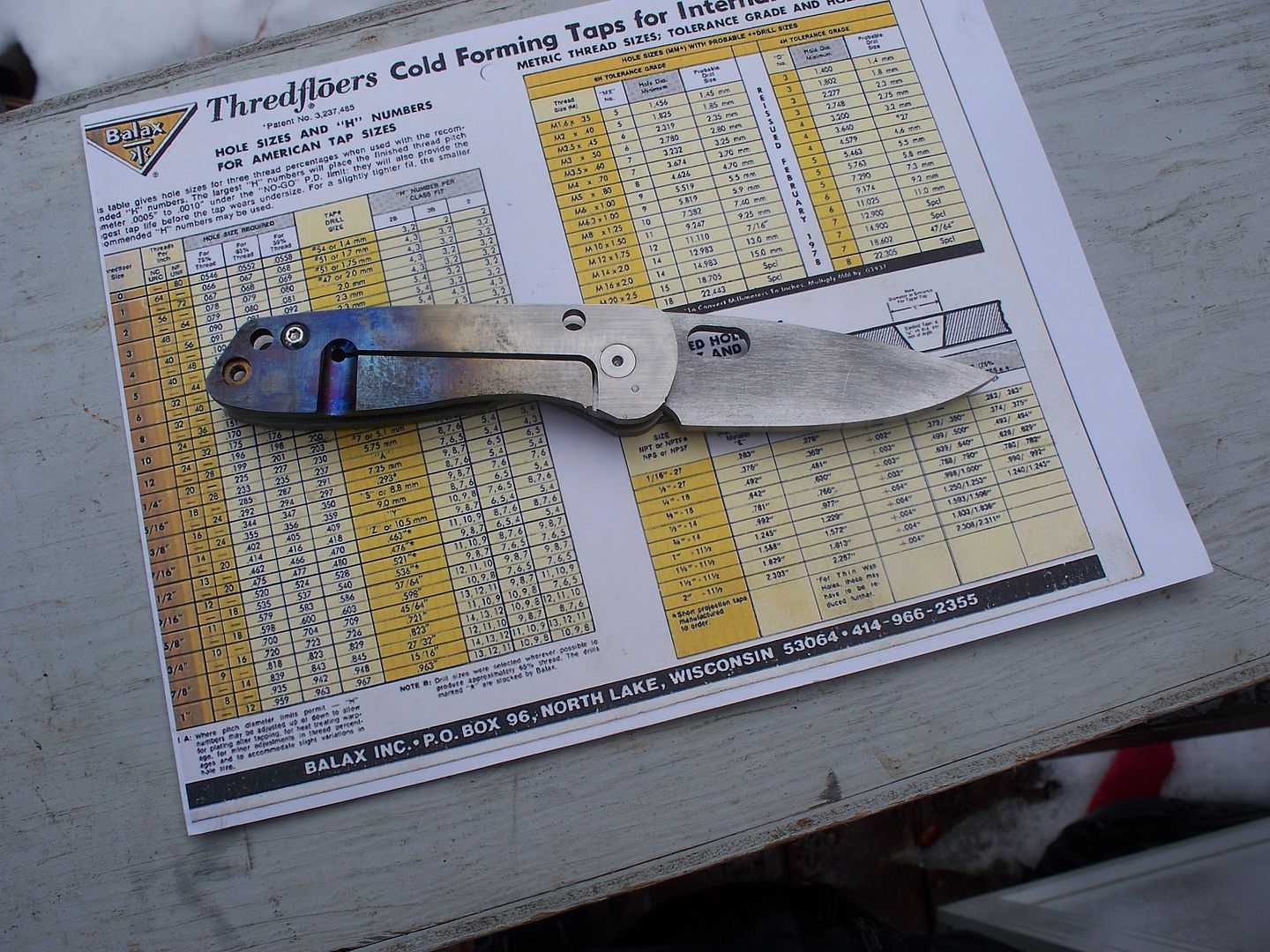

Lookin' good Dan, looks like a workhorse. :)
Thanks! I want it to be a really useful one... I'm going to carry one everywhere!

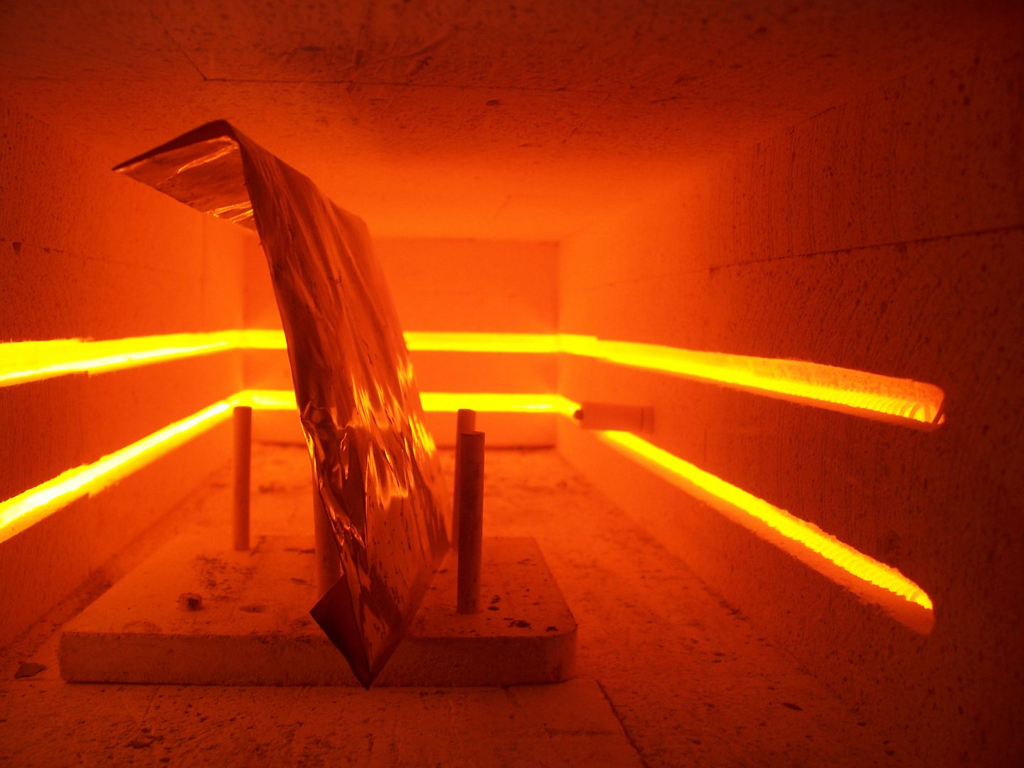

I have really short piece of CPM D2 in the kiln right now... looks like it almost needs a handle! :D
I have it cooking right now! :D

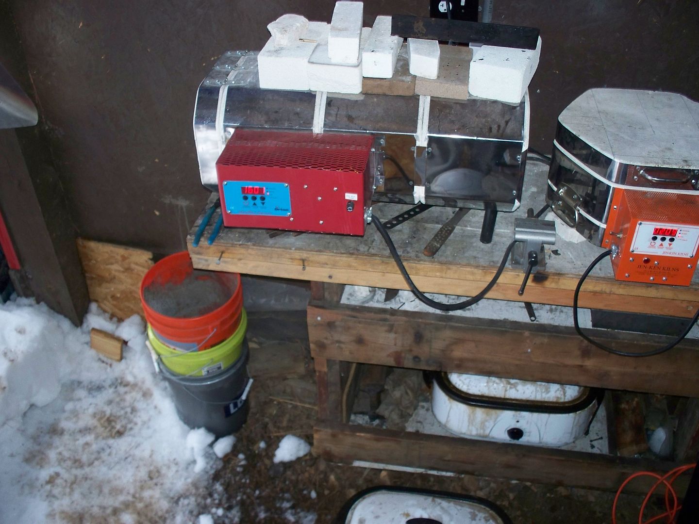

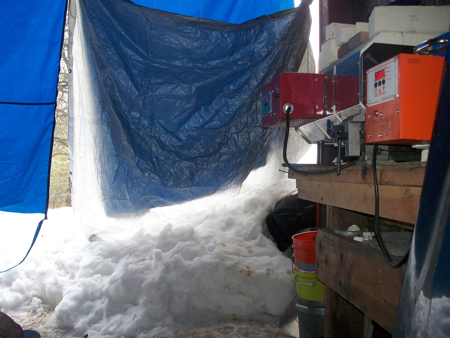

Check out the snow! Heat treat shop

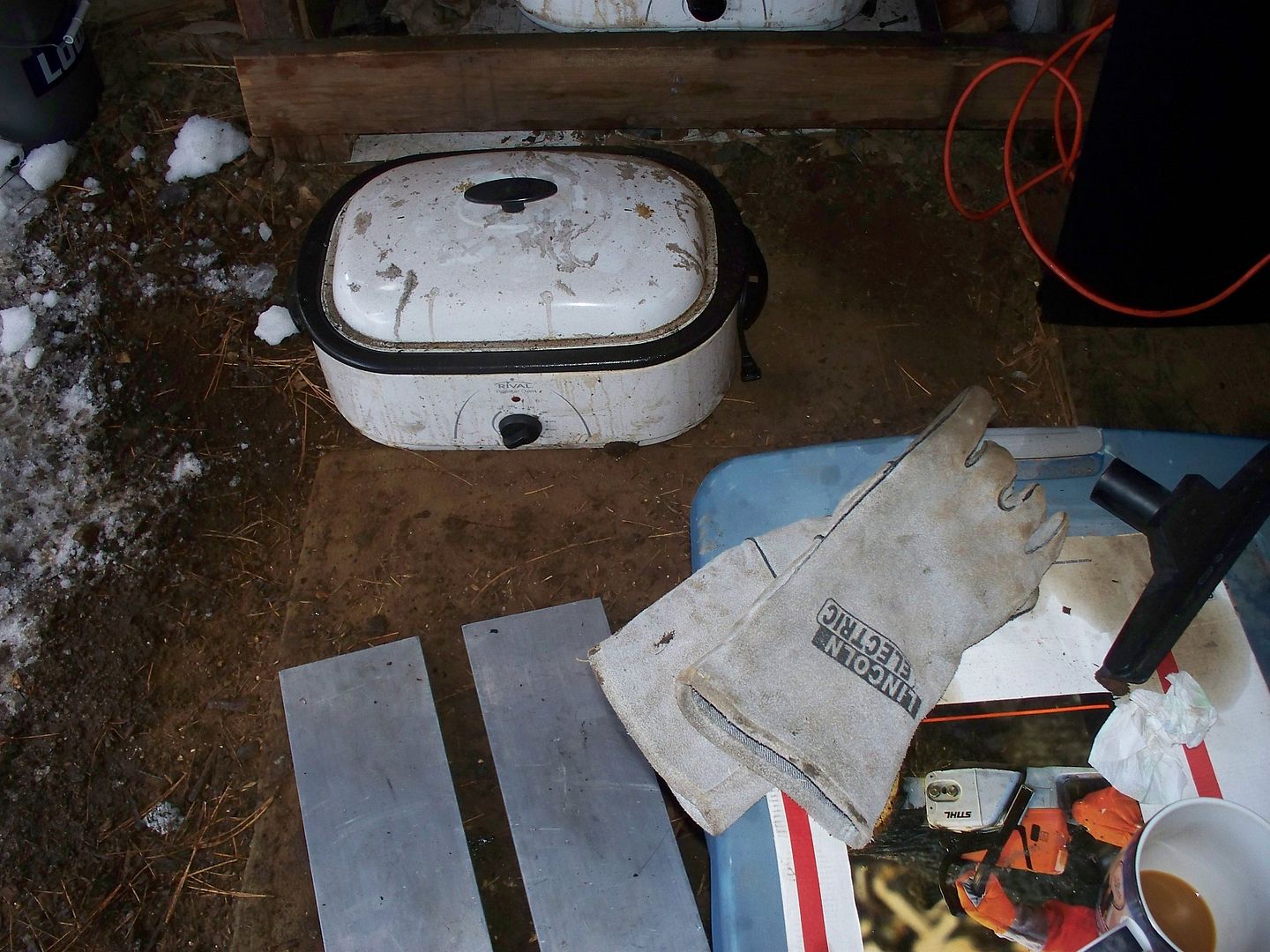

Oil and plate quenching gear (oil in the roaster, I can heat it easily this way) Coffee and a Stihl catalog...
The kilns! I use both, it is a real luxury but I can also get them into temper fast which is crucial.
Under the kilns is my broken wakizashi and tanto collection, lol! You lose some to brine quenching... today I'm using my 28 second oil for 5160 and 1" Aluminum plates for the CPM D2. The second roaster is for 11 second oil and I have buckets for brine too. The steels have to cool at different rates to get the best out of them.
