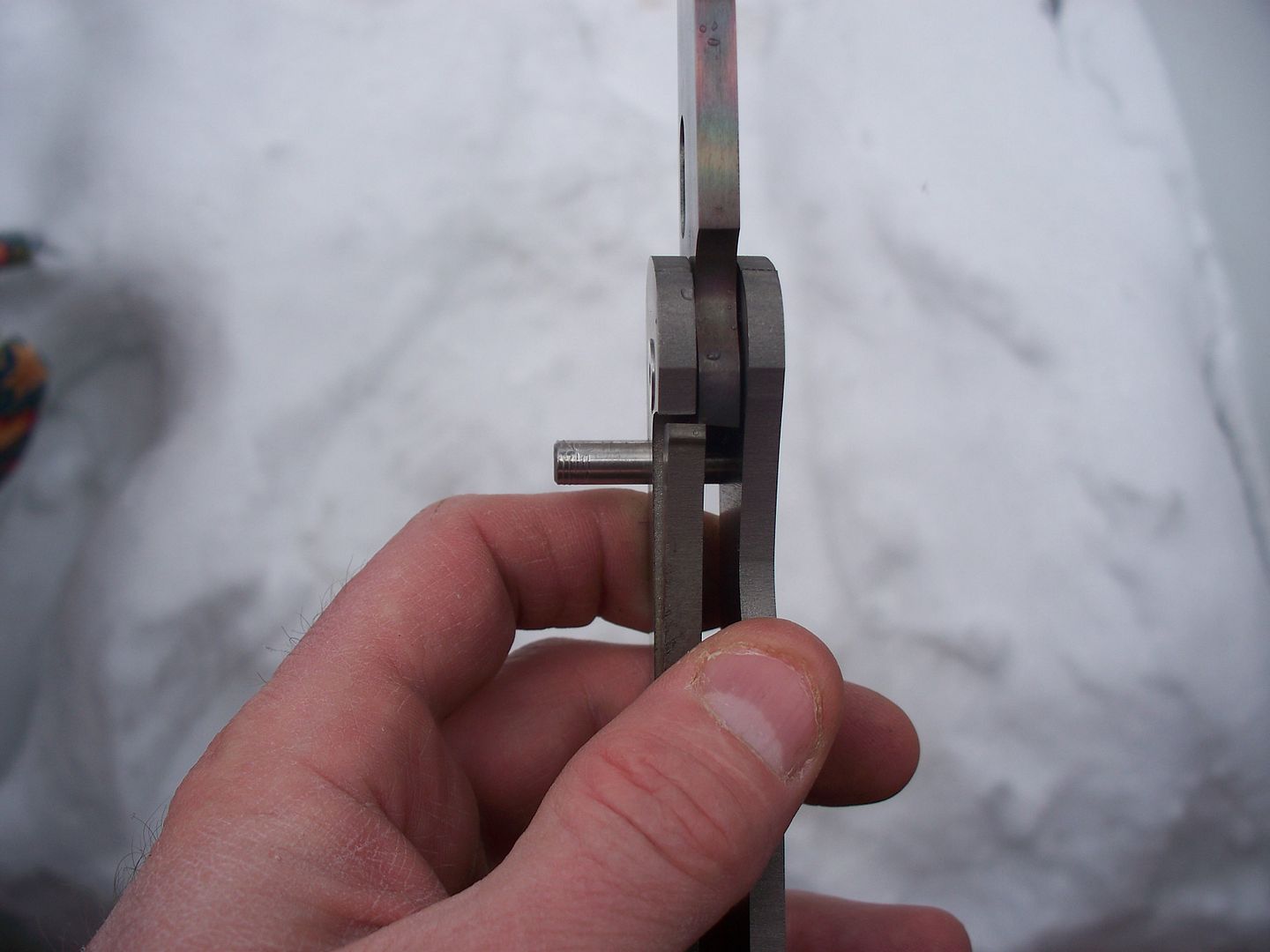

Damn, that thing is BEEFY! :D
You called it! heavy duty for sure!
Last night was heat treat time, I took the CPM-D2 to roughly 60--61 RC hardness.
I just came in from grinding the lockup.
It locks up like a bank vault! Click!
Even with everything loosely assembled there is absolutely no play in any direction.

I just asked Serge Panchenko and he helped me out, what a cool guy! He is making some incredible knives.
I just walked in and just about can't see straight... big day working on the folder today! I'm really excited to have it all going right, I feel like my homework is paying off. (and IMWILSON's huge help on the mill!)
I shortened some screws and cut some reliefs/scallops in the frame to facilitate opening and closing... did a ton of hole chamfering and sanding on a surface plate. The detent is the next major obstacle... after that it is all tings I have done a ton of times before. I really spent a ton of time on design and so far the knife is functioning headache free! I'm especially amped about the lockup, it feels nice!
lockup looking good nice and early,,its like a freaking TANK!!:thumbup: I LIKE it!!!!
