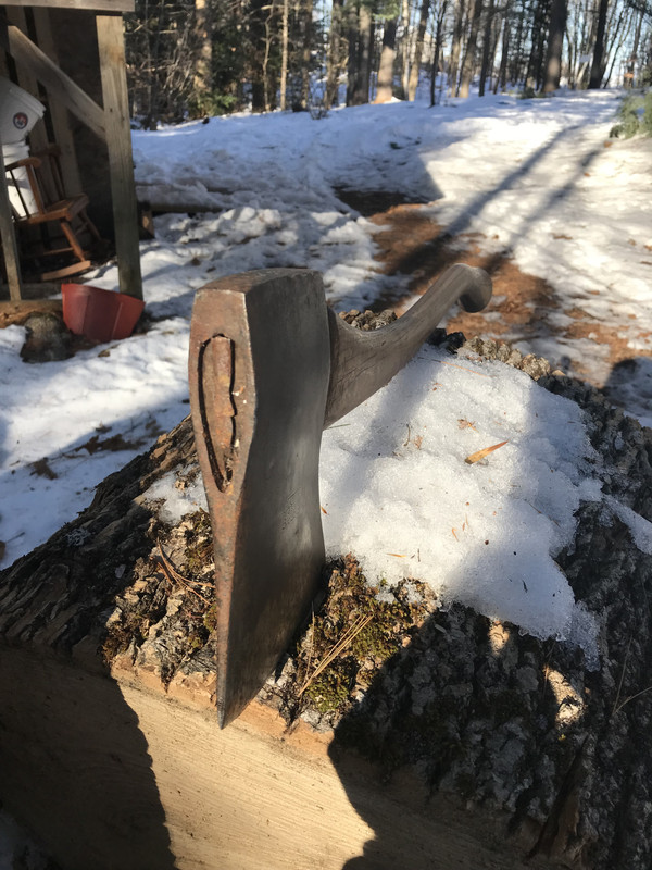

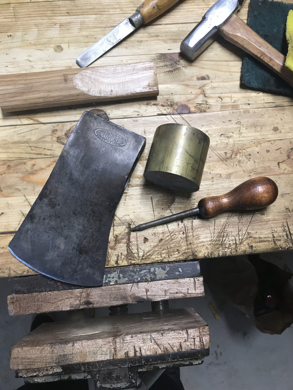

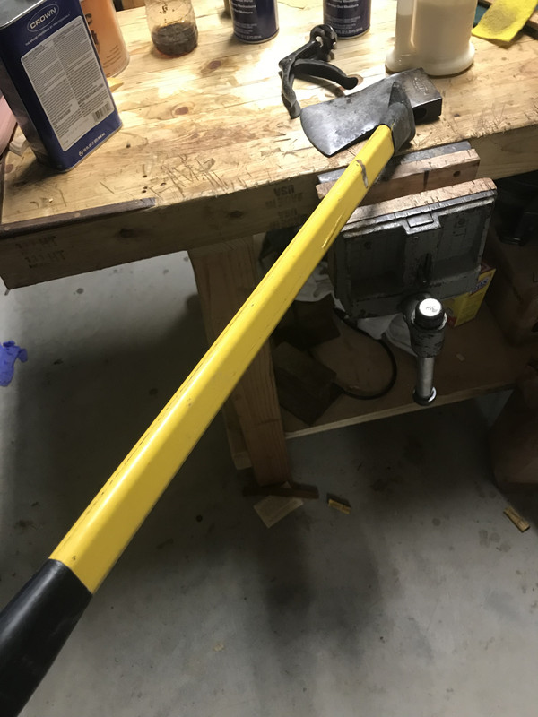

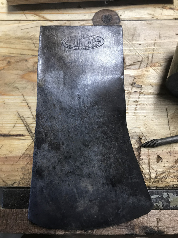

So today I went to one of my usual stops for pickin. I have explained to the guy what I am looking for and most of the time it’s easiest to say “wood handles axes good” “fiberglass handles bad”. But today I got lucky. He said well I got an axe but it’s a fiberglass handle. I said well let me look at it. It ended up being this Dunlap boys axe. Just goes to show you make sure you look at those axe heads before you dismiss them!! Happy pickin!!!
I also picked up this chunk of brass and this little threaded countersink maybe? I’m not sure. $3 for all!

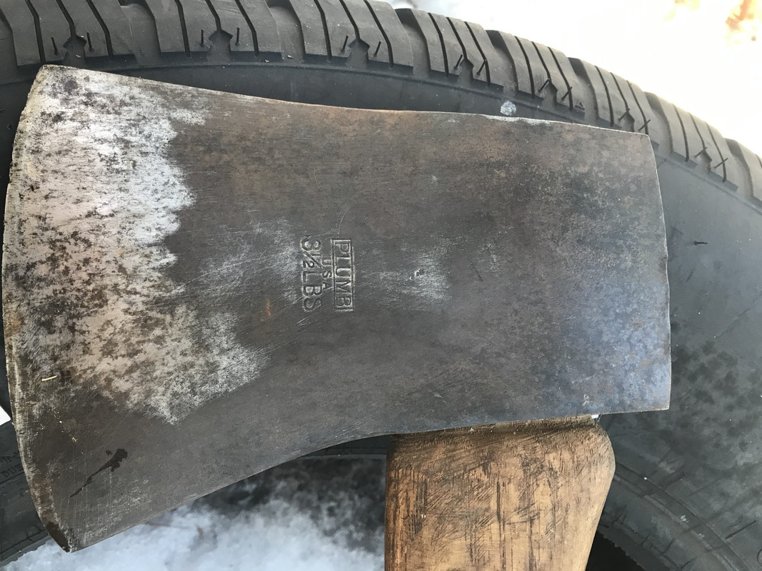

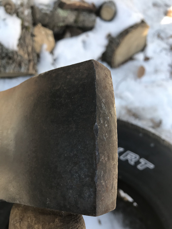

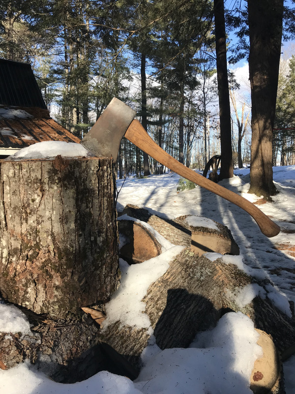

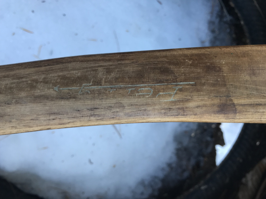

3.5 plumb Connecticut, 26.5 inch handle. Handle says “Perry” in gold letters. Anyone know anything about this handle maker?
So I have been searching the web trying to date date the plumb USA stamp and I think it may be form the 1920s. The 2 advertisements below are from 1922 and 1923. I only saw plumb USA stamp used in ads between 1921-1926.
Anyone know of any info on this version of the plumb stamp?
