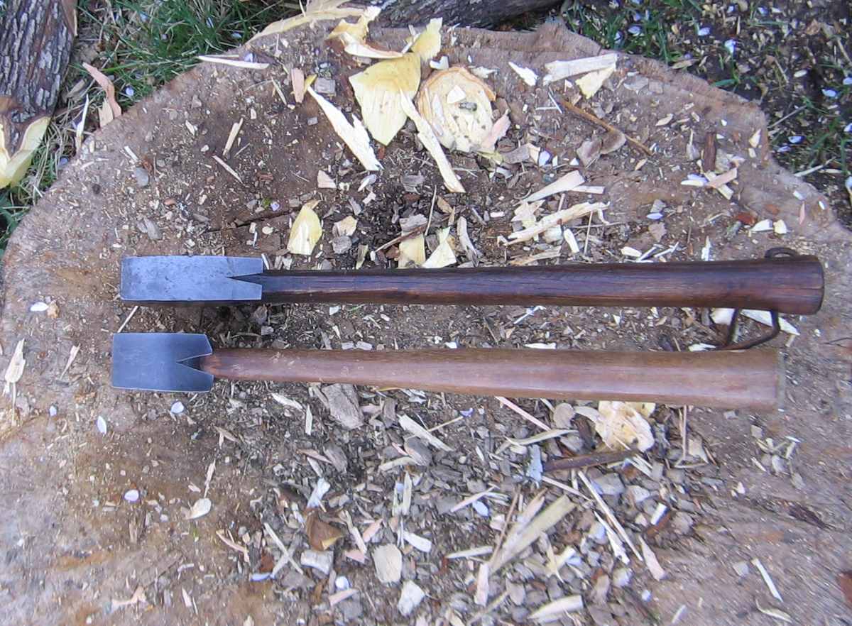

I finally got that claw hatchet sharpened and re-hung on the existing handle. I haven't taken it camping yet but I messed around in the back yard.
Here's how it fared at various tasks.
Chopping - It's only a so-so chopper. The straight bit and relatively flat cheeks aren't advantageous for chopping but I knew that going in. The other thing it has going against it is a short handle - only 13-3/4" long. I think this is a 1-3/4 pound head and it would be better hung on a 16" to 18" handle
Carving - It's quite good at this. This is what I had in mind when I shaped the edge. It came with a blunt ~45° bevel on it and it favored one side almost like a broad hatchet. I re-centered the edge and gave it about a 28° bevel.
Splitting - It kind of surprised me here, splitting much better than I anticipated. I think the weight of the thing is a big factor here. With a little longer handle it would actually be a great kindling splitter. As is I'd rate it as good.
Hammering - It feels almost like a framing hammer in my hand. Works very well at this task and I suppose that's to be expected since it was marketed as a carpentry tool originally. Here again it would benefit from a longer handle.
Nail pulling - It's very good at this which was what I was hoping for when I bought this to replace my Tommy Axe. The short hammer face creates good leverage for pulling nails - unlike the Tommy Axe with it's longer poll face. I was impressed with how easily it pulled 16 penny sinkers.
Overall I think I'll be slightly happier with this than the Tommy Axe as my camp hatchet. And once I find a longer handle for it I think I'll really have no complaints.

What do you mean with the flat cheeks making it no good for chopping?
Flat cheeks tend to stick more than convexed cheeks (sometimes called a high centerline). Also convexed cheeks throw out chips better than flat cheeks.
As I stated in the original post a think a 16" to 18" handle would do better on this hatchet. It's a little clunky at 13-3/4". I will look for a riggers hatchet handle next time I'm at the hardware store.

Here's another comparison photo.
One further update on this claw hatchet. I rehung it on an 18" riggers axe handle. It feels and handles much better now and it chops better, too. It was just a little too clunky on that short handle.
