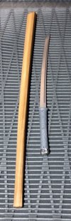

Doing some more research on saya construction and apparently you have to be careful on what glue is used to prevent rusting on the blade. Seems like Titebond I is good, but not II or III.
Even then, it sounds like it may not be great for long term storage.
Doing some more research on says construction and apparently you have to be careful on what glue is used to prevent rusting on the blade. Seems like Titebond I is good, but not II or III.
Very true, adhesives can have acids in them, especially the higher tech ones that “stick to anything”. The acid etches the surface to increase adhesion.
I’ve never experienced it but Nathan has reported seeing blue painters tape causing corrosion on blades.
As far as long term storage, ANY sheath can have issues for long term storage, even knife pouches for that matter. The problem isn’t with the sheath, it’s with temperature changes and humidity. If you have fluctuations in either condensation develops and gets trapped longer than it would in open air, potentially causing corrosion.
If you add a caustic chemical to the mix whether it be glue, salt or inappropriate leather (chrome tanned, Latigo etc) it just compounds matters.

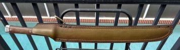

Steampunk Pirate Scabbards
This one will need a little background, I know it's not for everyone. I have wanted to make a wood leather hybrid for a long time, it is inspired by a Japanese company (Kanetsune) who makes traditional forged sporting knives and uses a similar design for the sheaths.
In practice, mine ended up more Steampunk Pirate! I started with 1/4" Poplar that was then lined with veg tanned leather and an English Bridle welt. The fasteners are the same solid brass knife handle rivets that have been in use for over 100 years. Where screws were needed I used Threaded aluminum barrels and solid brass screws. These things are damn near bullet proof and at no point does anything other than leather touch your blade.
The wood was stained honey brown with multiple coats of hand rubbed poly on the flats. Then the whole scabbard hand multiple hand rubbed coats of butchers block sealing was applied and hand buffed. The edges were burnished through to give it a warm aged look. These have a wonderful soft waxy feel, like grandma's old furniture.
All of the leather fittings are 6 ounce English Bridle most of which are laminated to football leather that is extremely strong and thin. These were all edge dyed and polished then soaked in my normal final finish, but also hand rubbed with the same wax as the wood to add a little antiqued warmth and softness.
The integrated brass carry hooks can be put on a belt or shoulder strap quickly and removed just as fast. The scabbard itself was built with a generous fit and the heavy bridle strap has double snaps for great security and to keep the sword from moving around.
All visible fasteners are solid brass, no plating.
Please note, these will not fit the Shiv Sacks below. I did not have time to make wider ones, but will offer to make one at a later date for anyone who wants one and ship it for free.
