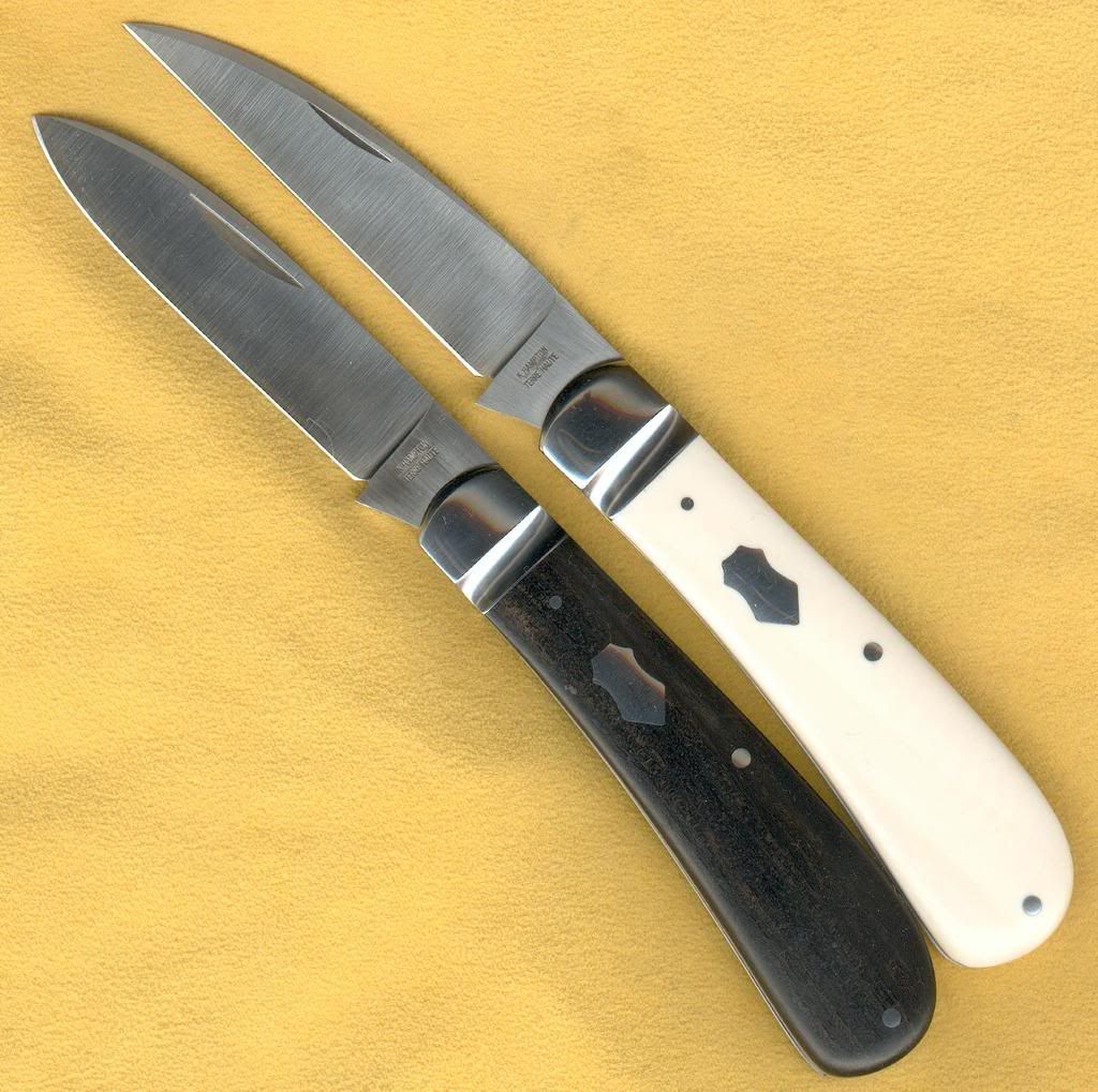

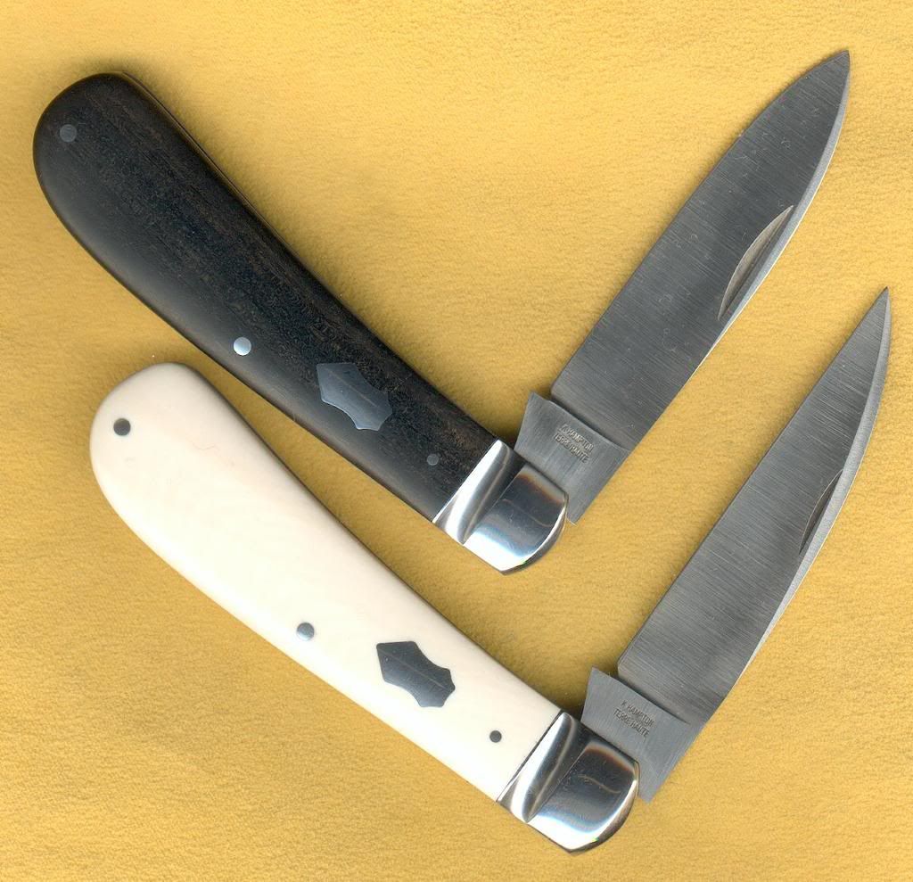

I can't match Kerry's photography, but I've been comparing the two knives in this pair, and thought I could share that with you, in my own scruffy style.
All scratches, orts and other mung are the fault of poor scanner maintenance, and no reflection on the Knifemaker!
I've scanned them side by side, to show the subtleties of difference, in what are similar patterns. Getting the geometry right on a given folder is a fine art. So many thing happen when you open and close the blades. Three different positions have to result in flush backsprings; open, half-stop, and closed. The pivot and kick have to work together as well, so the blade hides closed nicely, but remains accessible. Fitting a Wharncliffe which curves opposite of these trapper handles when closed requires everything to be just so.
And the Zulu, a modified Wharncliffe is nearly as tricky.
Can you see the slight differences?
Then there's the walk and talk. Subtle difference in the walk to half stop, vs. the walk to open is the key to approaching a perfect knife. (Will there ever be such a thing?) These are very nice indeed; easier to open to the first or half-stop stage, then a little harder for the second - full open, when you have more access and more leverage, and want it to stay in position to use it. I first noticed the difference on the Old Dog's knives. Grasshopper has been paying attention!!
I am so pleased with these knives. Nice going Kerry! Thank You!
You're very welcome, Charlie. Dang...lookin at my knives on a scanner image is kinda scary. :eek:
Scanner images are not flattering! All warts are revealed; I think your knives do very well, Kerry!
